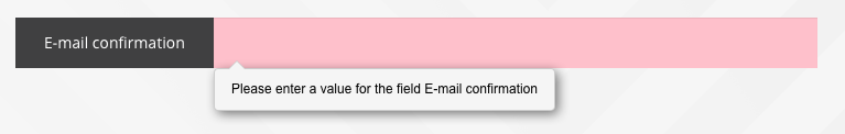

10 years 11 months ago #210724
nicolas wrote: Hi,
This is done in the hikashopCheckField function in the file media/com_hikashop/js/hikashop.js with the line:
alert(hikashopFieldsJs['validFieldsComp'][type][i]);
Awesome Nicolas!
That works like a charm... check my screenshot...
however i'm wondering for some reason it check's the form from bottom to top so when you leave the form blank the first error is always the last one instead of being the first error from top to bottom...
is there a way to revert this order?
cheers,
dan
  • Posts: 26378
10 years 11 months ago #210759
Nice !
For the checking order ; it's done by that line
for(var i = hikashopFieldsJs['reqFieldsComp'][type].length - 1; i >= 0; i--) {
You can replace it by
for(var i = 0; i < hikashopFieldsJs['reqFieldsComp'][type].length; i++) {
And I think that we will also replace it in our side.
The following user(s) said Thank You: clet
  • Posts: 11
10 years 11 months ago #210848
Thanks Jerome,
Works prefect!
