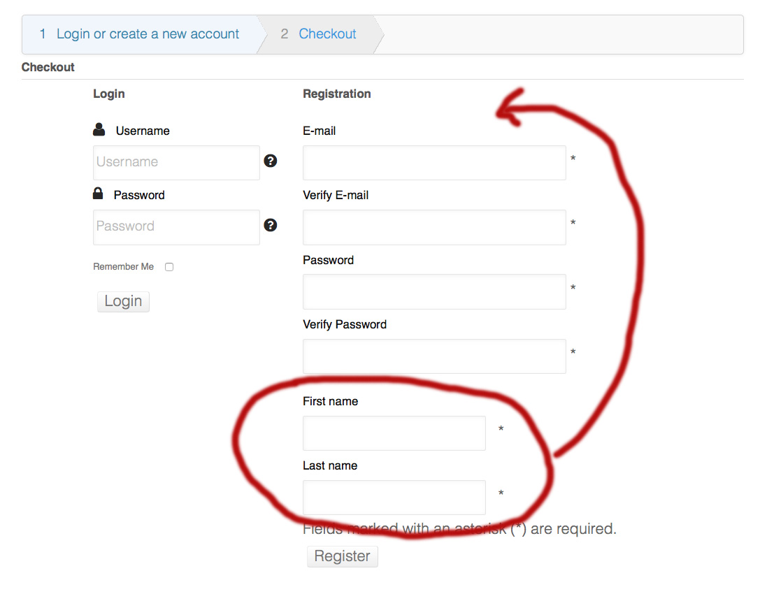

i'd like to have my custom fields come before the registration form fields on the checkout page
right now i have the simplified option set up with just email and password. my custom fields are first name and last name which i'd like come before the email and password fields.
i've tried editing the following with no luck and broken forms
Display > User > registration
Display > User > registration_bootstrap
Display > User > form
Can anyone point me in the right direction?

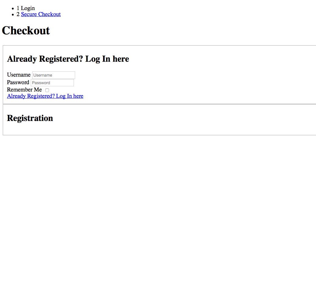

10 years 11 months ago #211558
Thanks for the quick response nicolas.
I've tried moving the code you mentioned above line 22 which is - if(!$this->simplified_registration){ ?>
but it breaks the form. see below
starting at line 112 I removed the code below
	<?php
	if($this->config->get('address_on_registration',1)){
	<div class=""><legend><?php echo JText::_( 'ADDRESS_INFORMATION' ); ?></legend></div>
<?php
	$this->type = 'address';
	echo $this->loadTemplate();
here's the first 25 lines from the registration_bootstrap that i have now

  • Posts: 26378
10 years 11 months ago #211562
Please check your PHP error log ; you should have a PHP syntax error.

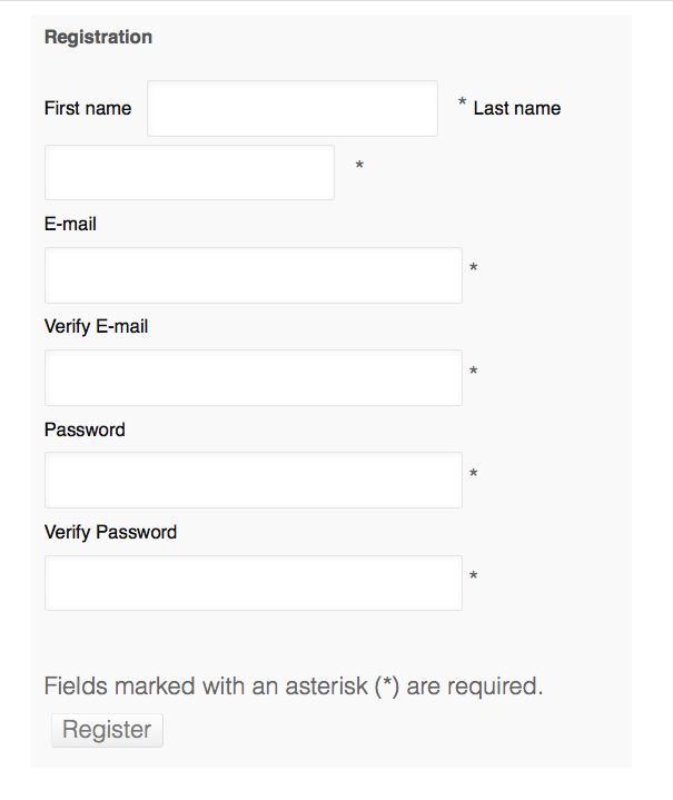

  • Posts: 11
10 years 11 months ago #211735
thanks nicolas! the first time i edited the file i thought i did exactly as you said but the form was broken. I tried a couple of things after that to try and get it to work . i must have messed up removing the code below:
The custom fields now load first but now without the same format as before. the fields seem to be all on one wrapped line

10 years 11 months ago #211747
It can probably be fixed with some CSS code, but I'm not able to access your checkout and I couldn't find any product page to add a product to the cart in order to access the checkout, so I couldn't analyse the CSS on the form.
Could you provide the necessary information to access that form on your website ?

10 years 11 months ago #211873
You can add such CSS on your website:
.hikashop_checkout_login_right_part label{ display:block; }
The following user(s) said Thank You: mlevin@cfisa.org
  • Posts: 11
10 years 11 months ago #211975
Thanks Nicolas! that did the trick
