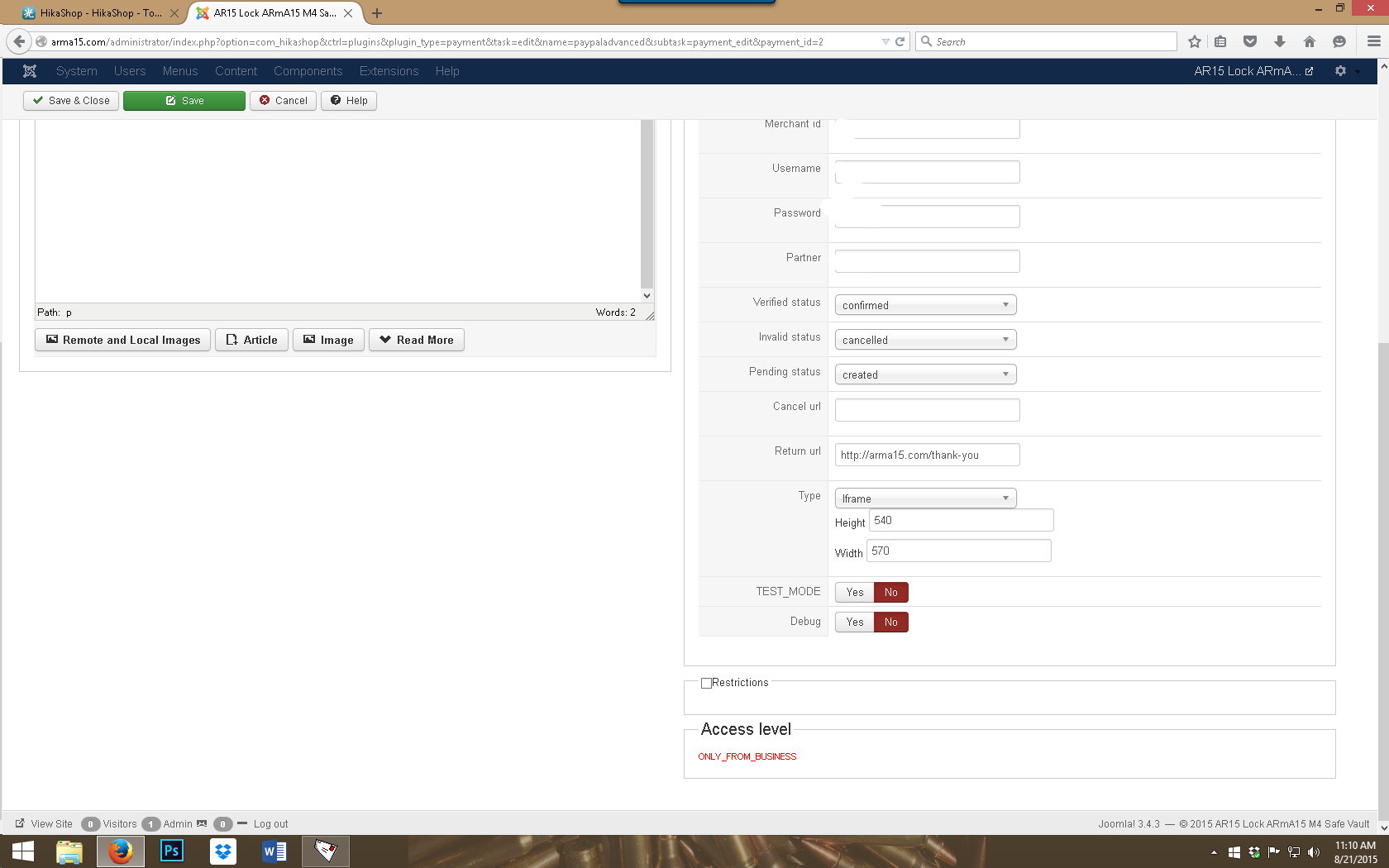

What exactly do you have entered in the redirect link field?
Please post the exact string, or a screenshot.
  • Posts: 92
10 years 11 months ago #212177
See attached

This looks like an issue that we fixed a month ago which will be in the next release of HikaShop:
www.hikashop.com/forum/payment-methods/8...advanced.html#208019

2. There is no after end message after they checkout. They do not get directed properly to the thank you message which is at the link i provided above, the screen shot also shows at the settings are correct.
