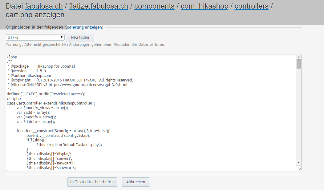

  • Posts: 62
10 years 10 months ago #214662
I was looking at this file first. But there is no such function. Really, see attached file.
