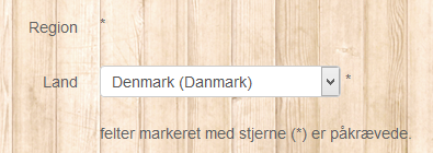

I would like to have the region and country all gone in the checkout process. I have disable all countries and regions, except Denmark. But I also want that gone to the textbox and dropdown in the checkout,because there are only customers from Denmark on the site ( see attached image).

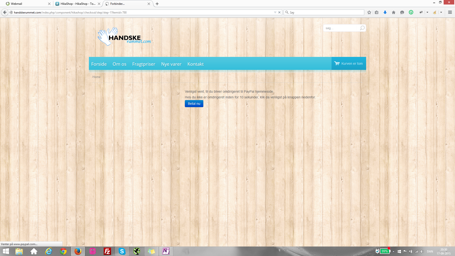

Also when the customers gets send to paypal sometimes it takes the customer to there main site and not the paying page. Also when you click the pay now button it sometimes takes you to the main site of paypal. Why does it do that?

1. No need to remove the zones. What you want to do is disable these fields via the menu Display>custom fields.
2. The checkout can be adapted with the settings of the Checkout tab of the HikaShop configuration.
It seems that you turned off the "auto select payment and shipping methods" and "auto submit payment and shipping method selection" setting of the HikaShop configuration. I would recommend to activate that back. That will avoid the "double validation".
