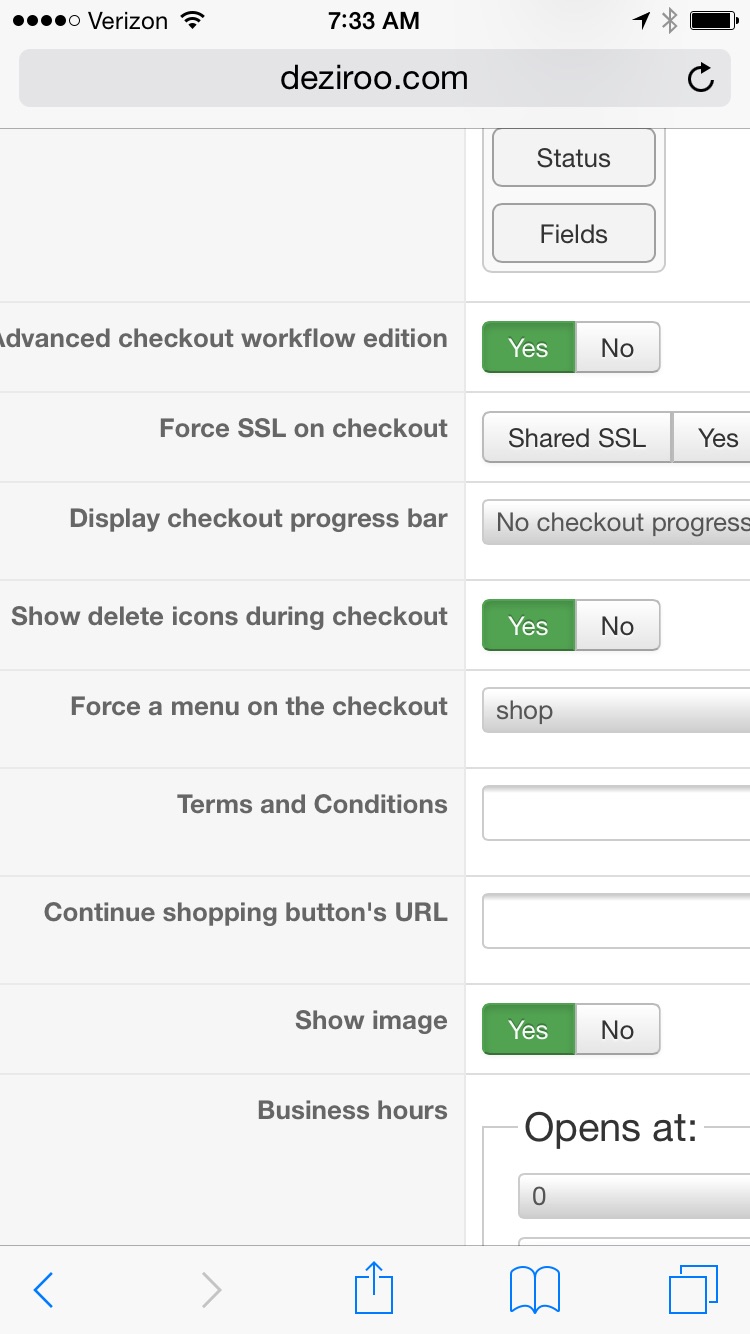

Originally I did not have a page selected, I have tried 2 different ones not and it is still not working. I attached pics of the error info and my settings page. I have it set to the shop right now and I know this is a working link.

I just tested it and your checkout workflow was ok, the only thing I couldn't test was the payment itself, but in your case your issue is probably coming from the way you have configured the "Return url" option of your Stripe payment plugin.
