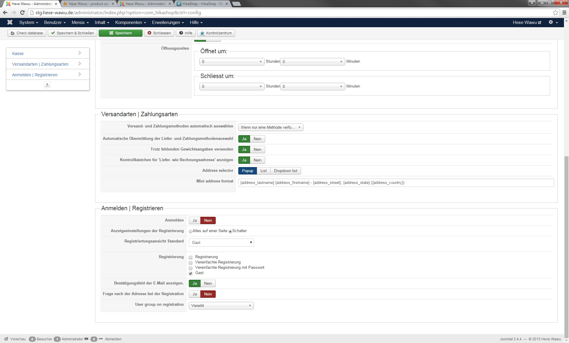

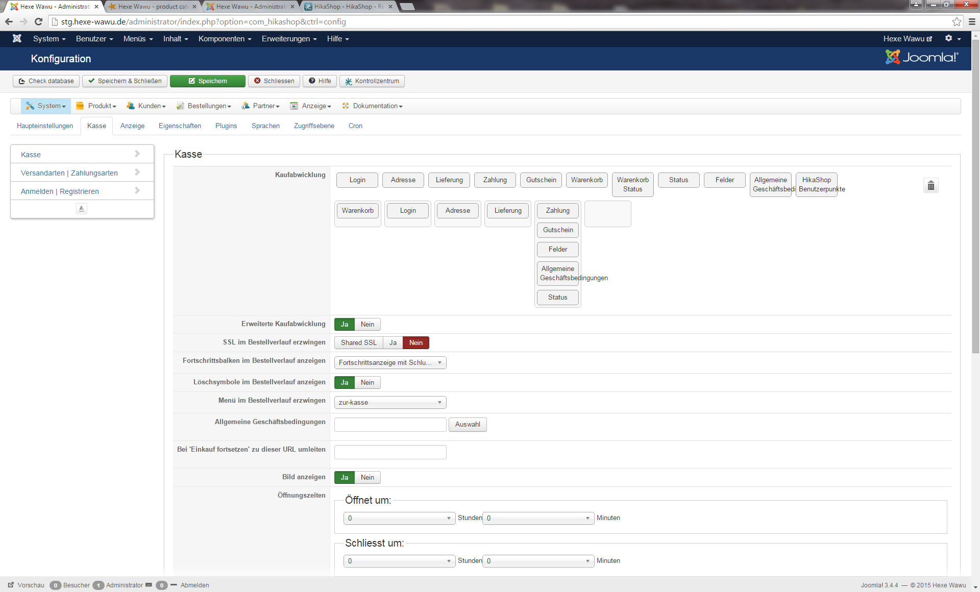

I would like to have a step by step checkout, not all in one page. So I choose the second option with the switch and set the regsitration option to guest.
You will find two screenshots of the configuration of my checkout in the attachment.

10 years 10 months ago #214865
I've just tried your checkout and it seems to be working just fine right now. I'm not sent to the login step when I change the cart, and if I delete the product from the cart, I'm going back to the products listing.
