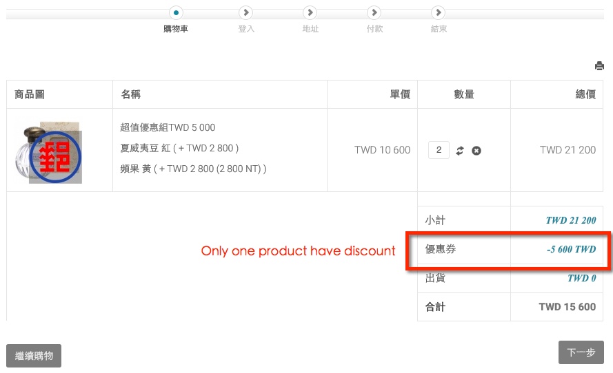

First,How to let A and B product name to show up on the cart? (you can see picture1)

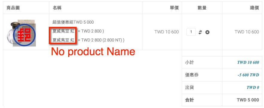

Second,How to let all C product have discount while the customer bought more than one?(you can see picture2)

10 years 11 months ago #215725

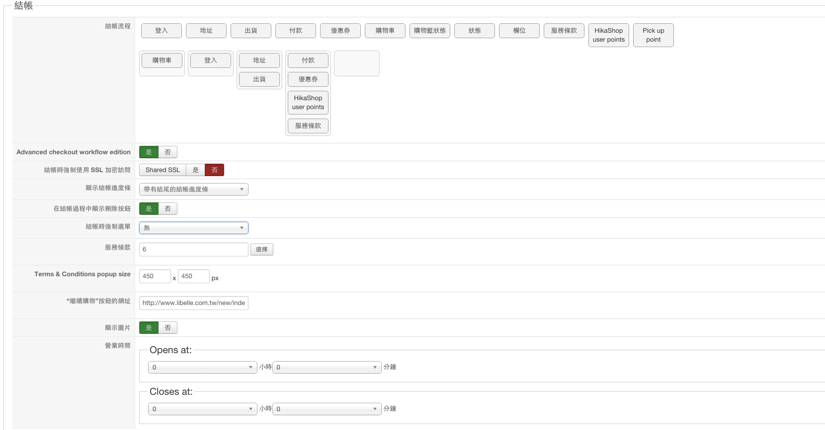

1. Changing the value of the "Group options with product" option via "Hikashop->System->Configuration->Checkout" will probably do the job.

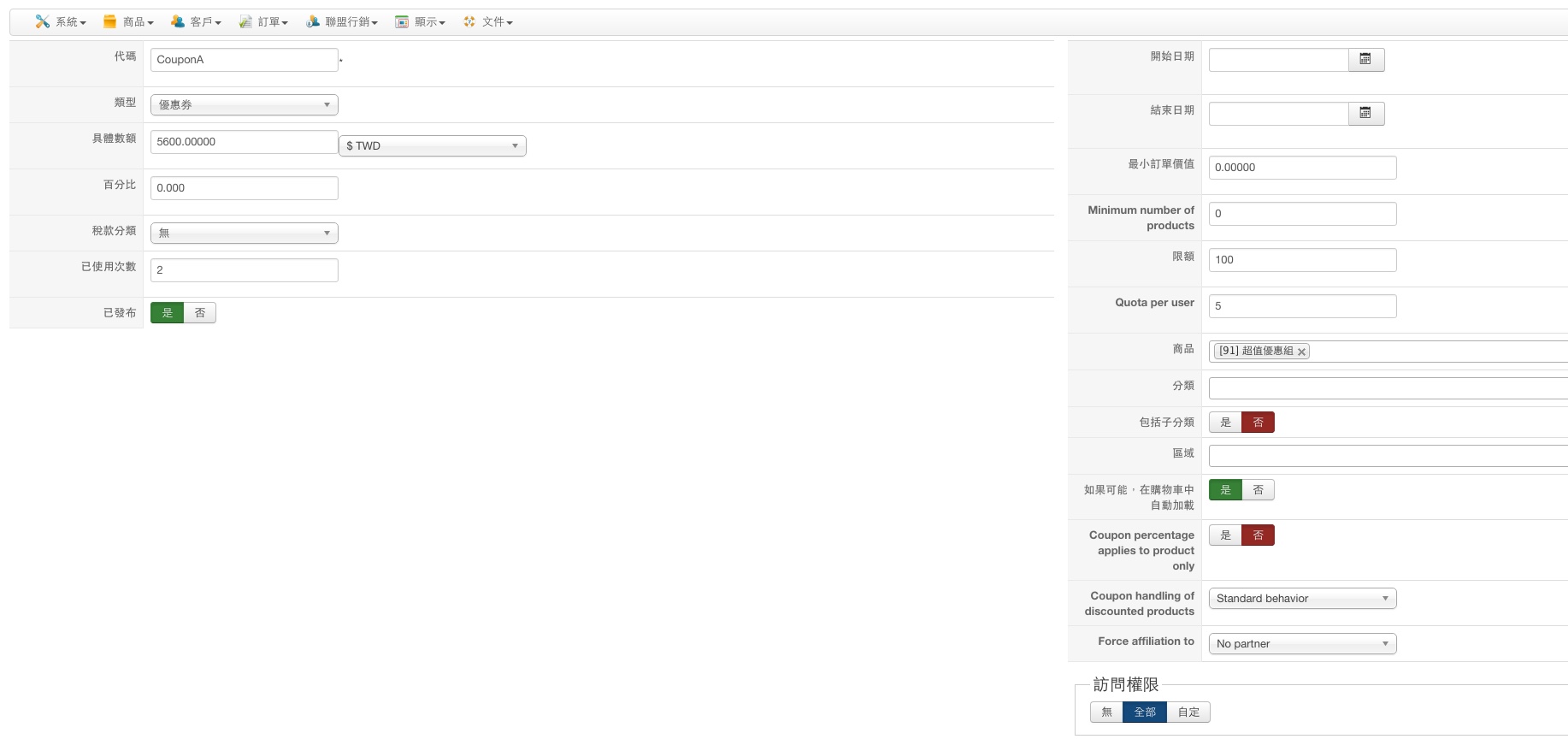

2. You can for example create a special discount for that product using the "Product" restriction option through your discount configuration page.

10 years 11 months ago #216697
1.I couldn't find the value of the "Group options with product", this is all I have.Please check the picture1
2.I was using the coupon to do the job, but it seems using 1 ticket a time. You can find my option in the picture2
  • Posts: 86212
  • Thank you received: 14221
10 years 11 months ago #216714
Please understand that we don't read Taiwanese. It would be better to provide screenshots in English.
1. The "Group options with product" setting is in the Cart section of the HikaShop configuration, not in the Checkout tab. Please search there.
2. Why not change the type of your coupon to "discount" as mohamed suggested ? That way, it would be for each product, and not once for the whole cart.
