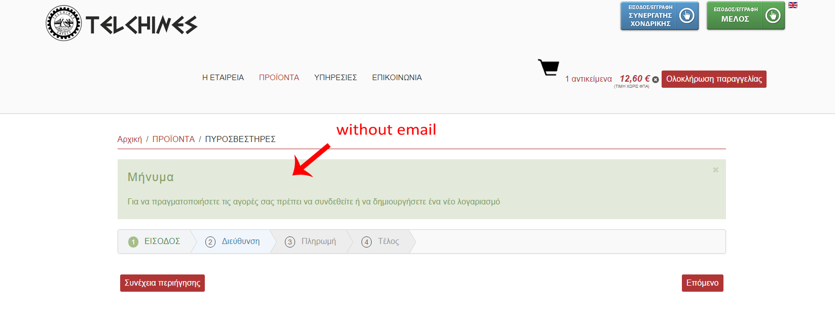

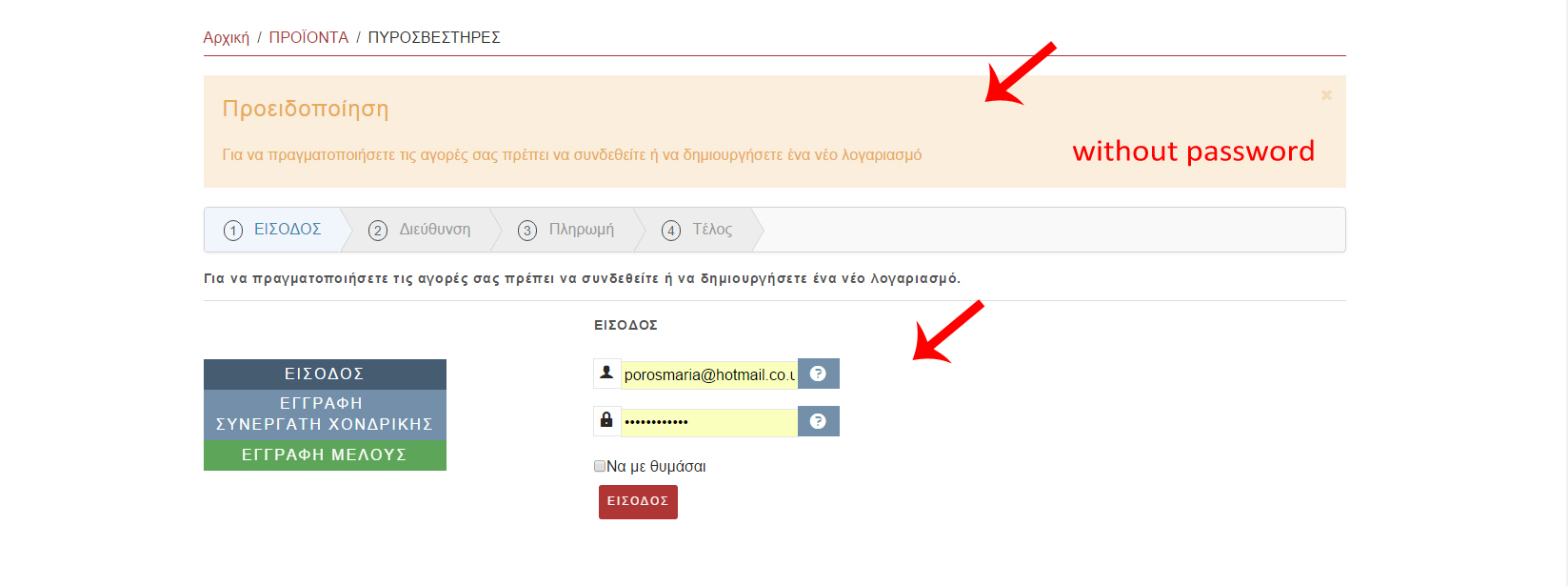

Hi Nicolas!
It did work, just one detail that needs to be fixed, the message is correct but it appears as a success message with green background and letters. Also when the message pops, it's not on the step 0 of the checkout progress, so as result i have to click the button "Επόμενο" to go back to login.
I m sending screenshots to see.
Thank you
  • Posts: 86112
  • Thank you received: 14210
10 years 10 months ago #218635
Then, add that code instead:
$app->enqueueMessage(JText::_('JGLOBAL_AUTH_EMPTY_PASS_NOT_ALLOWED'),'error');
return false;
