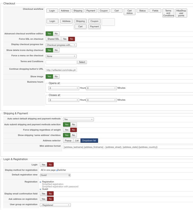

  • Posts: 32
10 years 10 months ago #219773
I was having the very same problem.
I am also using a GavickPro template (Meet Gavern)
I reinstalled Hikashop and that helped my problems for Guest Checkout.
This problem I have now may be another matter. I will show you the settings I have had during this process. I am also running in debug and I can see the message modules and am getting no reported errors.

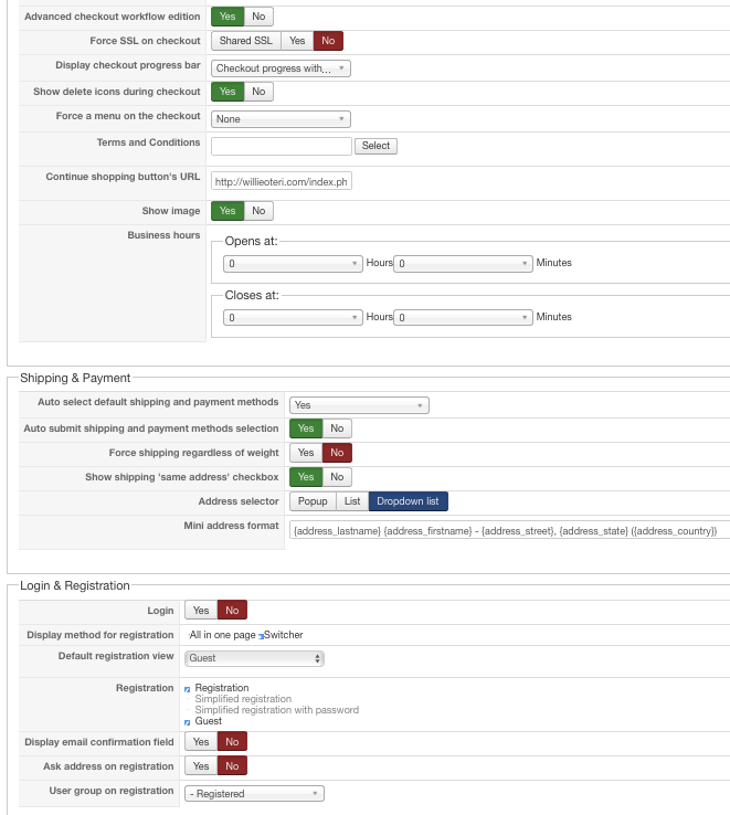

I am attaching my checkout process settings.

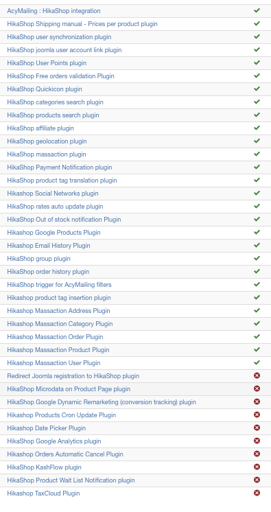

I am also attaching my Plugins settings because my problems began after disabling the "Redirect Joomla to Hikashop Registration" plugin. When I re-enabled the plugin, that did not fix the issues (so it probably wasn't related, but just in case.)

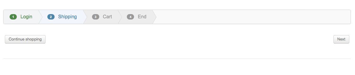

I am also attaching one example of the refresh/blank check-out screen problem that was FIXED by the reinstallation.
Note: after reinstalling Hikashop, my settings have not changed.
_________________
This is what I did next, and what is happening now:
after reinstalling hikashop, the registration worked.
"Simple Registration" Checkout Test:
problems with the registration: it interrupted the purchase
I was told to verify my email before I could complete my purchase
when I clicked on the link in the email to complete my order
it brought me back to the site
but it had emptied the cart
When I then try to log in
I get the message “Username in use”
"Guest" checkout test:
I am successfully taken to the next form in my checkout process
when I enter my address, the states are invisible in the drop down menu
(but I can still type in my state)
The next steps ALL work, and I am successfully redirected to PayPal.
and a surprising Login menu Pop Up problem:
When I click my Login module, located in my menu position, the popup appears for a moment, and drops / vanishes quickly after.
This began happening after my Hikashop troubleshooting...and I really don't understand how it can be related; so perhaps it will help solve what's really going on.
This is happening in both Safari and Firefox (the two browsers I am working in)
It's possible that this issue began before / unrelated to Hikashop and that I only just noticed because I was checking out / logging in through the Hikashop cart. It is the " K2 User " module. If you know this is unrelated please ignore it, I'll deal with it after I fix the shopping cart.

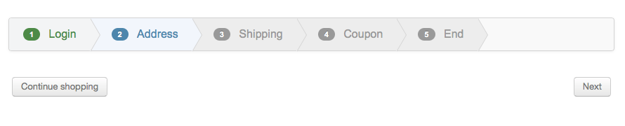

  • Posts: 32
10 years 10 months ago #219778
checkout problems continued:
The Groundhog Day shopping cart is back.

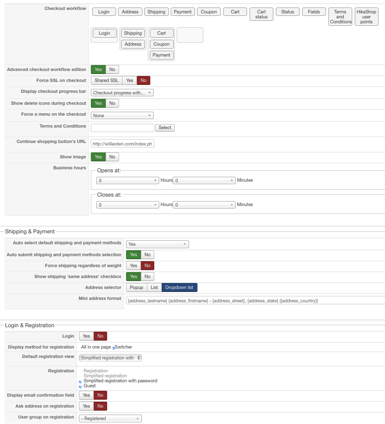

I am attaching my new shopping cart and Login/Registration settings behind the deja vu.
Initially, I had the Shipping Option dropped in above the address option on Step 2.
The error I received was, for a moment, “no shipping method found”
When I filled in my address information, and went to the next step, that error went away and it calculated the proper shipping.
checkout was otherwise successful.
I did not want users to see that error.
So adjusted my checkout configuration as follows:
I left the address in step 2, and moved the shipping to step 3.
(I would prefer we had the option to ONLY request a shipping address, and to only request a shipping address when the order actually requires shipping, so people buying downloads won’t have to bother with it.)
Now the refresh problem is occurring as follows:.
Step 2 is blank, and I cannot get from step 3 to step 4
Step 3 just keeps refreshing.
I have been searching for documentation on understanding exactly how the checkout settings need to be set for the various methods of checkout, and haven’t found it. I think my problems will be resolved if you direct me to information showing the various ways the cart can be configured and still work properly, along with exactly what the different Login/Registration settings really entail for the end user and what each of those settings requires from the shopping cart configuration (regarding address and shipping).
(but, I still adore your product and thank you for this forum!)
  • Posts: 32
10 years 10 months ago #219785

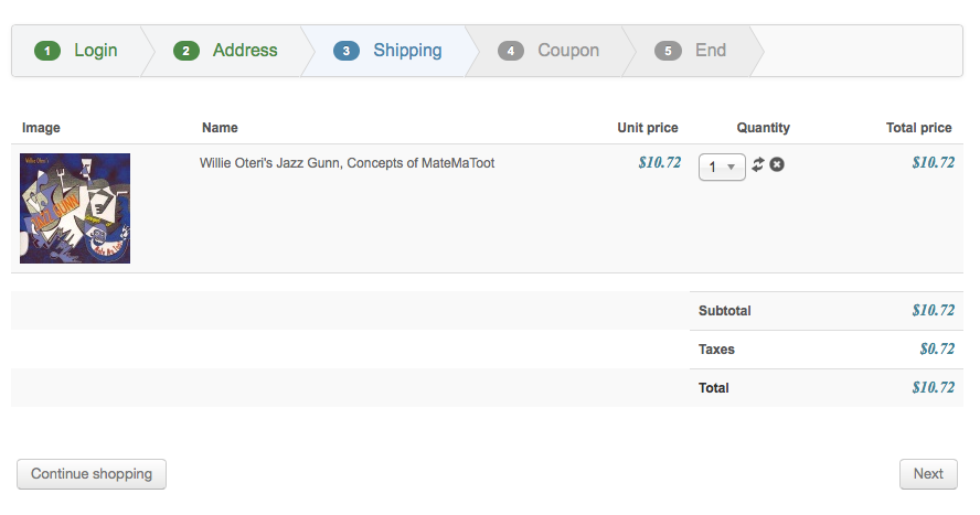

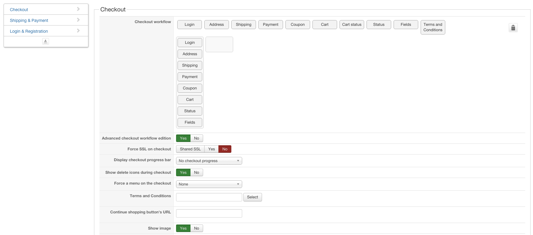

In an effort to solve my cart-refresh issue, I took my steps down to the 4 which seemed absolutely essential:
Login, Address, Shipping, and Payment.
I arranged them in every logical way I could think of, and each variation failed in one way or another.
Attached are all of my other checkout settings, which I left untouched as I re-arranged the checkout process.
For the settings attached, the possible checkout configurations ALL failed in one way or another.
I've attached screenshot .png files of each problem and its checkout configuration in the zip file attached.
