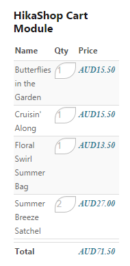

  • Posts: 50
10 years 10 months ago #219525
Lousyfool
Had a quick chat with my template designer (my sister) and changed position to left-menu and can now see cart at least. See attachment cart-view.
It is a start.
Thank you.
Now for payment options and getting Aust Post working :unsure:
