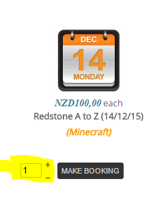

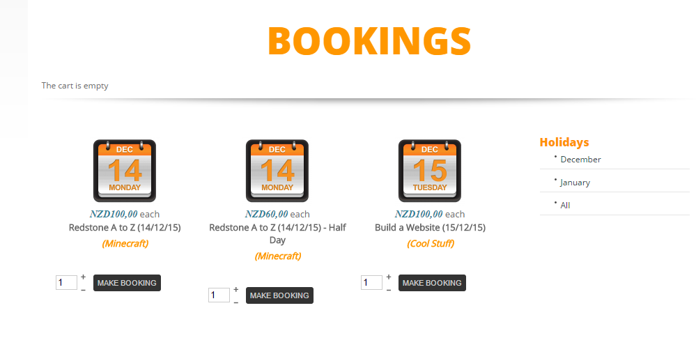

My products are suddenly showing the +/- next to the add to cart. This should not be the case. Where can I go to remove it again (can't remember how I did it before).
See the yellow highlight in the image.

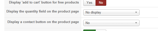

The + and - show because you have it configured this way.
Look for the option "Display the quantity field on the product page" in the main configuration:
www.hikashop.com/support/support/documen...ig.html#main_product
And check for any overrides for this setting per product: www.hikashop.com/support/documentation/i...terface.html#display

Hi, I have done all this
Configuration->Product
Product Setting:
And it is still there:

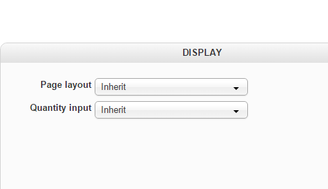

Please check the settings of the menu with the id "155", the option "Quantity field" is potentially enabled.
The following user(s) said Thank You: abasel
  • Posts: 139
10 years 10 months ago #220109
Thanks, I changed it from inherited to none and that sorted it our :)
