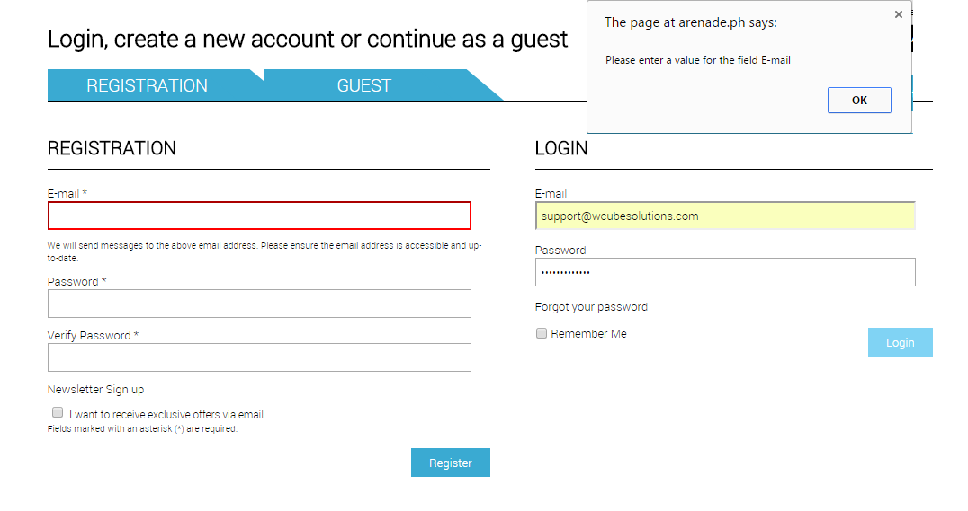

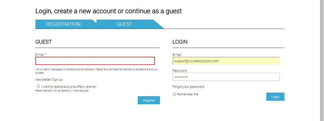

Good day! I am having problems with Login when checking out. My option is Switcher and I have 3 forms; Login, Registration and Guest. Whenever I add to my cart and I checkout and then I login, it doesnt proceed even if my credentials are correct. The E-mail field in Registration and Guest need to be filled up, but it should't work that way. Please help. Thanks!

  • Posts: 15
10 years 9 months ago #222037
Hello Jerome,

It seems that the page has been customized.
Please rename the folder templates/YOUR_TEMPLATE/html/com_hikashop/checkout to something else via FTP and try again.
That will deactivate all the view overrides on the checkout.
If it works then it really is a problem with the customization of the checkout and you'll have to check the problem with the person who did that customization.
Otherwise, please provide a link to the shop and a user account so that we can try to reproduce the problem.
  • Posts: 15
10 years 9 months ago #222147
This is solved now. Thank you!
