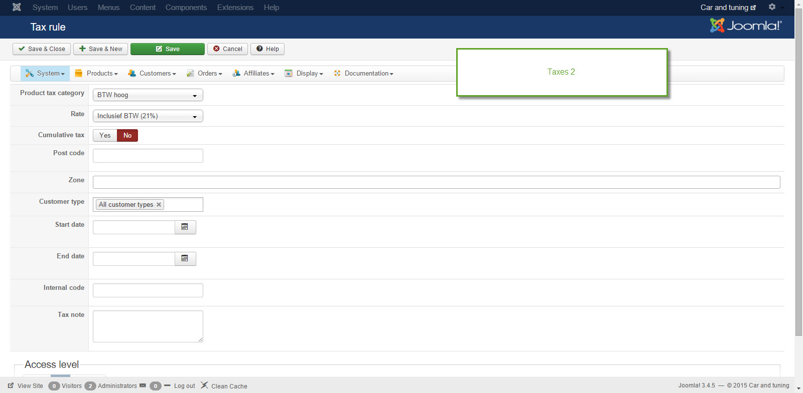

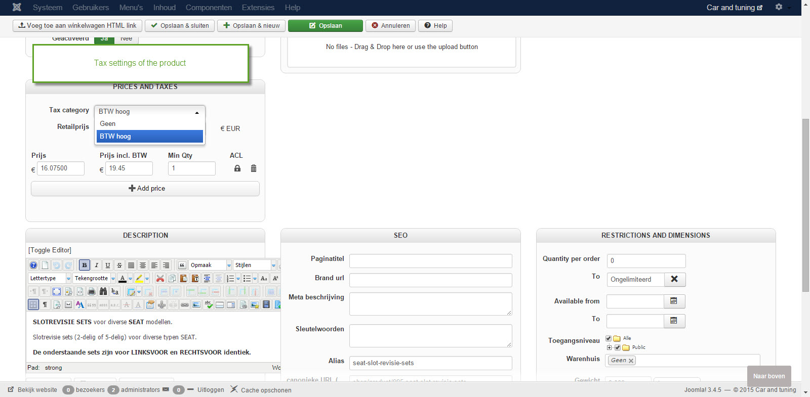

I doubt that the calculations on the taxes are off.

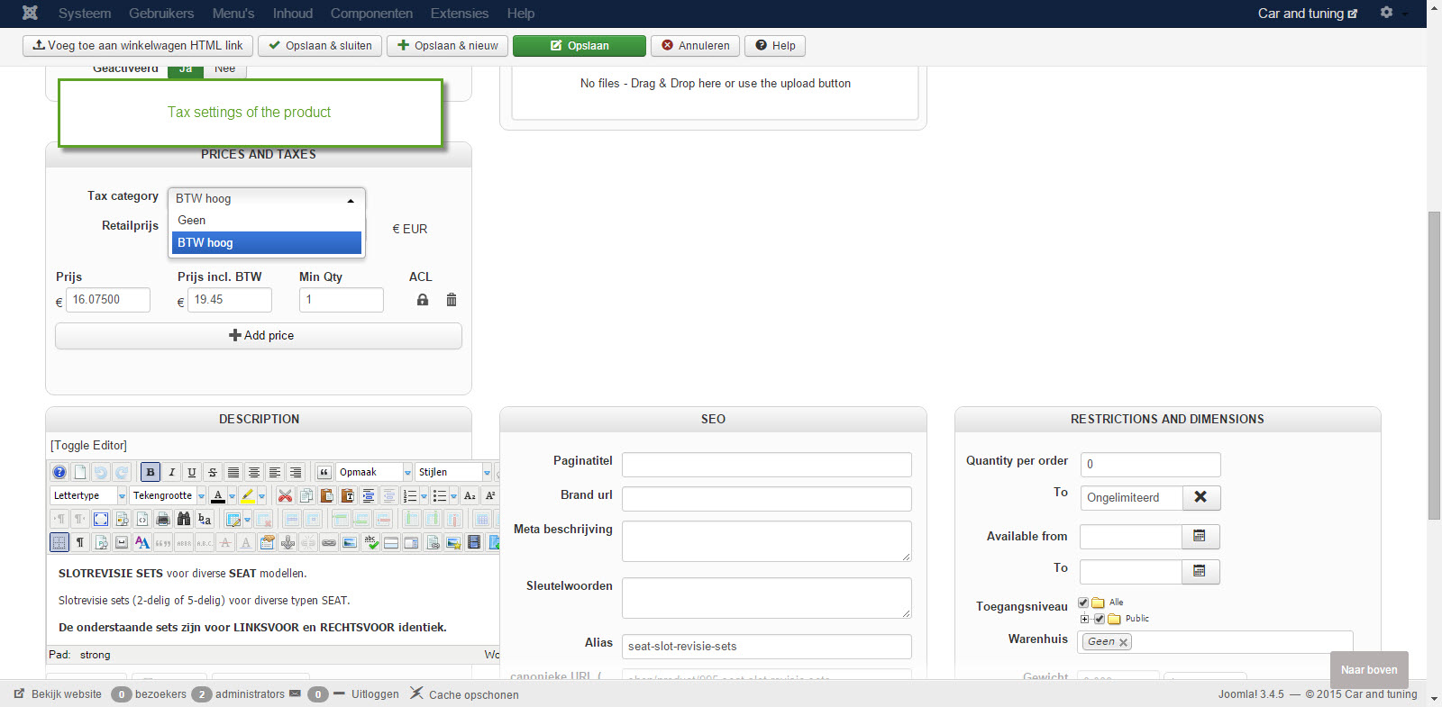

Please provide a screenshot of:
- the settings of that product

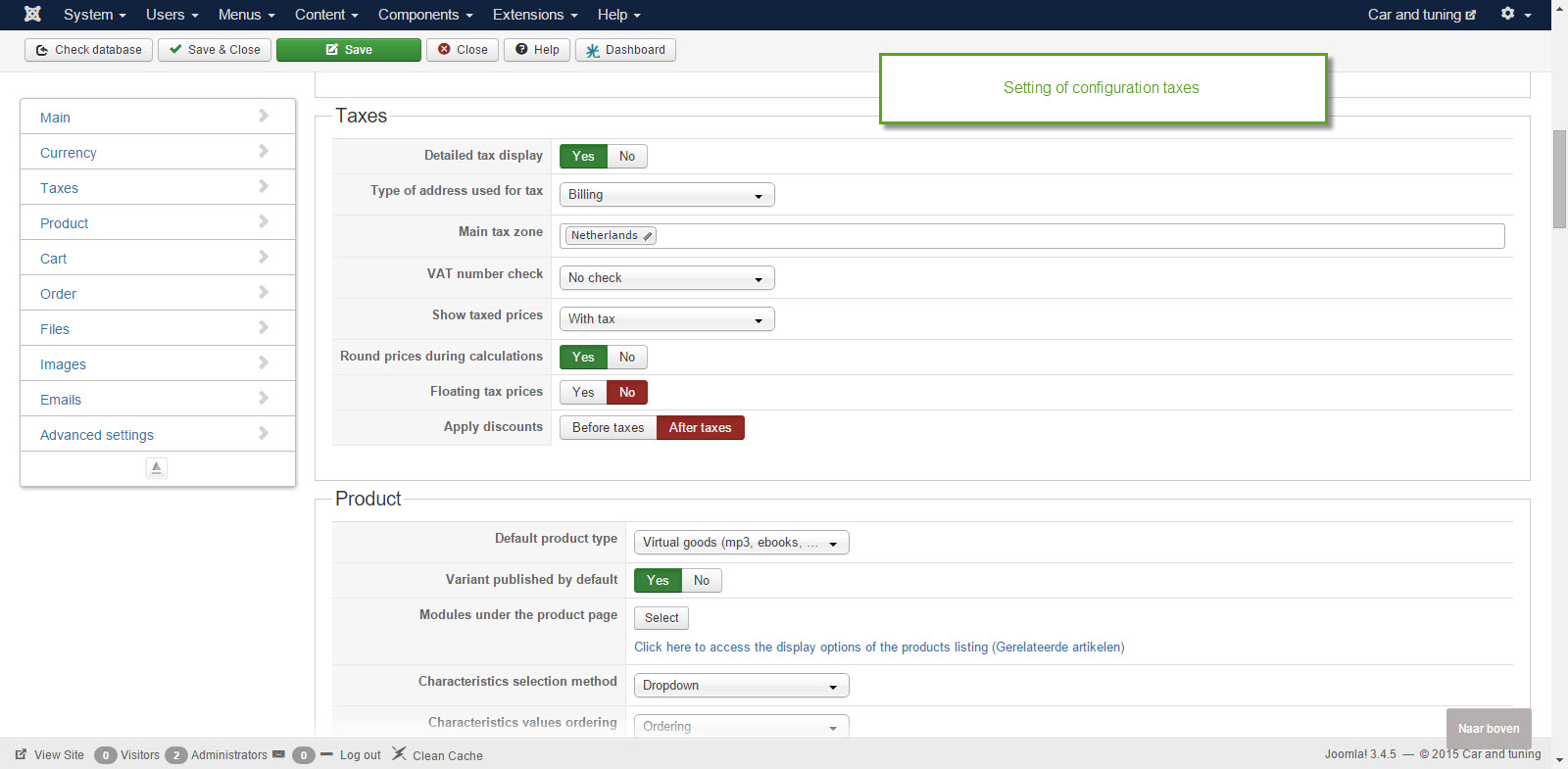

- the settings of the "Taxes" area of the HikaShop configuration

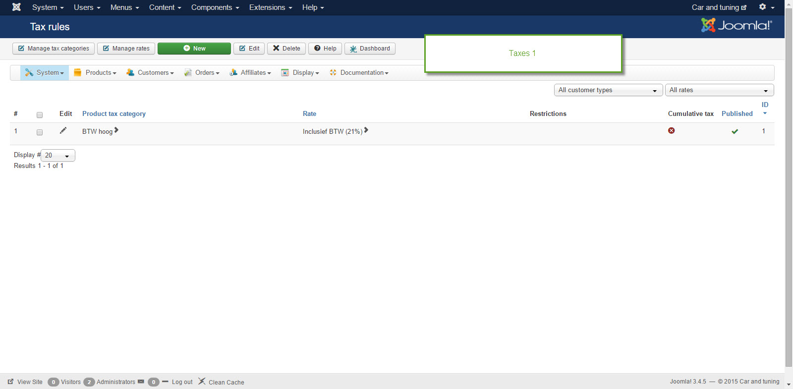

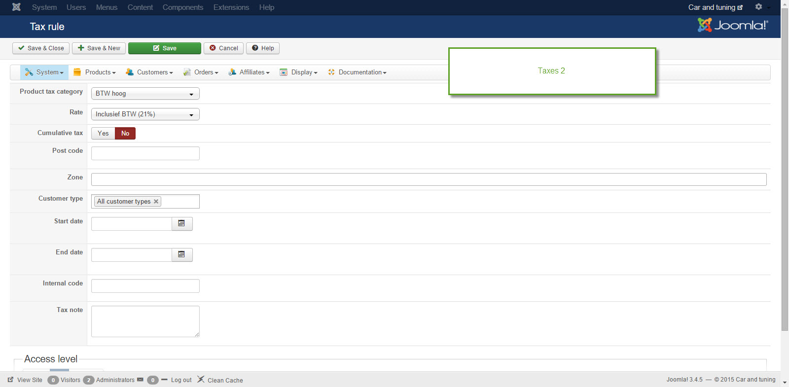

- the settings of your tax rule via the menu System>Taxes
so that we can analyze the situation.
  • Posts: 235
  • Thank you received: 4
10 years 9 months ago #222044
Attached the asked settings.
