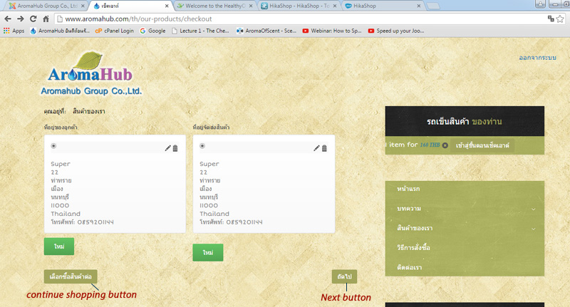

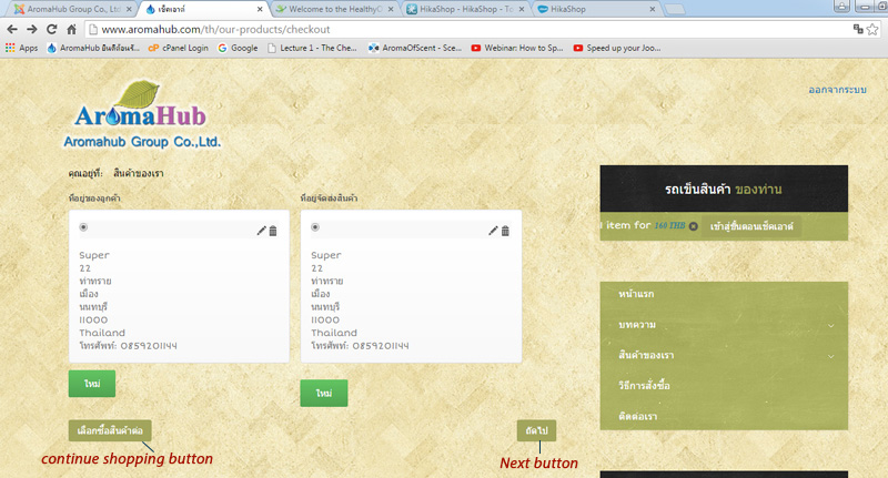

I have problem,please help. After filling out the address on the checkout page, when I click on the "'next" button,it bring me to the home page of the website. When I click on the continue shopping, it say "This webpage is not available". It had no problem in the past, just happened. I am not sure that I might did something wrong on the checkout process or something else such as language setting, etc. Please give me suggestion

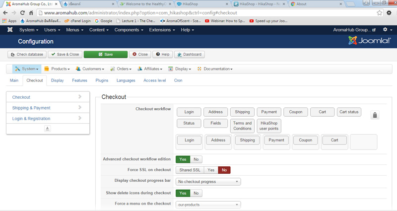

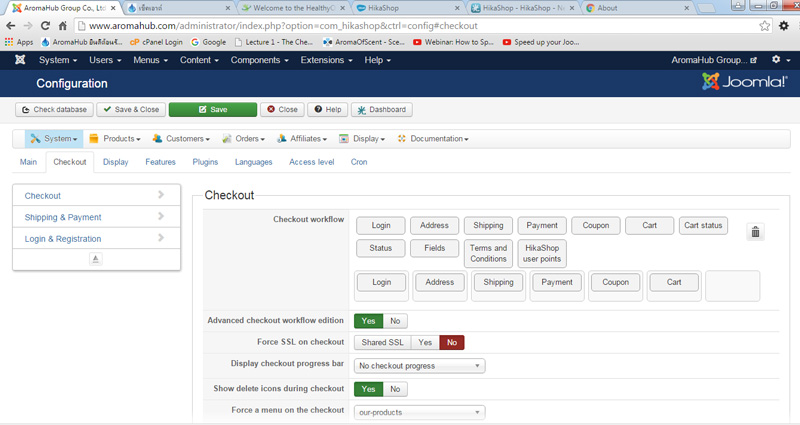

First I change in :
- Components -> HikaShop -> Configuration
- Click on Checkout tab
- I enter a new url, on your Continue shopping button's URL, before it's was a localhost url.
And so, the "continue shopping" button work now fine.

Finally, I found my problem. It has conflict with the "Shape5 Quick contact". When I disable it ,the "proceed" button works as normal.
Thank again for your help.Appreciate.
