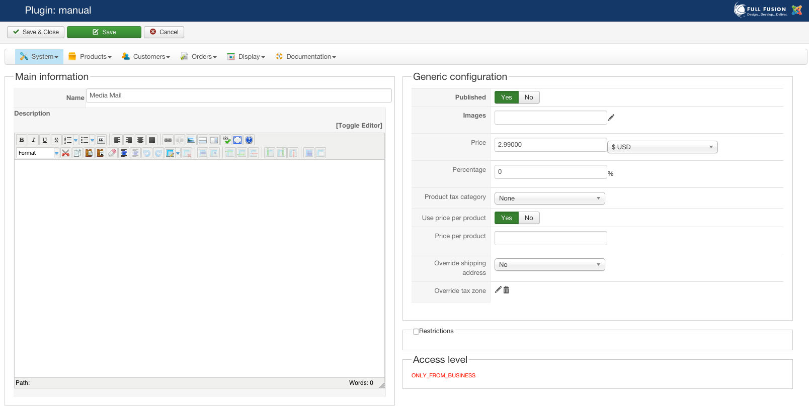

I have manual shipping set up with price per product selected. (See screenshot for configuration.) I can add products into the cart. Whatever step my shipping is in, I can't get passed than step. If I move the shipping info to different steps I can't get passed whatever step that is in. It just refreshes the page. Step 3 is where the shipping is currently. I've searched for any possible causes and dug through the configuration, but I can't figure out what is causing this. What can I do from here?

"I can't get passed" means I can't go beyond. I get to the step that the shipping method is on. The shipping method is there. I click the next button and the page just refreshes and doesn't go to the next step. That happens no matter where I put the shipping method in the workflow. There are no errors or warnings. My template does have the Joomla! message code so errors will show if there are any.
