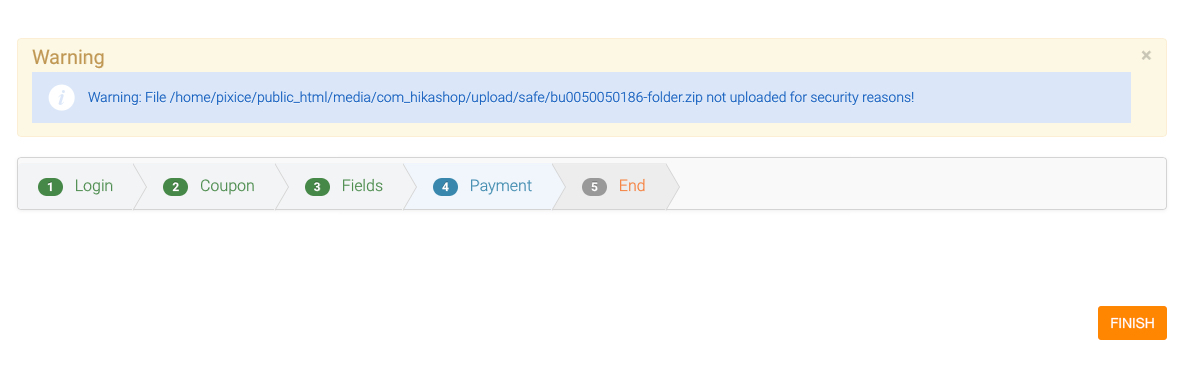

-- Error-message(debug-mod must be tuned on) -- : file not uploaded for security reasons
Hello guys;
In my website, in ordering (check out) process, customer has to upload a zip file. Some times after uploading this error is shown up (check the attached file) although in the server the file is uploaded. Also note that the file size that had been uploaded was not exceeded from permitted size. I cant understand what is the reason of this error.

There is no such translation in HikaShop.
So like that, I don't think that HikaShop is displaying that message.
PS : HikaShop 3.6.1 does not exist.
