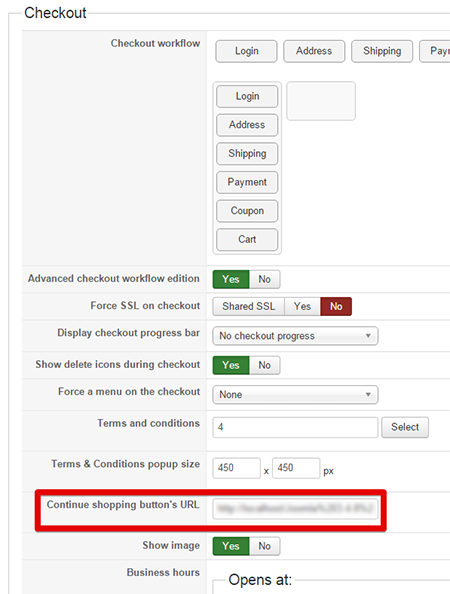

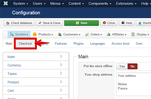

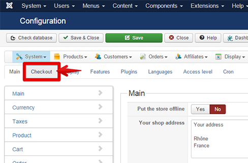

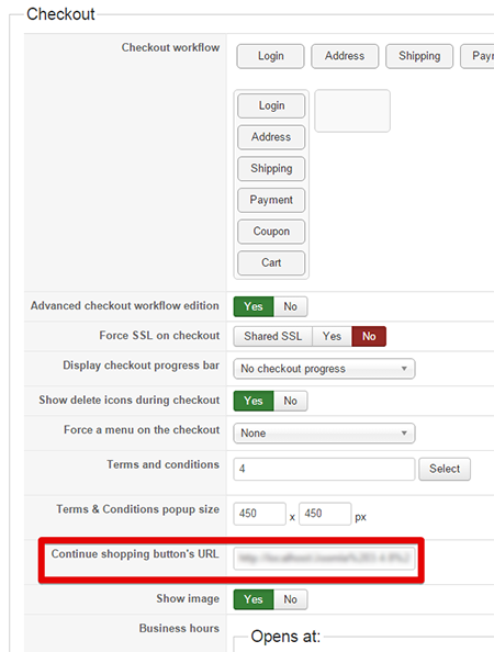

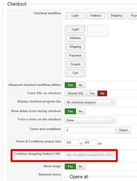

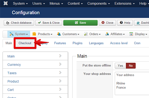

10 years 8 months ago #227305
For config the "continue shopping URL", follow this steps :
- Components => HikaShop => Configuration
- Click on Checkout Tab like image on below
- Find the "Continue shopping button's URL" input, and edit it.
Last edit: 10 years 8 months ago by Philip.
