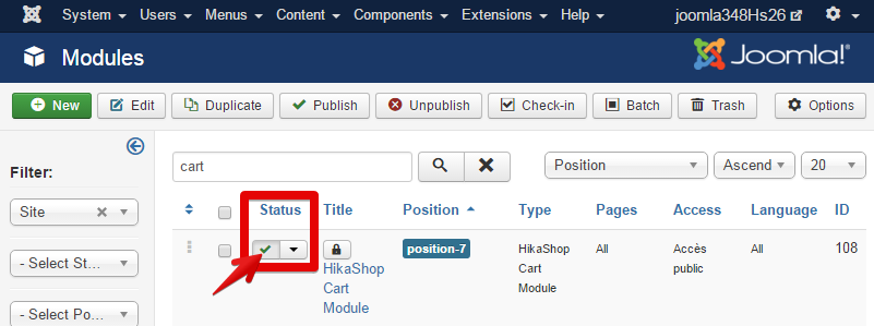

10 years 7 months ago #227623

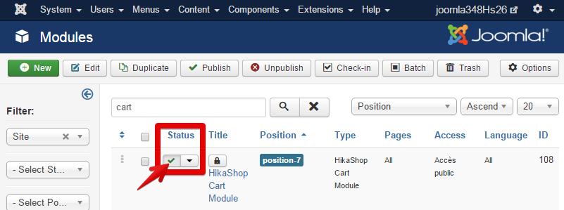

To display and configure your cart, follow this steps :
- Extensions => Modules
- Search for : "HikaShop Cart Module"
- Here you already published by clicking here like on image :
- To configure it, click on your module name.
- On the right side, you will be able to define the Position of your module
- And on "HikaShop Options" tab you will find different switch for published or not cart elements
Hope this will help.

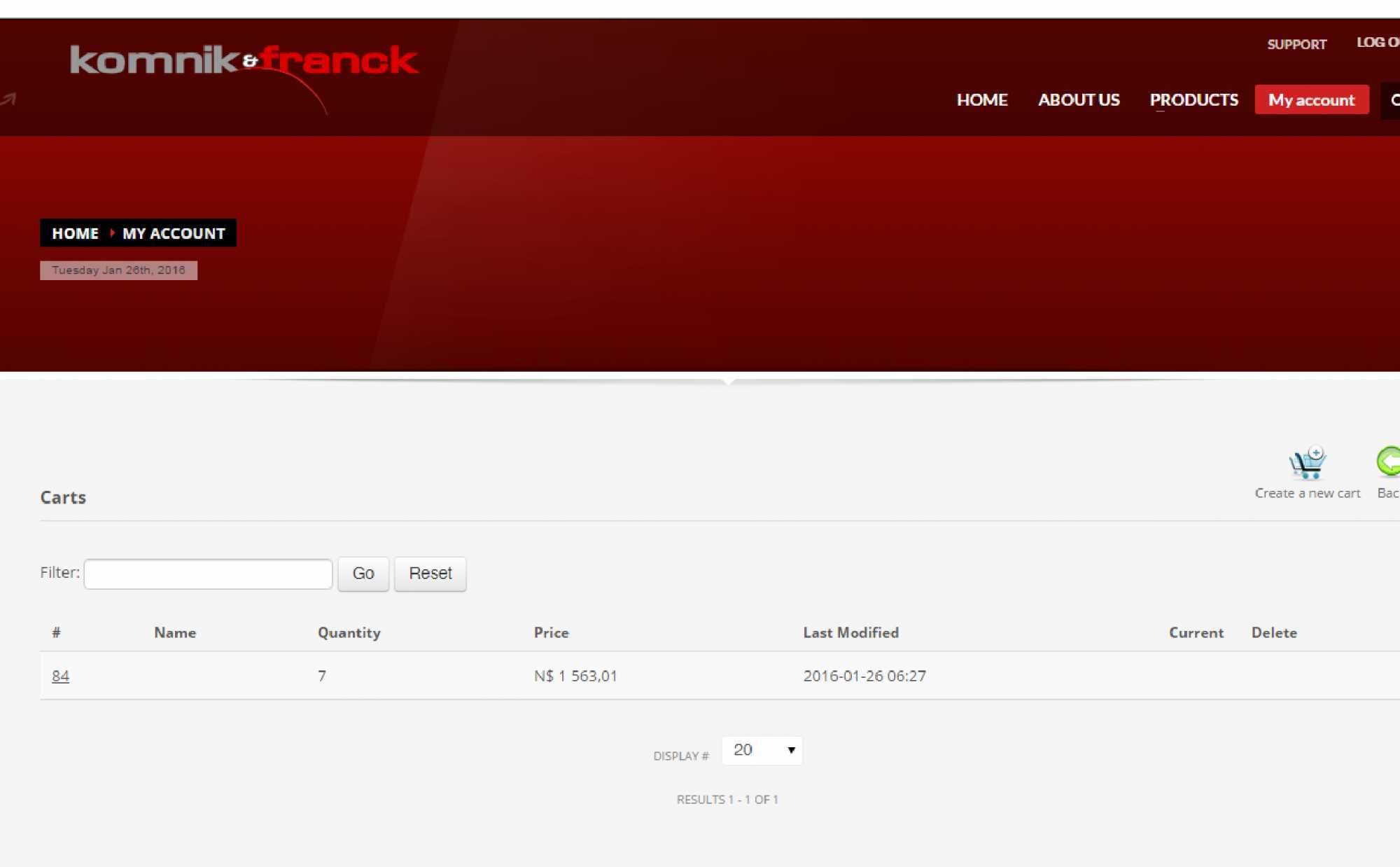

  • Posts: 78
10 years 7 months ago #227697
Hi, I made a screenshot of what I want to change. I do not find this in the module cart settings.
pasteboard.co/14Kv1MFX.jpg
Currently the 'Name' field is empty. Should show the product description.
I would like to remove 'Current' and 'Delete'
I want to rename '#' to 'Order #'

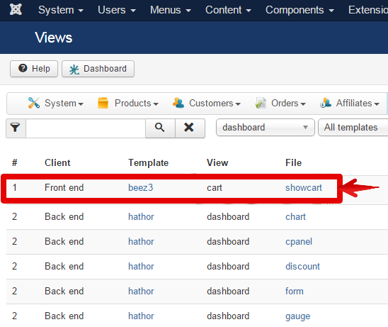

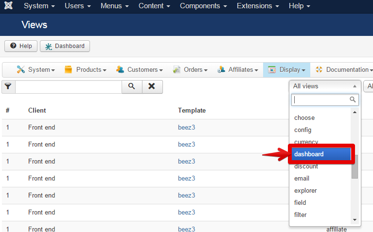

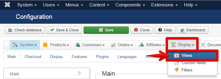

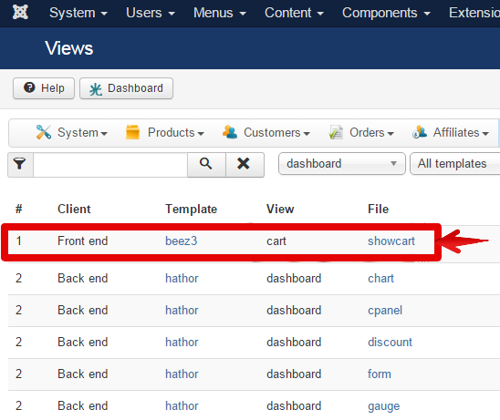

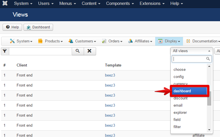

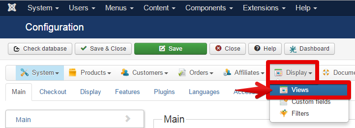

10 years 7 months ago #227746
Sorry I misunderstand your needs, for this you have to custom a view.
For this, reach the display view like this :
- Components => HikaShop => Configuration
- Then go on Display then Views
- Select to only display Dashboard views
- select the file showcart in view cart, by clicking on showcart
- You will now see the code to custom.
And so, you can remove elements or change some values
Last edit: 10 years 7 months ago by Philip.
