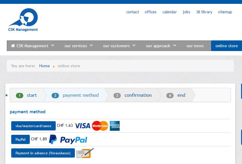

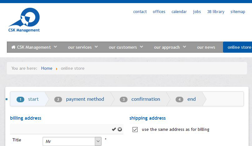

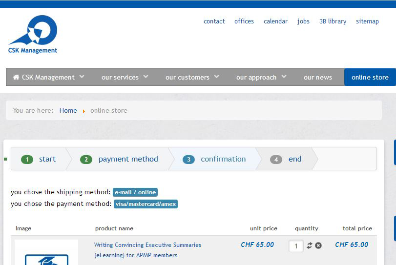

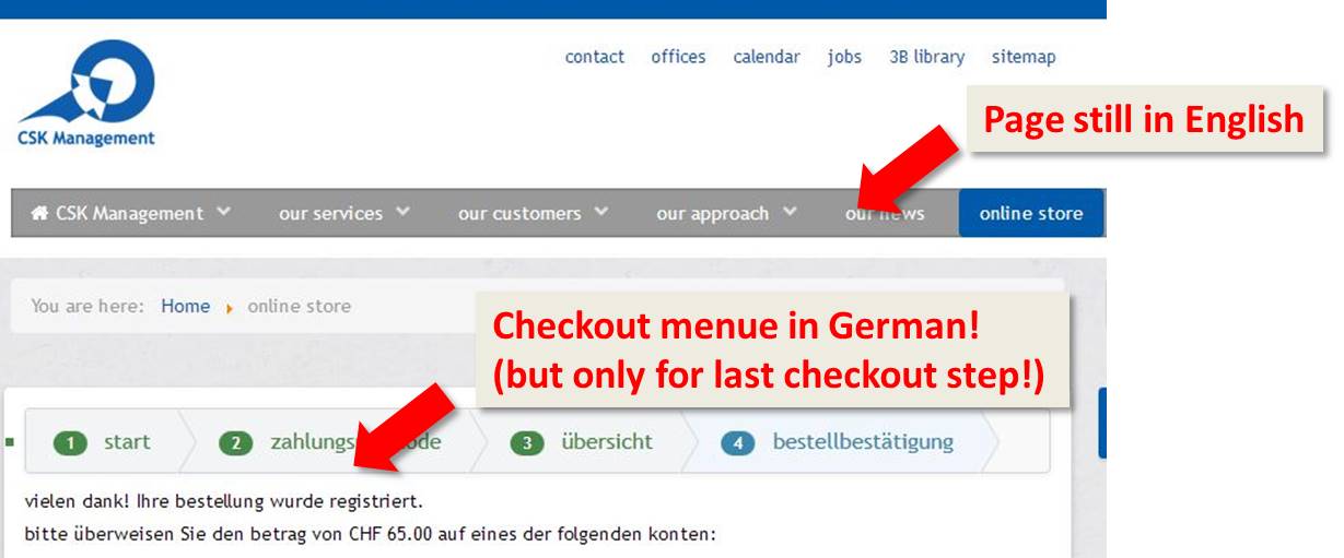

When someone goes through the checkout process on the English page, the last step is in German. The page itself stays in English. All steps (login/ address entry, payment method, confirmation, etc.) was in English but when it comes to the actual payment step, the shop seems to switch to German. It is independent from the payment method.
I have documented all four steps in my checkout process with screenshots. As you can see, in steps 1-3 the checkout progress bar is in English (1. "start", 2. "payment method", 3. "confirmation", 4. "end") but in step 4, it switches to German ("1. start", 2. "zahlungsmethode", 3. "übersicht", 4. "bestellbestätigung").

It wasn't a payment plugin. It's the "Attach Invoice to the order confirmation e-mail" plugin. I have now tested it several times with different products and different payment methods. When I disable it, it will work fine!
