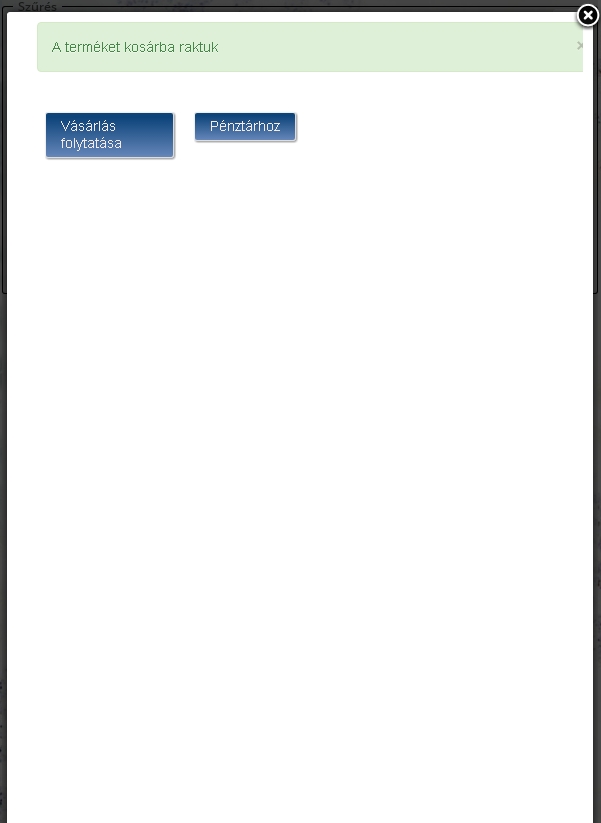

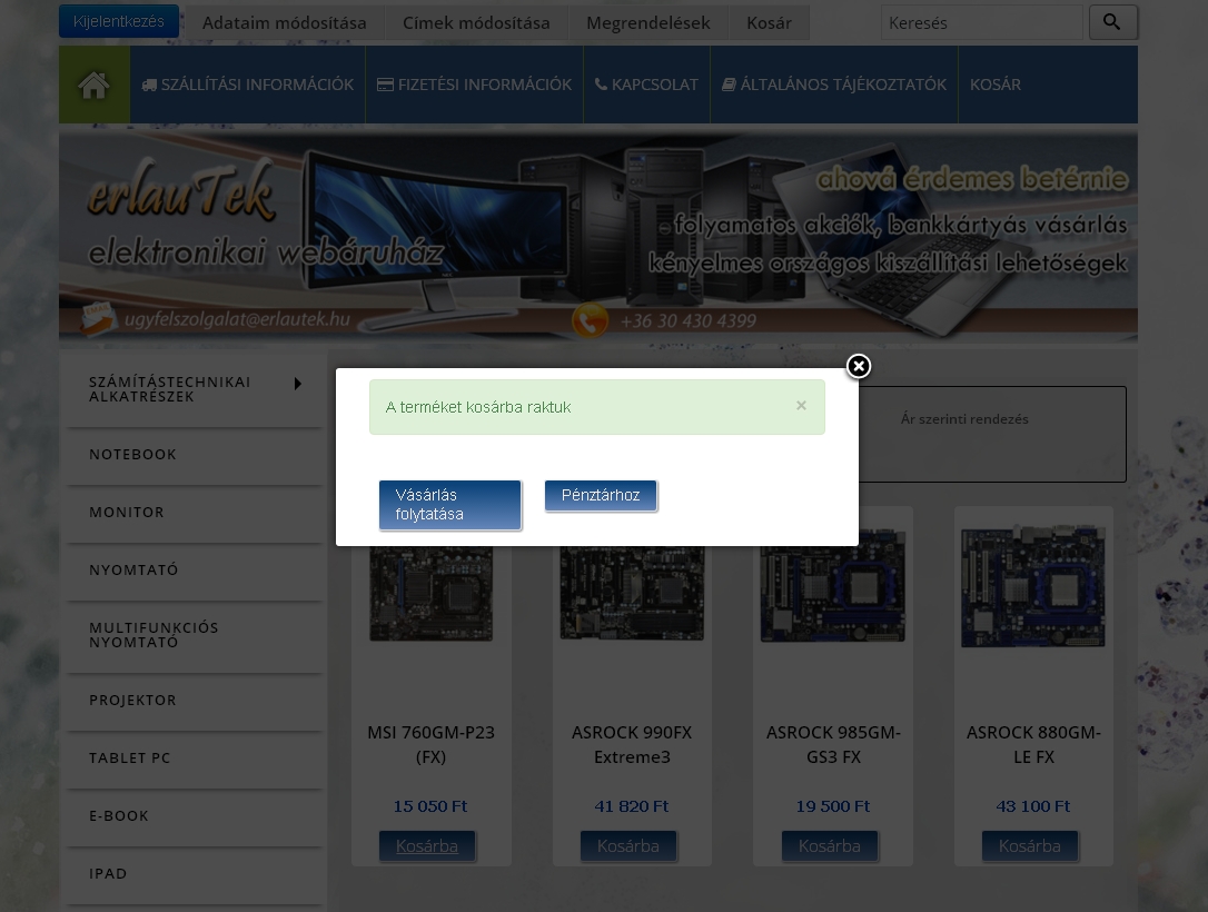

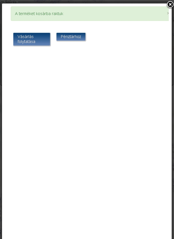

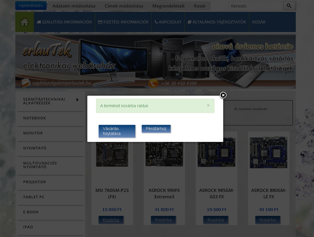

Could you please help me, how I can set the size of the "hikashop_notice_box_content" popup.
In desktop mode it has a correct size, but in mobile view it has always about 100% height.
Attached I send screenshots about the difference.
Thank you in advance for your help.

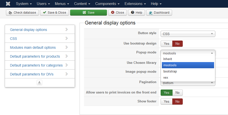

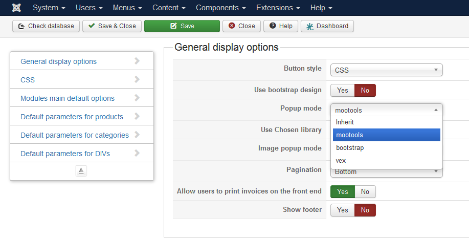

I think that you use Mootools for the Popup mode and that the iframe size is not set in your template or responsive template.
You could try to add the following css to one of those templates:
iframe {
height: auto !important;
width: 100% !important;
Or you can switch from Mootools to Vex (see the image)
