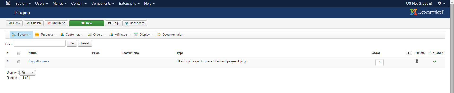

  • Posts: 86214
  • Thank you received: 14221
10 years 7 months ago #229769
The PayPal Express payment method is not a normal payment method and won't display on the checkout. It's goal is to skip the checkout with a "checkout with paypal" button on the cart.
So that's normal.
If you don't want that, you want to use instead the standard PayPal payment method.

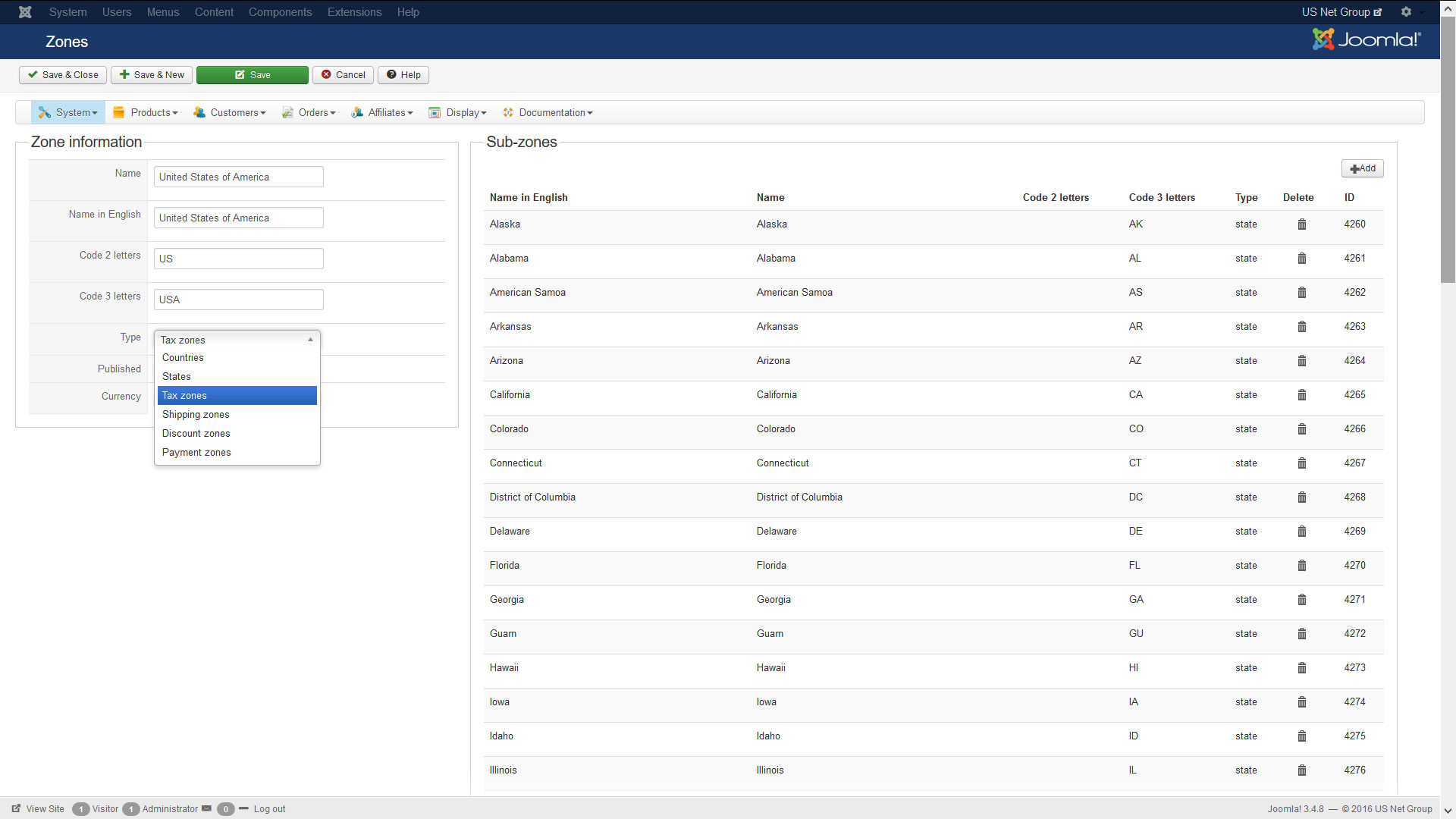

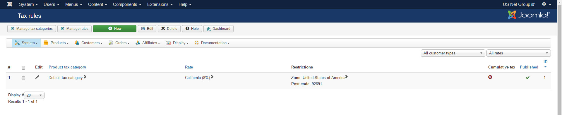

  • Posts: 86214
10 years 7 months ago #229887
Some shipping methods are ok with just the weight. Some others also require the dimensions. So, at least until you get shipping methods to display on the checkout, it's best to try with a product which has both.
We don't need the username/password, you can blur them on the screenshots. We need to see all the other options of the shipping method.
Regarding the taxes, the problem probably comes from:
Copied the United States of America data from the countries to the tax zones.
I'm not sure what you mean, by that, but there is no copying to do. You're supposed to directly select the country zone "United States of America" in the zone setting of your tax rule. If you created another zone with the same name and used it instead of the country zone, then it explains the issue: the country zone selected in the address of the user is not linked to the zone you created for your tax rule and thus the tax rule doesn't apply.

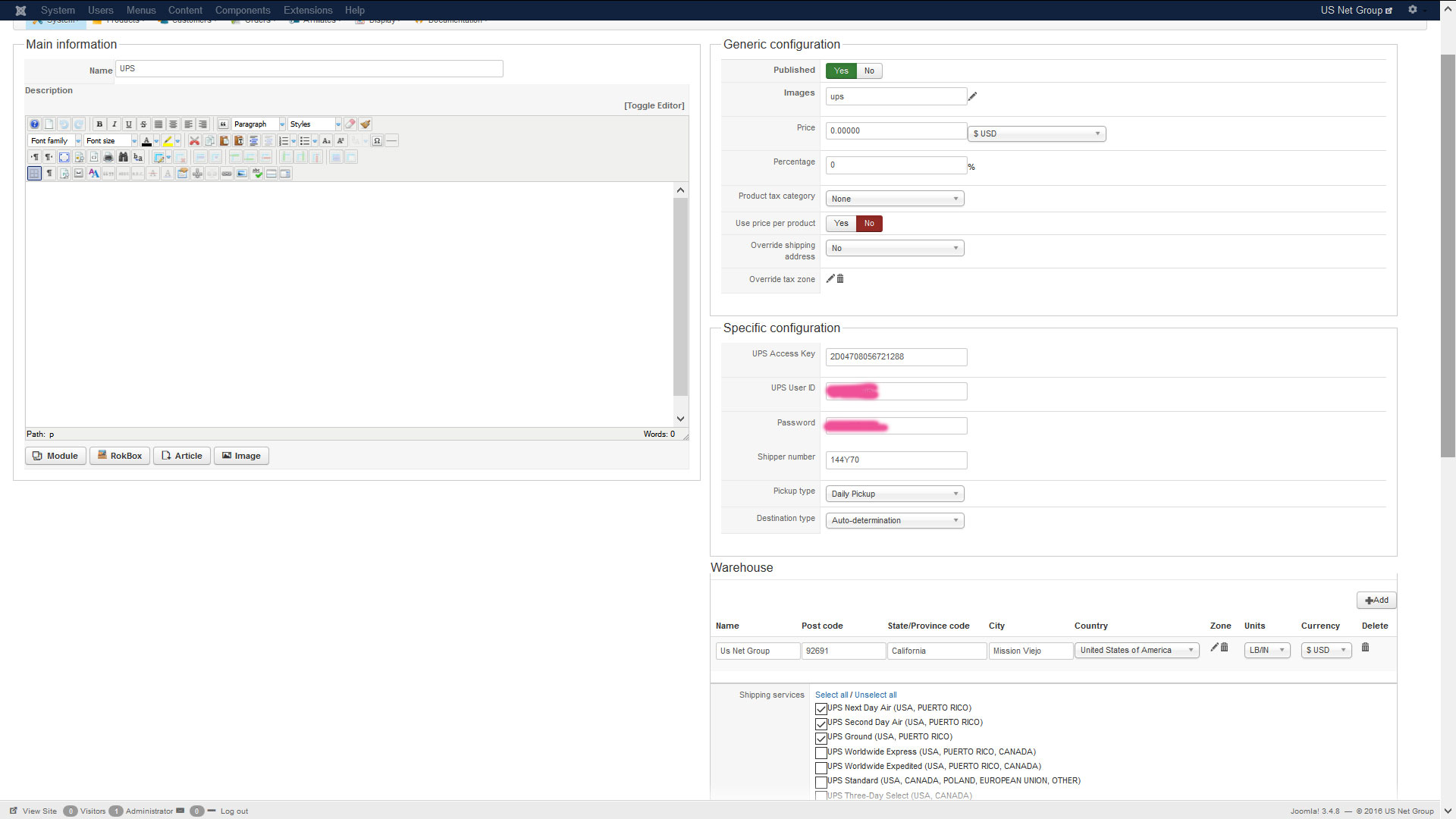

  • Posts: 12
10 years 7 months ago #229947
Please check the attached files.
  • Posts: 86214
10 years 7 months ago #229963
So yes, the USA zone should be a country, not a tax zone.
And for the shipping method, in the "state/province code" field, you entered the name of the state instead of the code of the state, which is CA
Please enter the code and that should help.
  • Posts: 12
10 years 7 months ago #230003
It's working. :)
I changed the state to CA and the shipping is working but I need to add dimensions for each product. :)
How I can show the UPS flat rate in the checkout without adding the dimensions for each product?
10 years 7 months ago #230097
In your case the solution will probably be to set the "Exclude dimensions" option to YES through your UPS configuration page.
Note that some UPS services need to receive products with dimensions else it won't return any rate for your order, so if you want them you'll have to add dimensions to your products.
