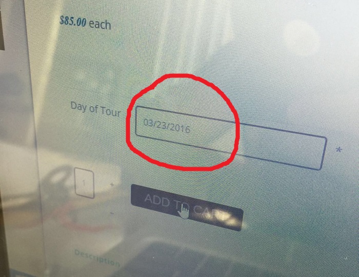

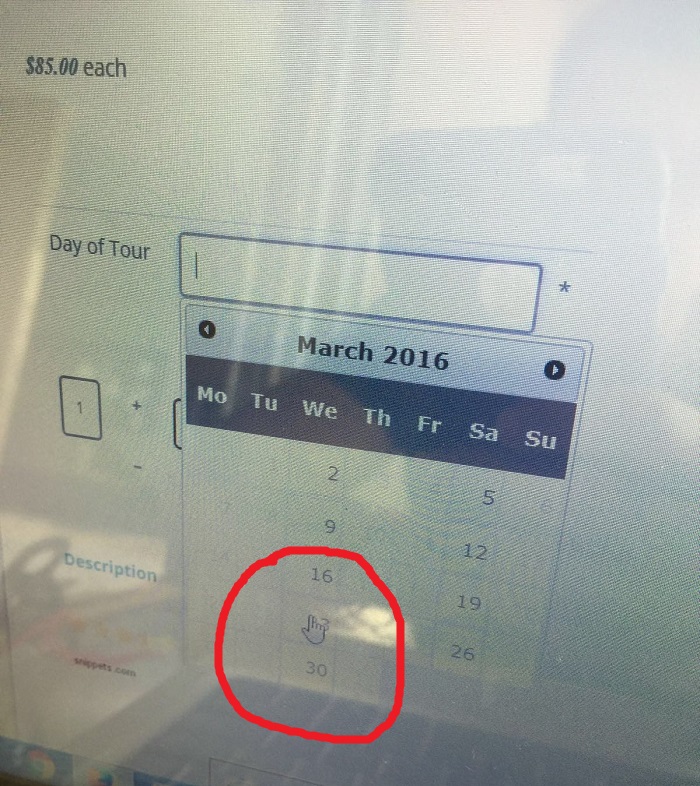

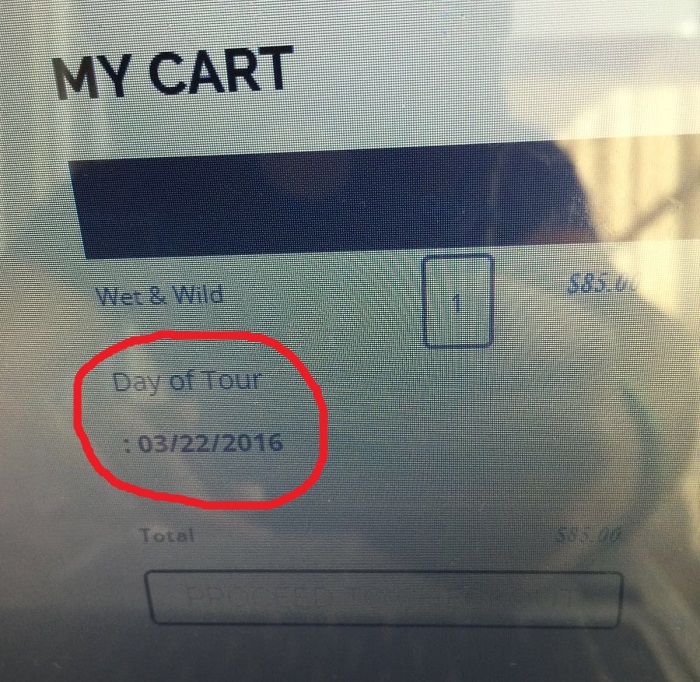

Some weird issue is happening all of the sudden. The date picker is not adding the right dates selected. For the month of February is working fine, the problem is with all the months after.
#1 The dates show fine on the product so you can select them.
#2 The date is selected fine and shows on the screen.
#3 When clicking "Add to cart" it adds the wrong date to the check-out page.
On this example I selected the 23rd on step one, it shows the 23rd on step 2, it adds the 22nd on step 3.
Please see the 3 images, they show what happens.

10 years 7 months ago #229859
You have a timezone issue with your server configuration.
Please activate the special setting in the plugin (in the Joomla side).

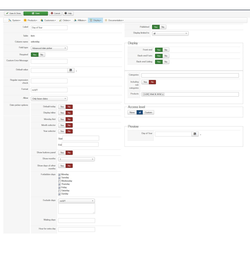

Can you provide a screenshot of the settings of your custom field ?
Please follow the steps here:
www.take-a-screenshot.org/
Can you also check the timezone setting of the joomla configuration and the timezone of your web server (you might need to contact your hosting company) ?
  • Posts: 18
10 years 7 months ago #230112
Thank you very much.
Here is the screen print.
What should I be looking for when checking the timezone setting of the joomla configuration and the timezone of the web server?
