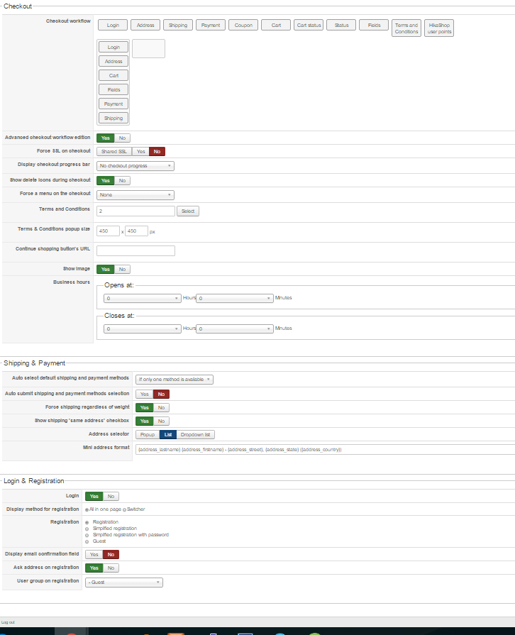

Today a customer off mine wanted to place an order as a guest but the check process does not continue. Could you tell me whats wrong?
I use CC iDeal for payment but it just won't go
10 years 7 months ago #230160
Can you show me through some screenshots for example how you configured your checkout workflow via "Hikashop->System->Configuration->Checkout", and tell me through which step you are having your issue ?
Thanks.

  • Posts: 86214
  • Thank you received: 14221
10 years 7 months ago #230471
That's because you turned off the "auto submit payment and shipping method selection" setting in your HikaShop configuration.
