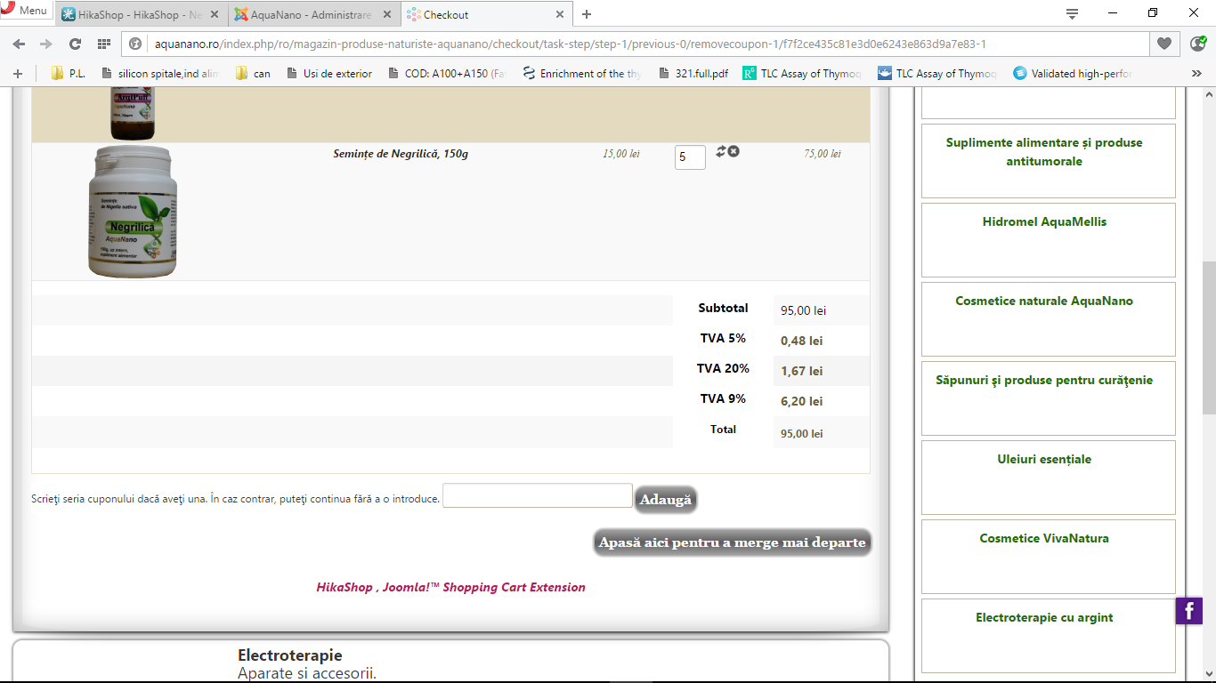

There is a problem with tax calculation when applying coupons. In fact they are many problems.

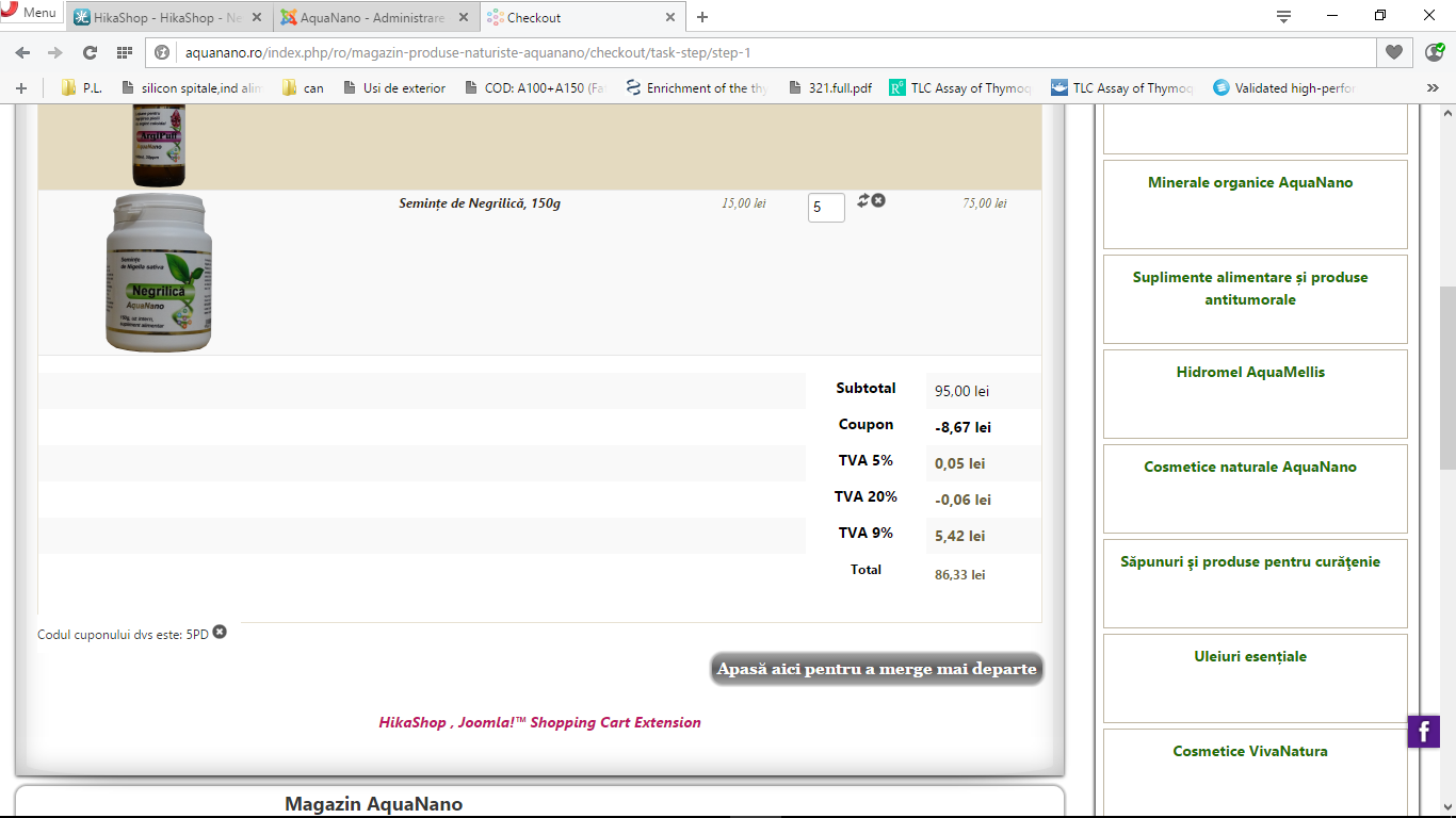

1. First, I noticed that the coupon value was the same, even if it was checked "before taxes" or "after taxes". Also, the taxes were calculated wrong, being the same after the coupon was applied. Also, during checkout, the taxes were displayed wrong, not only wrong calculated, even if in the invoices they were only wrong calculated, but displayed right.
Then I noticed that you have a new version, 2.6.1 (it was 2.6.0), so I updated, maybe...
2. But that "maybe" ... it wasn't. Because I noticed that during the checkout, the behaviour is the same: taxes are displayed wrong when the coupon is applied.
Now, I know the coupon may be applied to any tax category. I let them to None, because I needed to be applied to all of them. I can't use 3 or 4 coupons, one for each tax category, so ... I don't know how the calculations are done in this case, but believe me, you need to see this.
For now, the coupon system is not published, because the invoices are a mess. I kept some from tests for you to see, but it may be necesary for you to make an order, and to check/uncheck the coupon, to understand. Eventually I can provide you with some creen captures, but when taxes became negative during the checkout, something is bad, and this happens. In the final invoice, they are correct (being positive), but not affected by the coupon applied to the invoice, even if this is done before taxes.

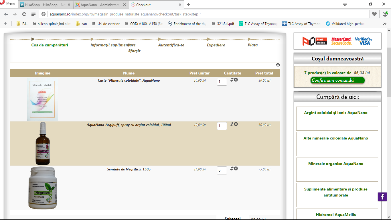

You have attached the files screen captures, 1 without coupon, 2 with coupon, and 3 being the product list. Please note that that coupon is a 10% coupon.
That specific order was not finalised, because the order it is already flawed. For now, the coupon system is unpublished , but it may be published for you to test. Waiting for your oppinion.

The issue is that you set the "product tax category" to "none" in the coupon. This means that the coupon value shouldn't have any tax rule applied to it and thus no tax is calculated regardless of how you set the "apply discount" setting.
If you want taxes to apply to the coupon value, a tax category has to be selected in the "product tax category" setting of the coupon.
Coupons can apply to different products in the cart (not necessarily all) and thus it's not possible to know automatically what tax category should be used for how much of the coupon value. That's why there is this setting so that you can tell the system what tax category should be used for the coupon.
The system has always worked like that.
