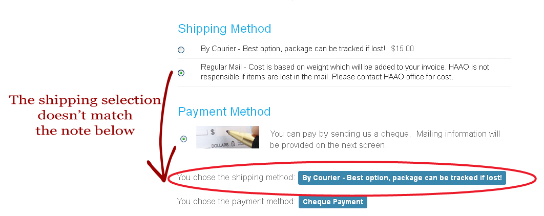

Else, you can also set the "Auto submit shipping and payment methods selection" option to No via "Hikashop->System->Configuration->Checkout"
I changed the option to "no" and the error page is no longer showing, but the message on the screen confirming what the user choose does not match. Please see attached pic.
Thank you!

  • Posts: 51
10 years 4 months ago #236601
If I set the "Auto submit shipping and payment methods selection" option to "Yes" I still get that error that you are describing, even with the "Return URL" removed - unless I am missing something.
You probably tested it when the option was set to "No" - that is why you did not get the error but you try changing it to YES and you will get that error.
Since it appears that the error message cannot be fixed I can leave the "Auto submit shipping and payment methods selection" option to "NO" but how do I get the shipping message on the screen confirming what the user choose to match? Please see attached pic again.
Thank you
