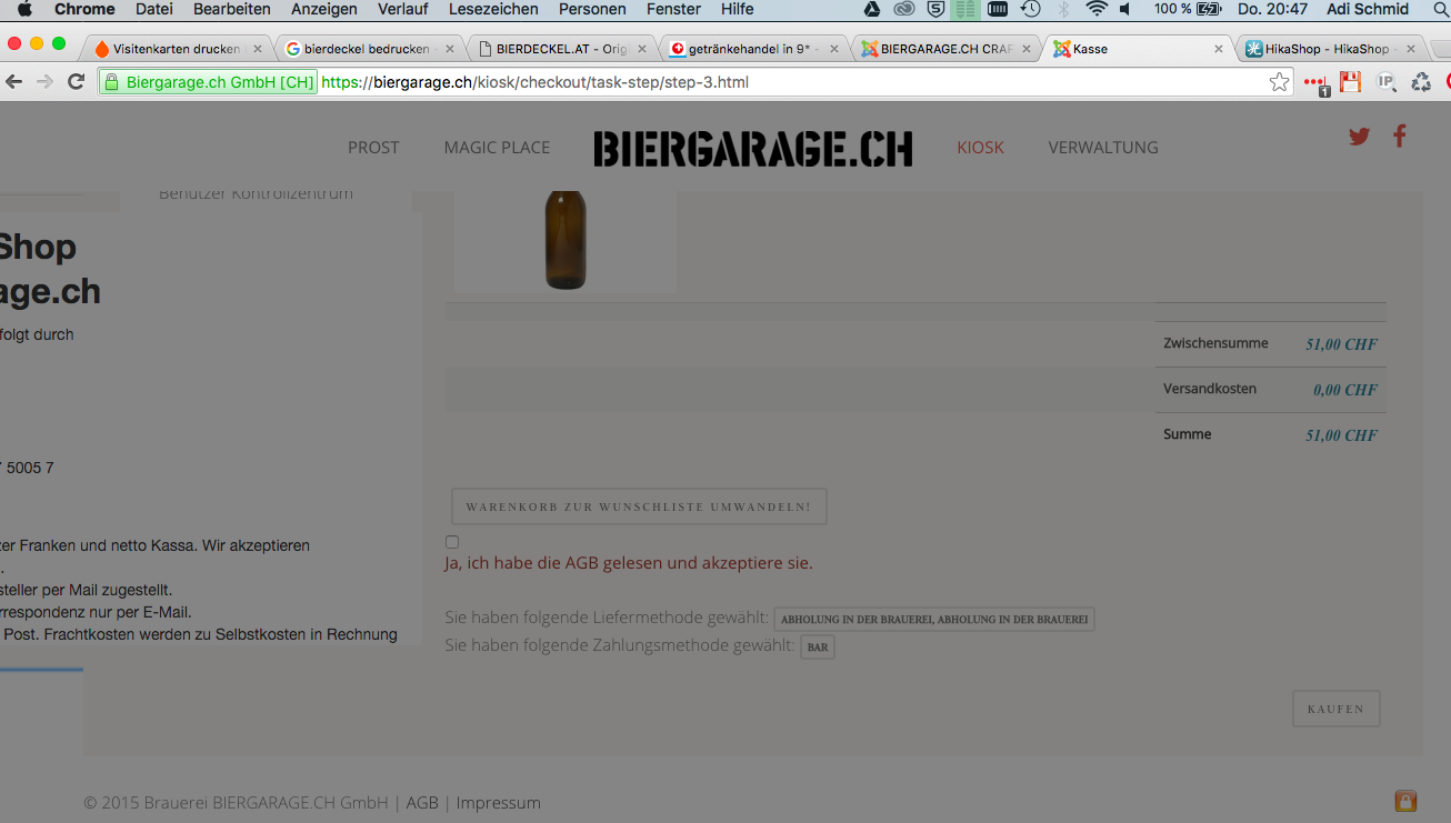

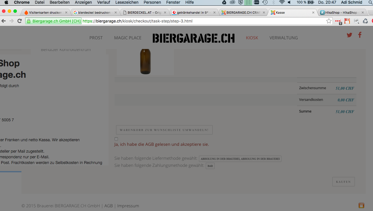

10 years 6 months ago #231289
Hi Philipp
I have a similar issue...
In my shop the Terms and Conditions appears on the left site of the screen and only half.
biergarage.ch/kiosk.html
The same behavior I have also with Safari.
Might you have an idea what I have to update to fix it.
Best and thx
adi
  • Posts: 86214
  • Thank you received: 14221
10 years 6 months ago #231318
That problem comes from your Joomla template which doesn't support the default popups of Joomla 3...
Edit the HikaShop configuration and change the "popup mode" to "vex" and that should avoid the problem.
