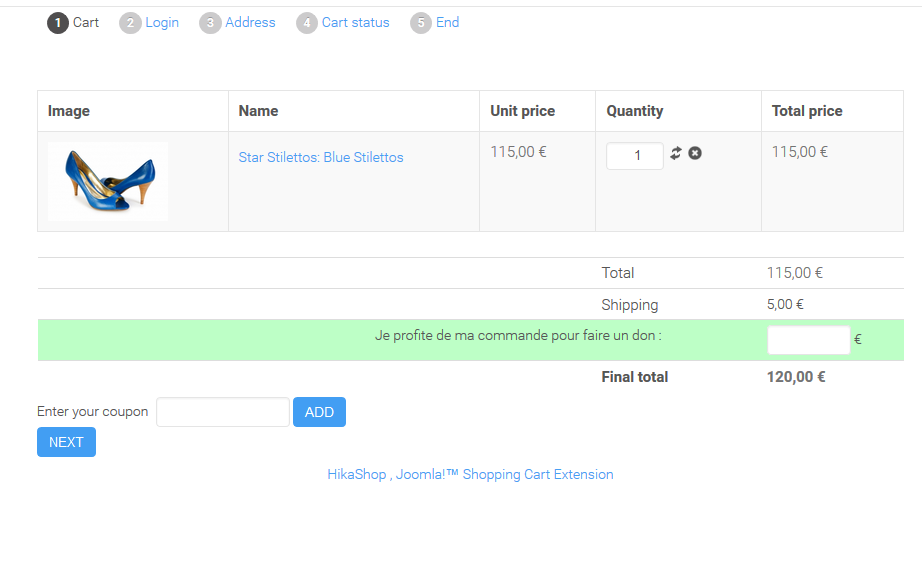

I seen with this : www.hikashop.com/support/documentation/i...p-field-listing.html , that it's possible to create a product of type donation, with amount choosen by customer.

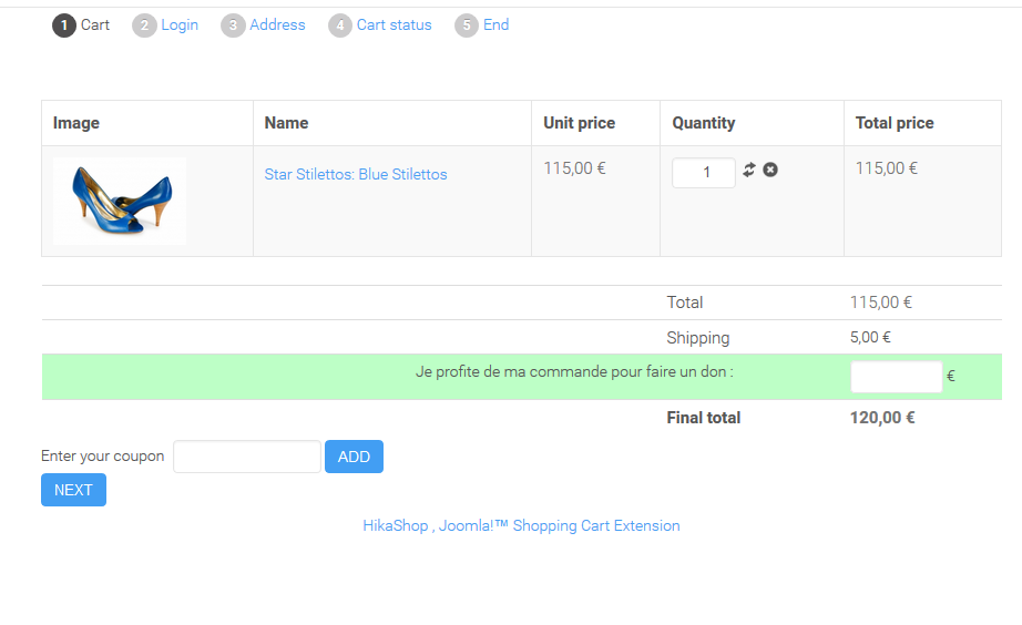

I want that donation do not appear in shop, but during checkout process (near validation Terms of Sales, shipping or fees.. something looks like to picture in attachment).
I want also the amount of donation, be include dynamically in total order.
It is possible ? Or i need to developp a special plugin ?

There is no option for that.
Creating a field on the checkout so that the customer can enter something is possible with a custom field of the table "order" that you can add via the menu Display>Custom fields.
However, there is no system to use that value in the order total calculation. It would require a small plugin to be developed to handle that.
