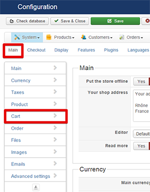

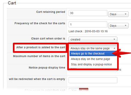

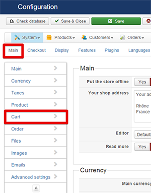

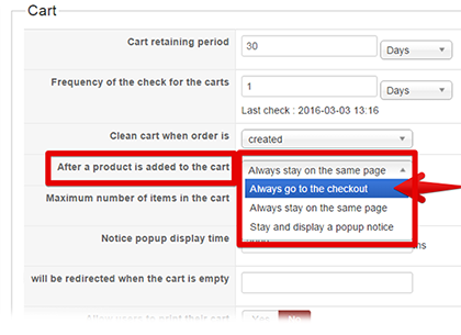

Can you check this specific option "After a product is added to the cart"?
For reach it, follow this steps :
- go to "Components" => "HikaShop" => "Configuration"
- On "Main" tab, click on "Cart" part options
- Look for "After a product is added to the cart" option, and in the dropdown select "Always go to the checkout"
- And don't forget as usual to Save.
Hope this will help you.
