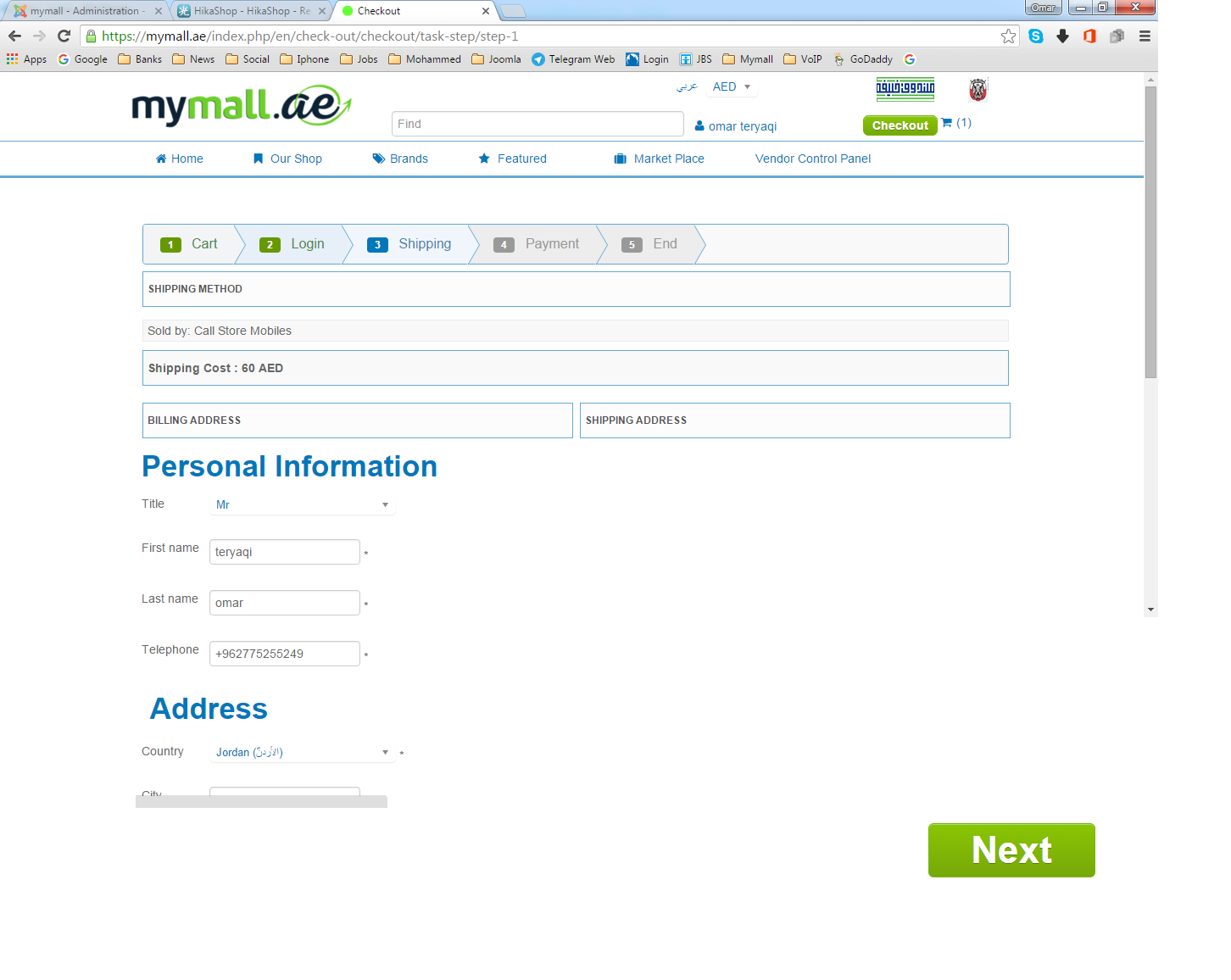

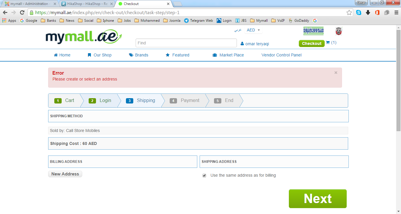

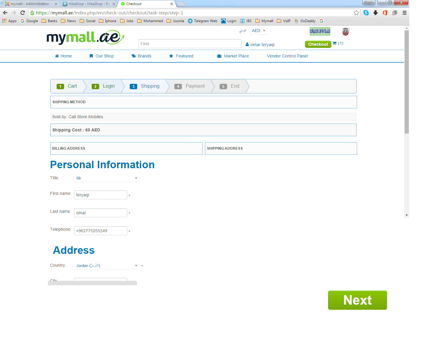

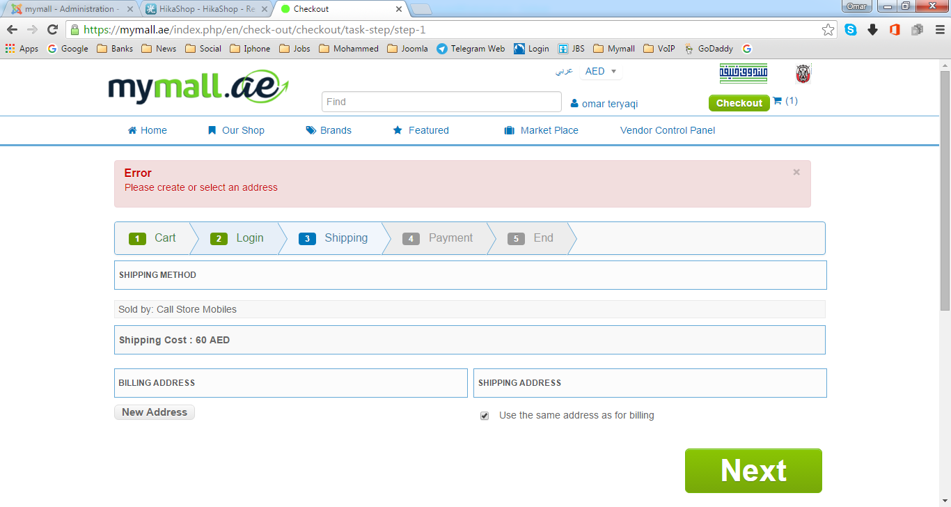

  • Posts: 72
10 years 6 months ago #232563
Dear Sir
thanks for your fast response
I just need to replace that message by the address form and to be in the same page when there is no address
attached is 2 screens shot , the before.png is the current situation, and after,png is what I want to achieve
