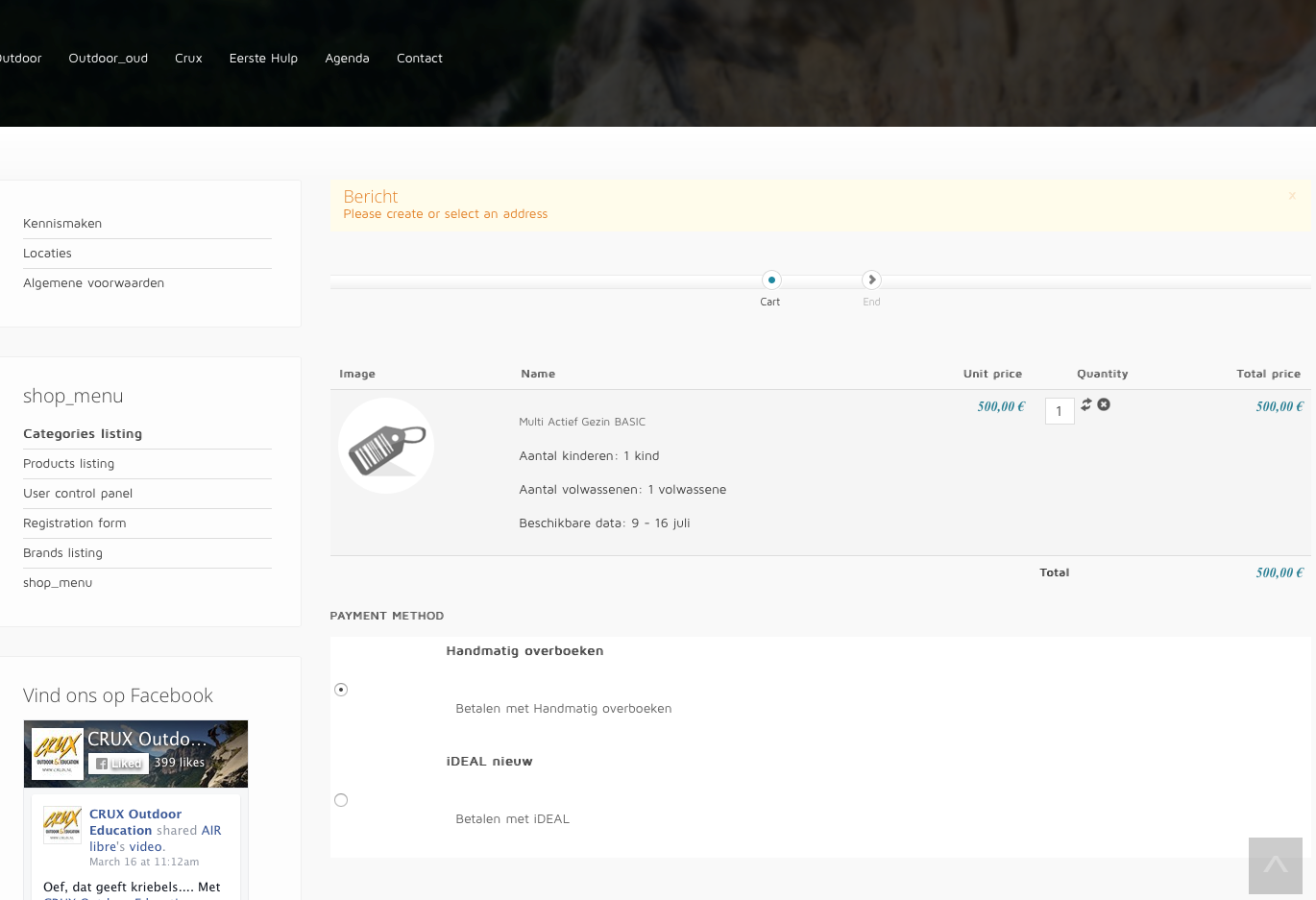

  • Posts: 92
10 years 5 months ago #234754
OK, I am trying this solution, but somehow the address fields are not shown in my checkout. En therefore I cannot finish the checkout....
I probably have done something myself, but I cannot figure out what it is.
I attached a screenshot of what it looks like.

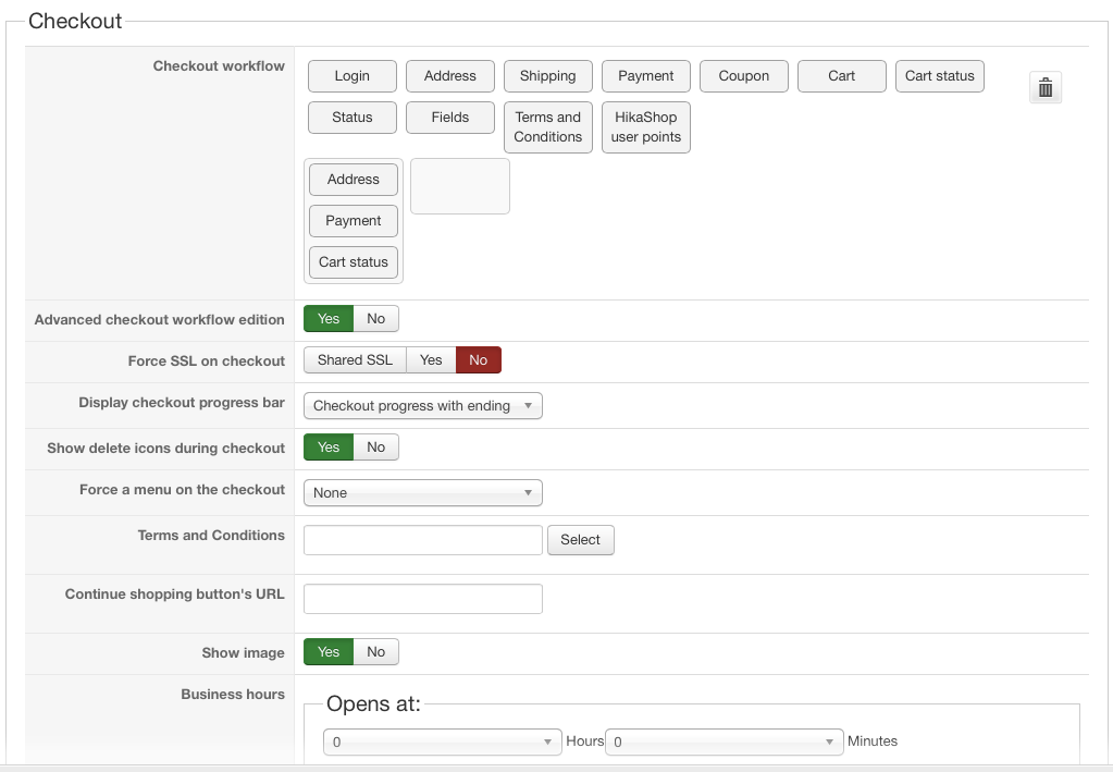

10 years 5 months ago #234764
Then you should add an "Address" action through your checkout workflow via "Hikashop->System->Configuration->Checkout", also can you show us some screenshots of how you configured your checkout workflow so that we can check it ?
Thank you.

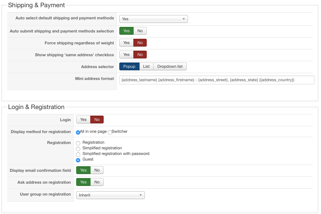

  • Posts: 92
10 years 5 months ago #234846
I have an "adress" action in the workflow. That is the weird part....
See the attachments with the configuration.
10 years 5 months ago #234873
To use the address step you need to have the login one too.
Even if in the settings you use the "Guest checkout".
