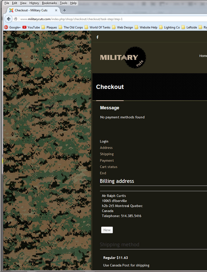

10 years 6 months ago #233593

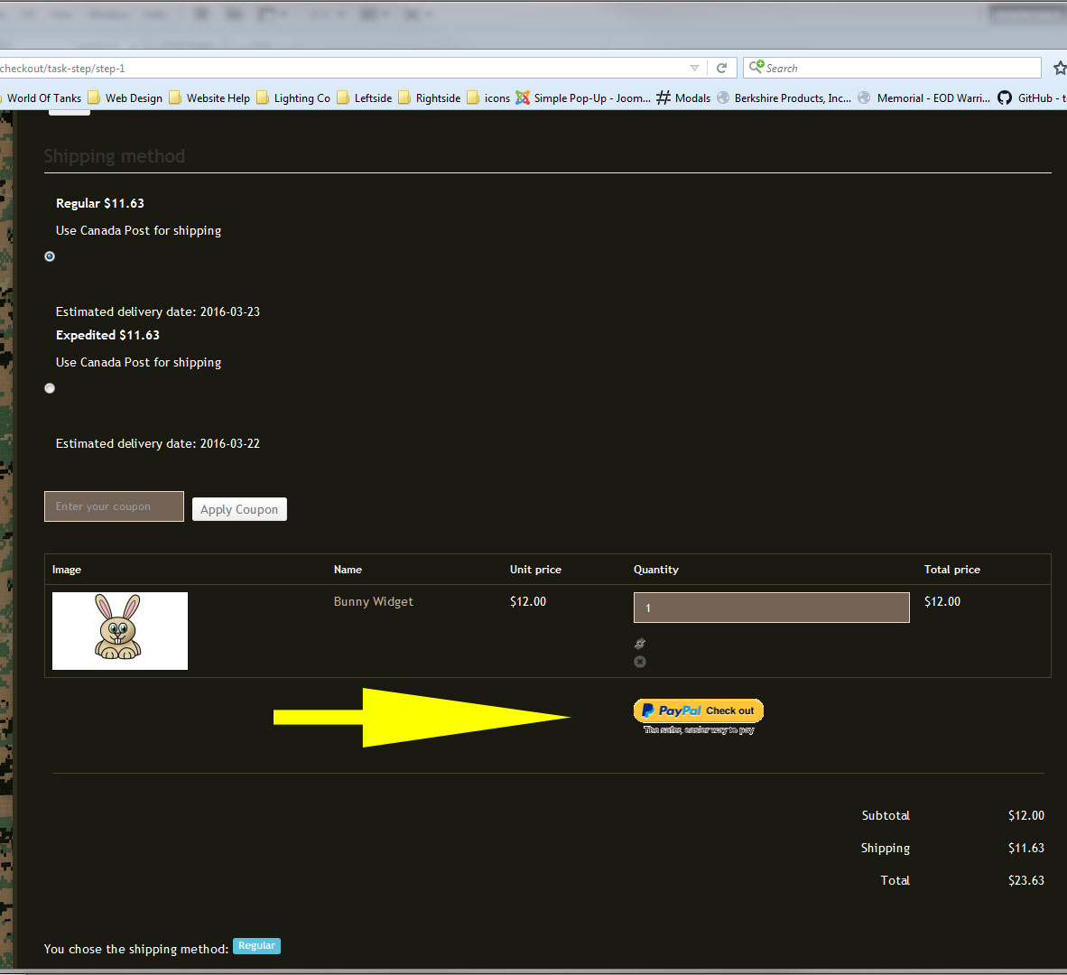

Ok I fixed the shipping issue, the problem was simple, and overlooked however,
I still have a No Payment methods found error.
I am using PayPal Express only, I have all my keys and signatures, the account is connected to my accounts and I can even launch the paypal window with full pricing and shipping but the message still shows up

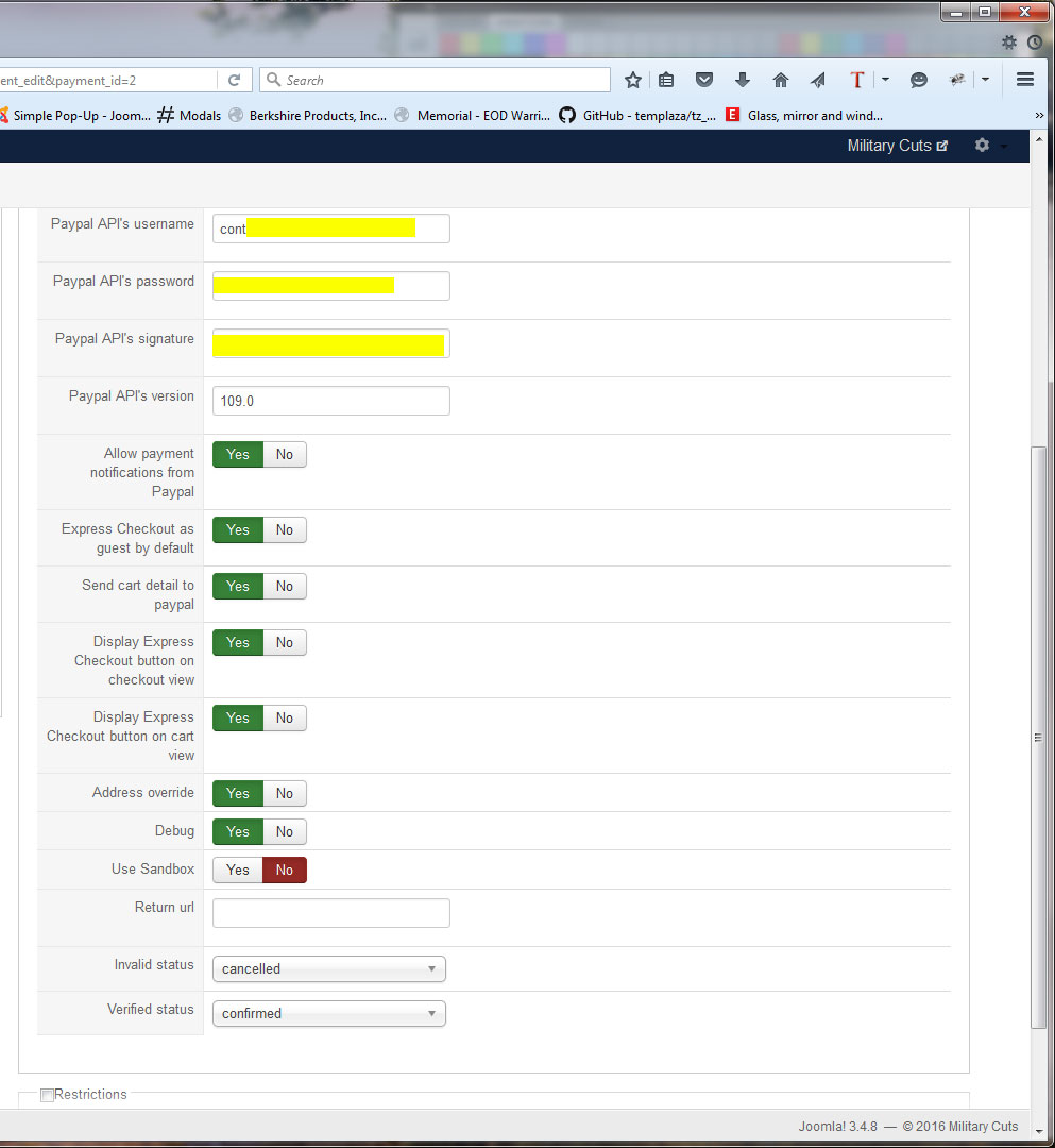

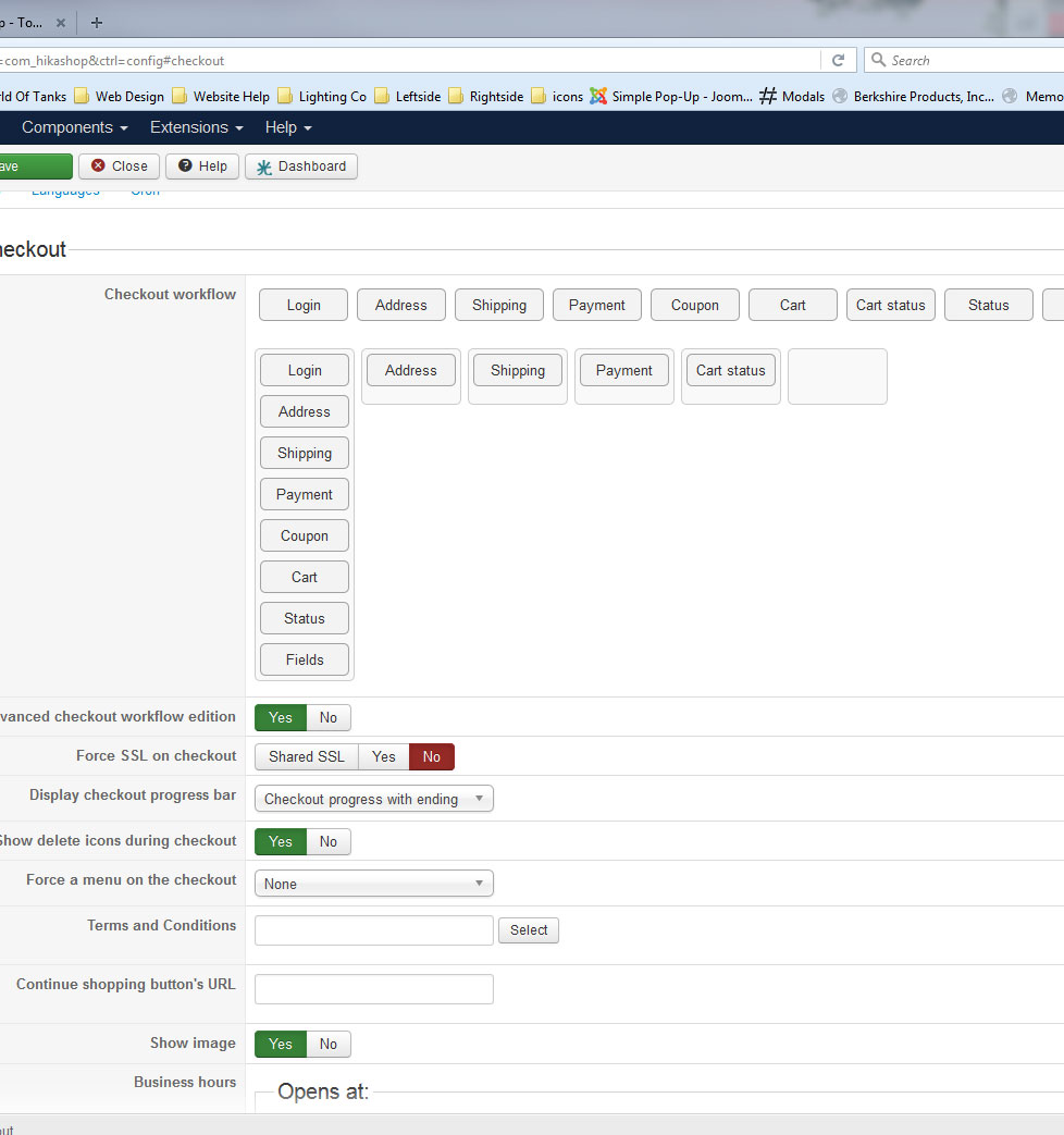

10 years 6 months ago #233599
Thanks for your return, we will go more far can I have your paypal express backend config ?
Did you set these options to "Yes" ?
- Display Express Checkout button on checkout view
- Display Express Checkout button on cart view
And did you remove "Payment" from your checkout, here : Components => HikaShop => Configuration and
Checkout tab.
As you don't need other payment method and as Paypal Express processing redirect you don't need to keep payment in your checkout and so no error message will be displayed.

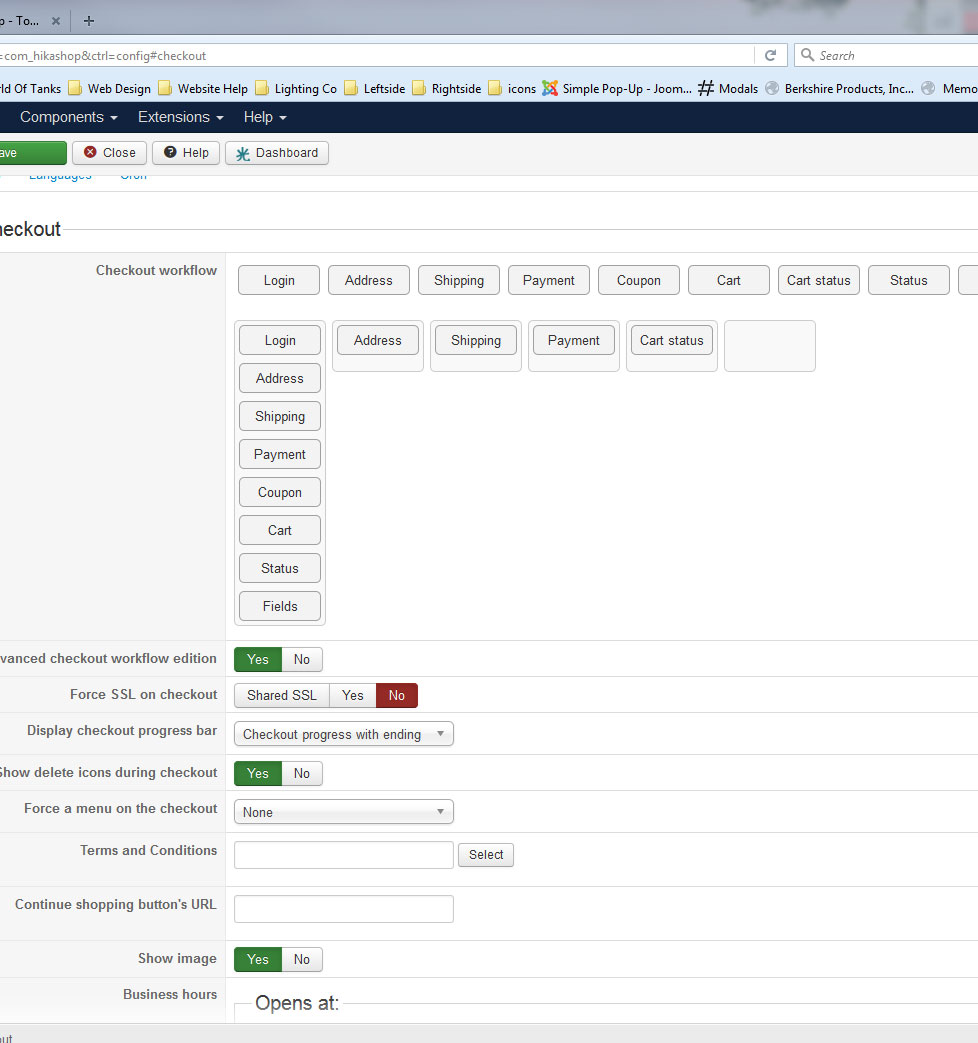

  • Posts: 25
10 years 6 months ago #233669
Hey Philip thanks for your help I really appreciate it.
as far as I know all those features are correct, I do have all these things checkd, here are the screen shots
  • Posts: 86214
  • Thank you received: 14221

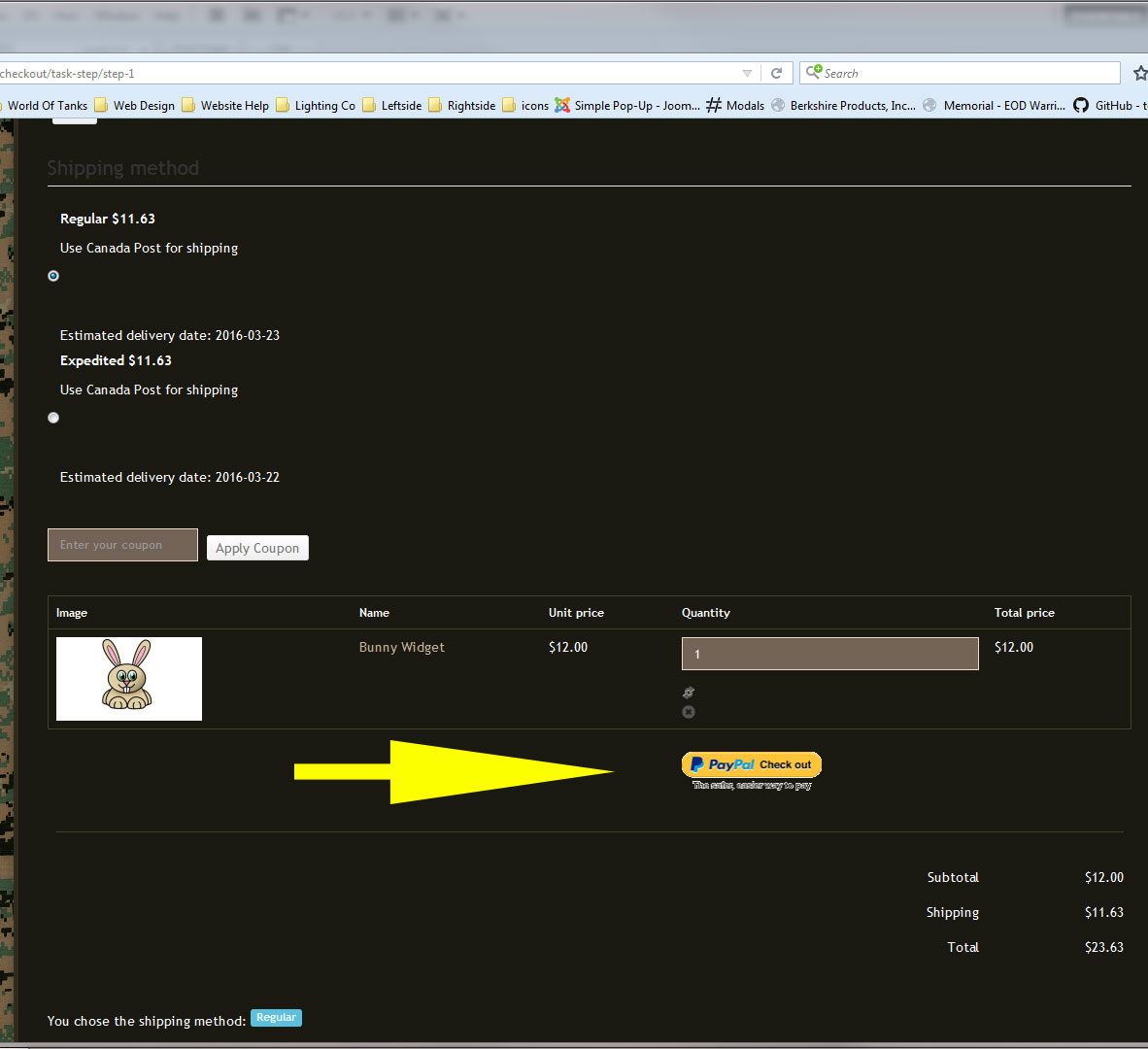

10 years 6 months ago #233715
It's normal that it does that since you don't have another payment method and that the PayPal Express Checkout payment method doesn't display as a normal payment method but as a button to skip the checkout.
What you want to do is to remove the "payment" view from the "checkout workflow" of your checkout. You also want to remove the "next" button of the checkout as you don't want people to finish the checkout on your website. You can do that by changing the line:
if($this->nextButton)
to:
if(false)
in the file "step" of the view "checkout" via the menu Display>Views.
