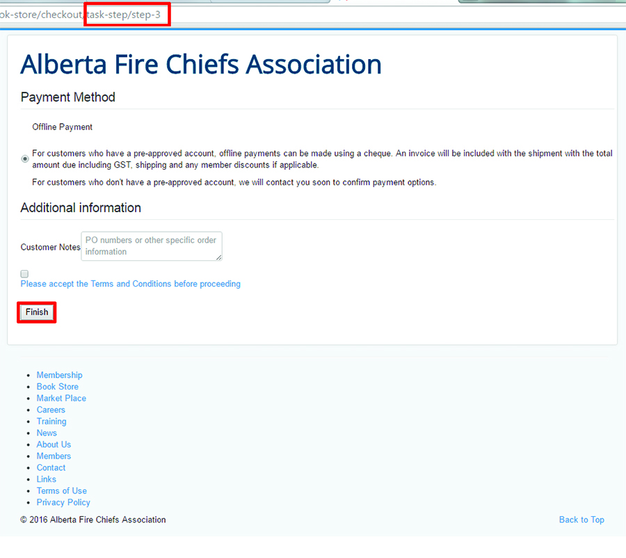

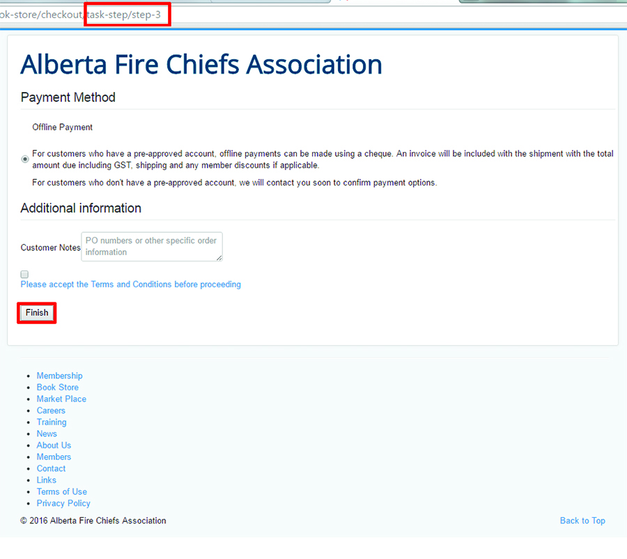

10 years 5 months ago #234719
I process some test, like switch your frontend template for Protostar (default template) and as result I access to your checkout step 3.
So, your issue come from your template, only one solution : contact his creator.
Hope you will find your solution.
Best regards,

  • Posts: 127
10 years 5 months ago #234806
I figured out the issue with checking out and reaching the final step. The shipping.php override in the checkout directory was causing the issues. I replaced it with fresh code and the problem was resolved. Another issue has come up though. The "Edit" and "New" buttons for the billing/shipping addresses are not working, either on my template or under Protostar. When the links are clicked, the page reloads, but no forms are displayed. I have tested this with SEF URLs enabled and disabled, but the result is the same. The non-SEF URL for the "Edit" link is /index.php?option=com_hikashop&ctrl=address&task=edit&subtask=billing&cid=1931&fid=hikashop_checkout_billing_address_zone&tmpl=component&Itemid=388 and the non-SEF URL for "New" is /index.php?option=com_hikashop&ctrl=checkout&task=step&step=1&Itemid=388#newAddress. This seems to be a HikaShop related issue and has nothing to do with the choice of template. Please provide assistance with this issue. Thank you.

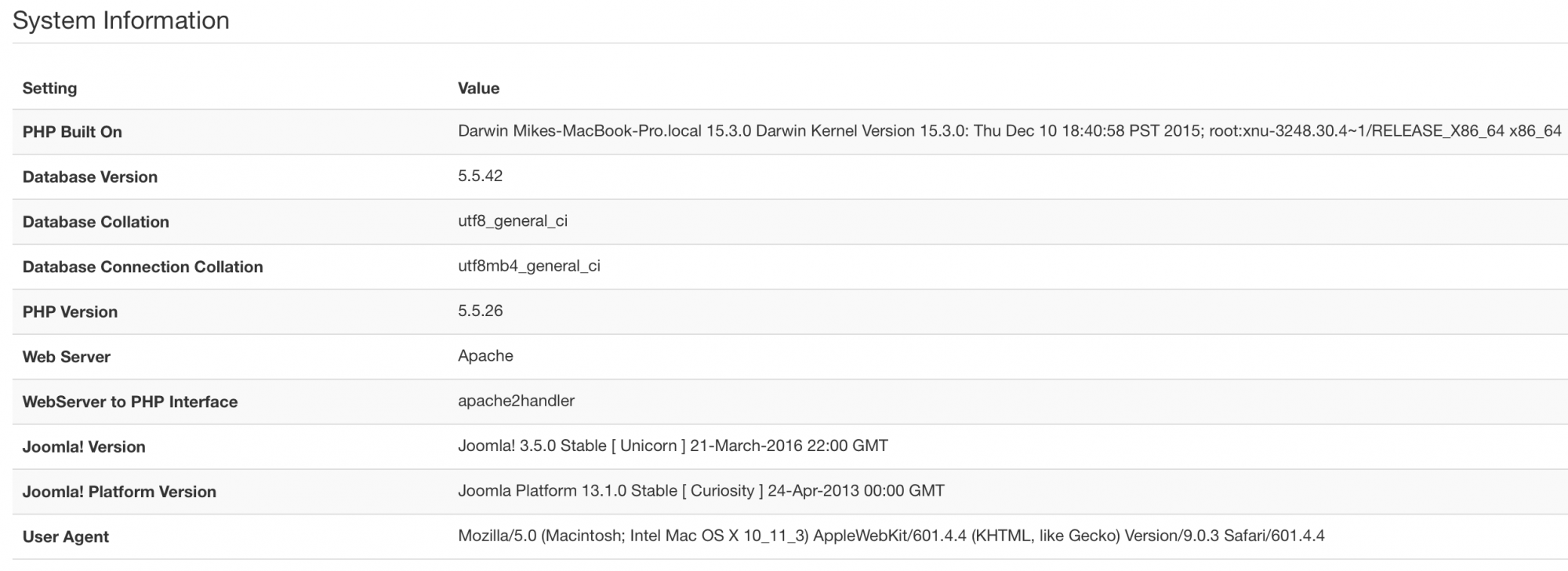

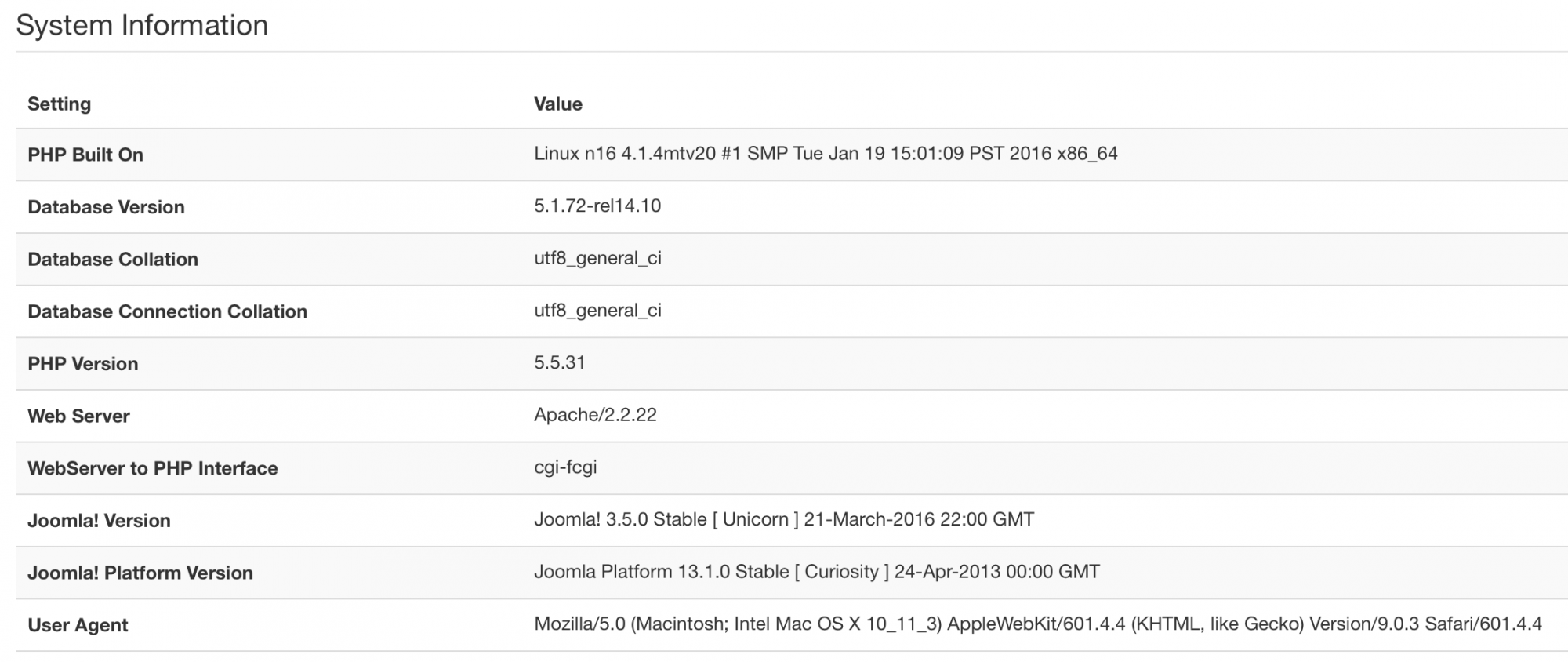

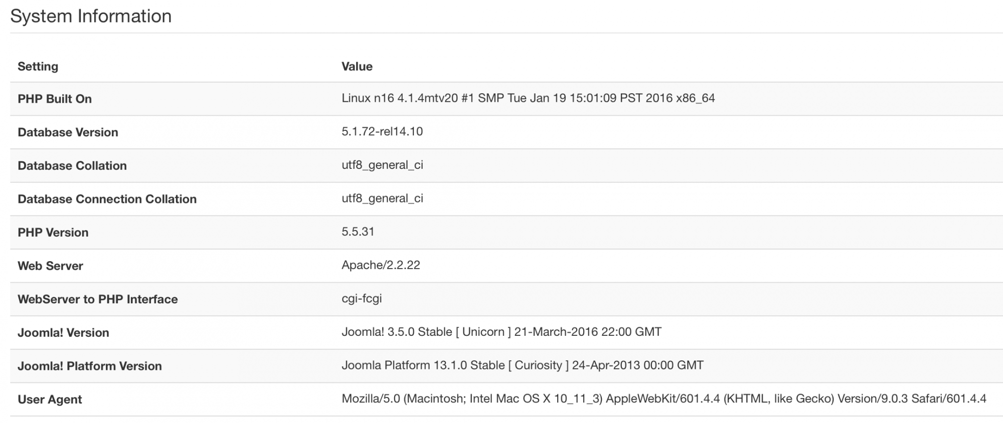

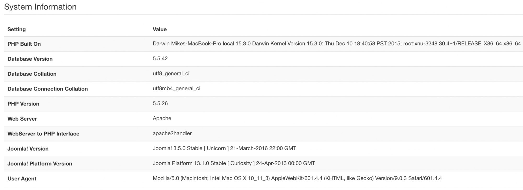

  • Posts: 127
10 years 5 months ago #235766
I have tried going back to the default Joomla htaccess file, but this did not work. I then setup a test installation on localhost using MAMP and PHP 5.5.26. I went through the checkout and was able to successfully use the edit and new address links and forms, so it seems like it is a server related issue. I have attached screenshots of the live and localhost servers for you to review. I know this may not offer much, but it looks like the configurations are similar. Any ideas on what could be causing the breakdown? Thanks.
Mike
