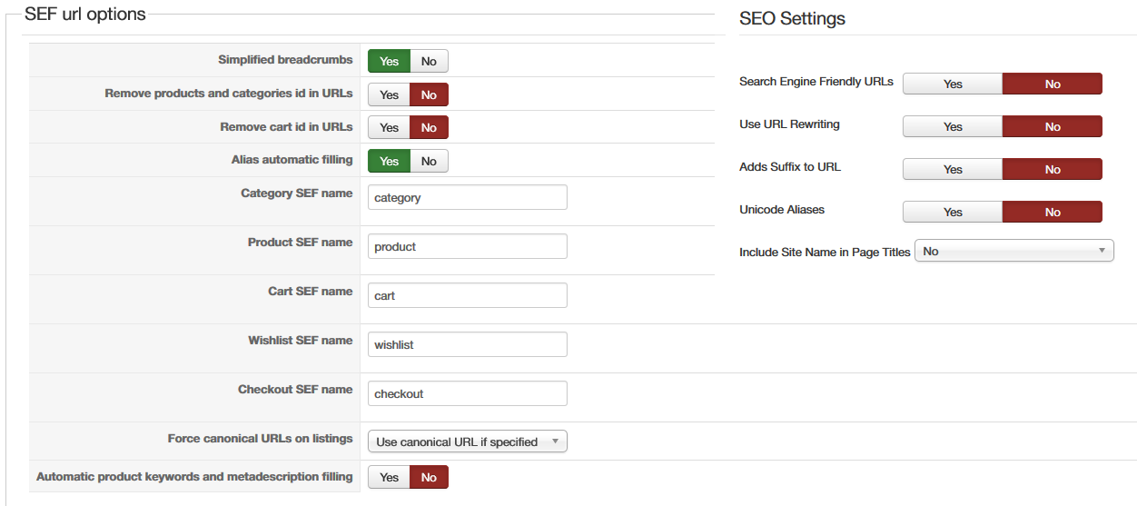

I have just updated both Joomla and Hikashop business to the latest version. Now when I try to place an order I get a 404 error (and in the basic protostar Joomla template "0 Invalid address: KiteOutlet.eu"). The error occurs when you go to step 3 of the checkout process ( www.kiteoutlet.eu/en/checkout/checkout/task-step/step-3 ).
I have tried to figure out what is wrong, but I am now at a loss for what is causing this error.
There is no menu item forced on checkout. But even when there is the error remains.
I have tried both with and without simplified URLs, and my SEF and SEO settings are as in the attached image.
It does not matter which payment method I use.
Before updating everything worked fine. Any help in getting it to work again is much appreciated!
