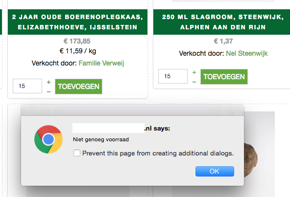

-- Joomla version -- : 3.5.1
-- PHP version -- : 5.4.45
-- Browser(s) name and version -- : Chrome latest
-- Error-message(debug-mod must be tuned on) -- : "Niet genoeg voorraad" which is dutch for not enough in stock (quantity)
For some reason all products with an unlimited quantity (in stock) in Hikashop now have a max limit of 15 for adding to the cart. This happened since the latest update of Joomla (3.5.1) and Hikashop (2.6.2).
The exact error is a javascript alert saying "Niet genoeg voorraad" which is dutch for not enough in stock (quantity). The product configuration however says the stock is unlimited. When I change the stock to a number it works fine.
How can I solve this?

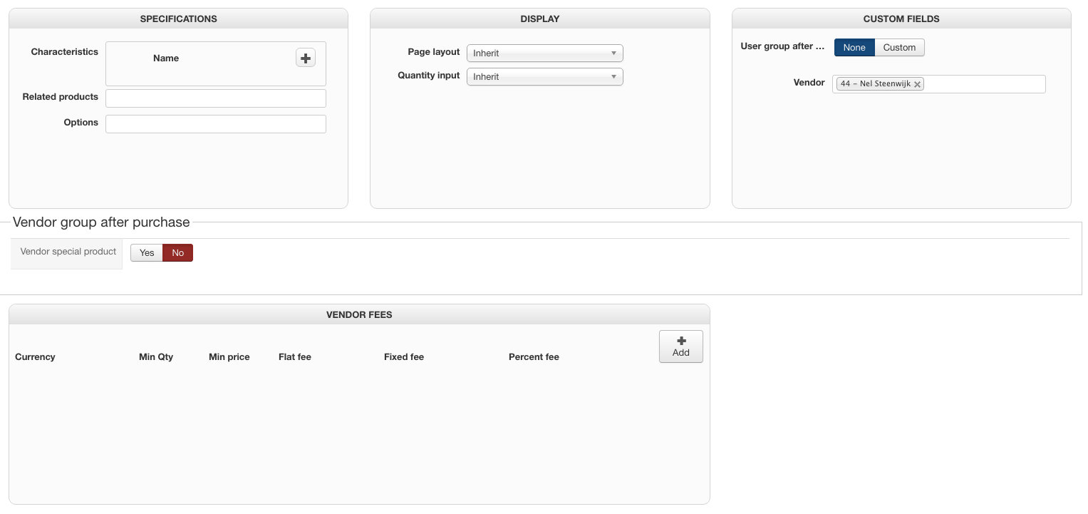

I don't think that it's linked to that setting of your HikaShop configuration.
I think that it comes from the min max settings of each product.
Could you provide a screenshot of the settings of one of your products with the issue ?

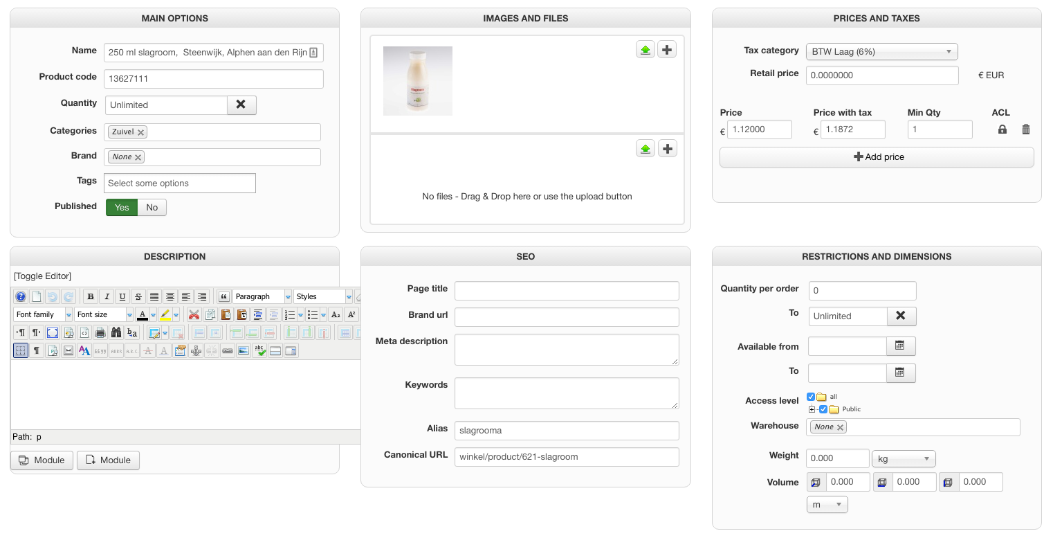

  • Posts: 62
10 years 5 months ago #235957
Ofcourse!
Here is one example. The settings are all the same for the products, except price ofcourse.
10 years 5 months ago #236123
Please edit the view "product / show_quantity" and replace:
$max_quantity = ($this->params->get('max_quantity'))?$this->params->get('max_quantity'):(int)$min_quantity * 15;
By:
$max_quantity = $this->params->get('max_quantity','0');
And add the code:
		if(!$max_quantity)
			$max_quantity = (int)$min_quantity * 15;
After:
	case 'show_select':
And:
	case 'show_select_price':
Thank you for this report.
The following user(s) said Thank You: nuntius

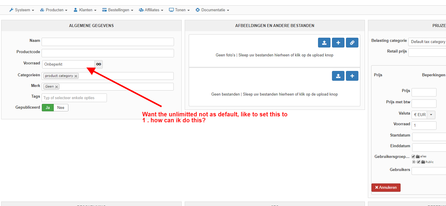

I reply on this topic.. is in the same question i asume.. I want the default quantity setting in backen see attachment not to be default on unlimited but i like to have this to be set to 1.
how can i get this done??
Thanks.
  • Posts: 86187
6 years 10 months ago #312742
You can edit the file "form" of the view "product" via the menu Display>Views and add such code at the beginning:
<?php if(empty($this->product->product_id)){ $this->product->product_quantity = 1; } ?>
  • Posts: 424
  • Thank you received: 11
6 years 10 months ago #312751
THanks that did it.. :)
