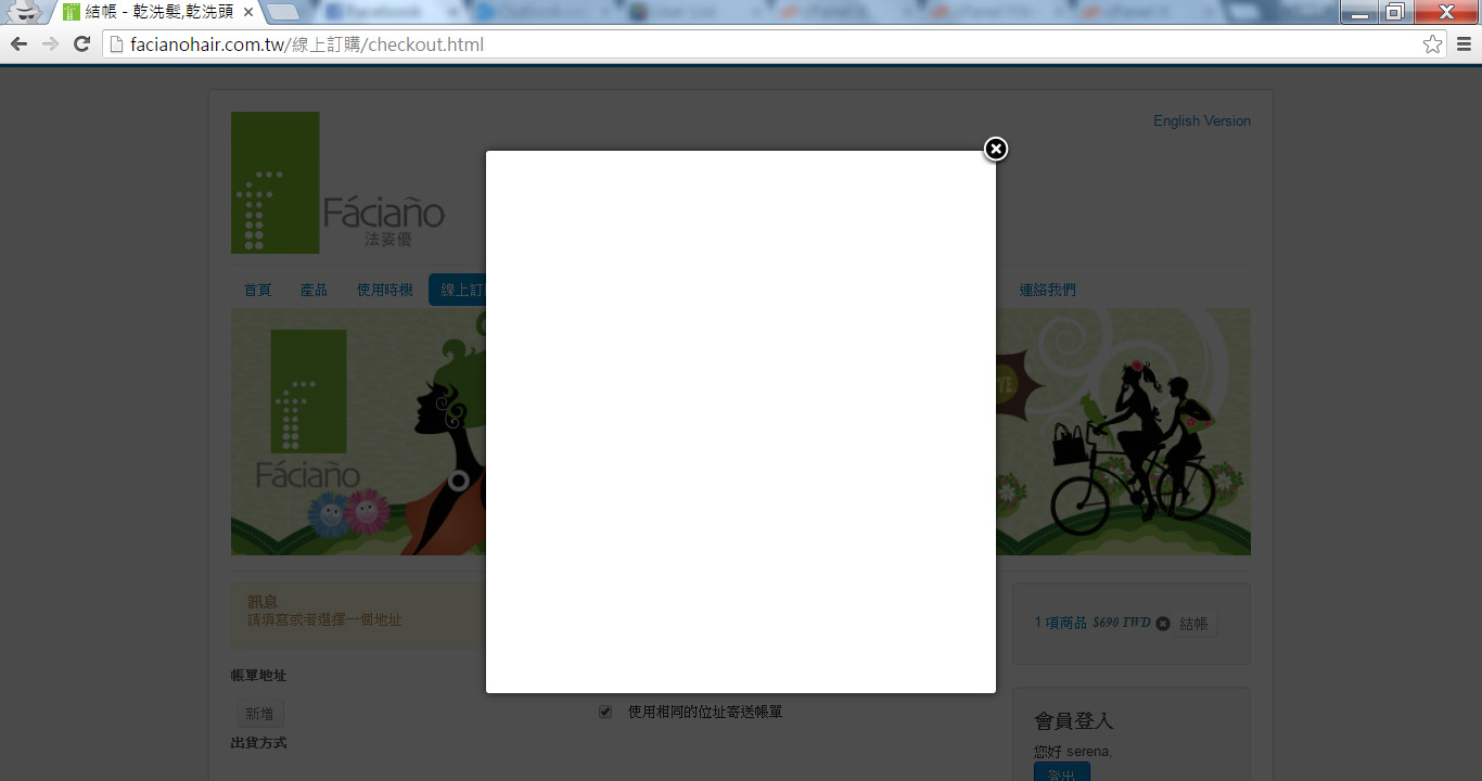

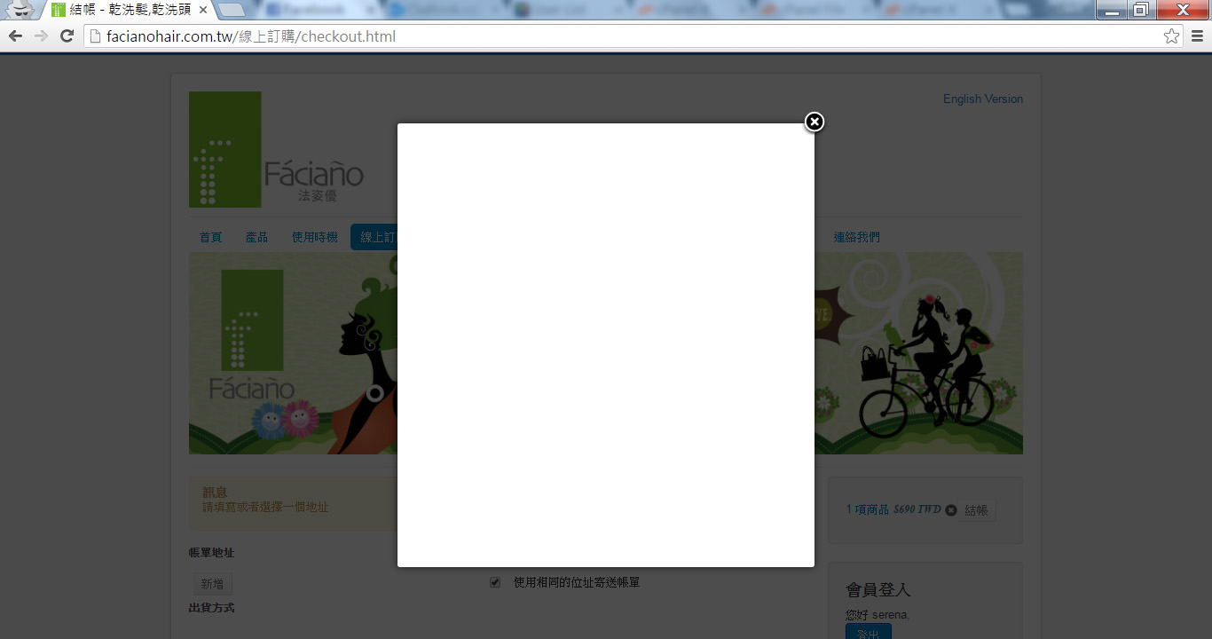

Dear all,
Why is the Check out address pop-up window empty?
I did redirect 301 for some websites for www to none www, index.php to none....
But after I found out empty, I deleted those codes but its still empty. Please help as soon as you can, since customers can't buy products. So much appreciation to you!!

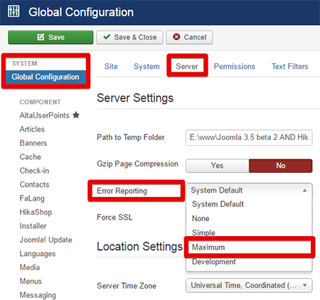

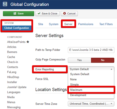

Could you set the Joomla error reporting level to "maximum" and see the displayed error ?
Generally when there is a white page like that, it is due to a PHP fatal error.

Hi Xavier,
Do you mean Debug System turns Yes? I don't see errors.
10 years 4 months ago #238982
Xavier means the "Error reporting" you can reach here in System => Global Configuration, in Server tab, see screenshot on below :
Awaiting news from you.
Regards.
