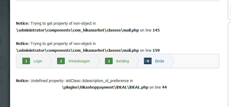

I still have the issues of the confirmation email not being send after payment. I turned all the plugins off and reset the order status emails to default. Still no emails to the customer. In de email log it doesnt show its being send out. It will show the order creation email being send to the customer.
I did find the following error that shows in the attached file.
I dont know if this is stopping the email from being send out?

No, these are just notices not real errors.
