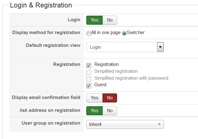

-- url of the page with the problem -- : www.shemeck.pl
-- Joomla version -- : 3.5.1
-- PHP version -- : 3.5.5
Dear Hikashop,
We using login switcher to login during checkout process. From the beginning of using HikaShop this switcher does not work well with our site. When we going to login during checkout nothing is happening when we try to switch between Login and Registration. Only when we switch between Registration and Guest LOGIN FORM is changing. Because of that we do a little modifications in view.html.php file and now is working ok, but every update we must to remember about that.
Do You have some idea what is wrong?
We attach our file with modifications - which is working ok and with our sets.
