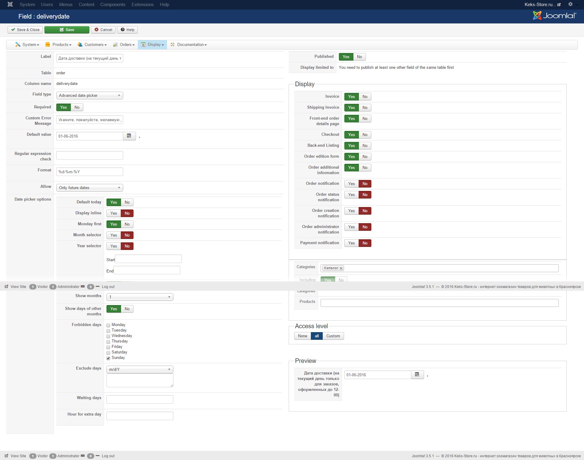

It became necessary to give consumers the opportunity to select the delivery date and I tried to use the built-in plug-in, to create a custom field type Advanced date picker.
I'm having errors in the work, which does not allow you to use this feature:
1. When ordering field is not working correctly with the choice of the date, but it is not possible to select a date on the calendar. Only manual entry date.

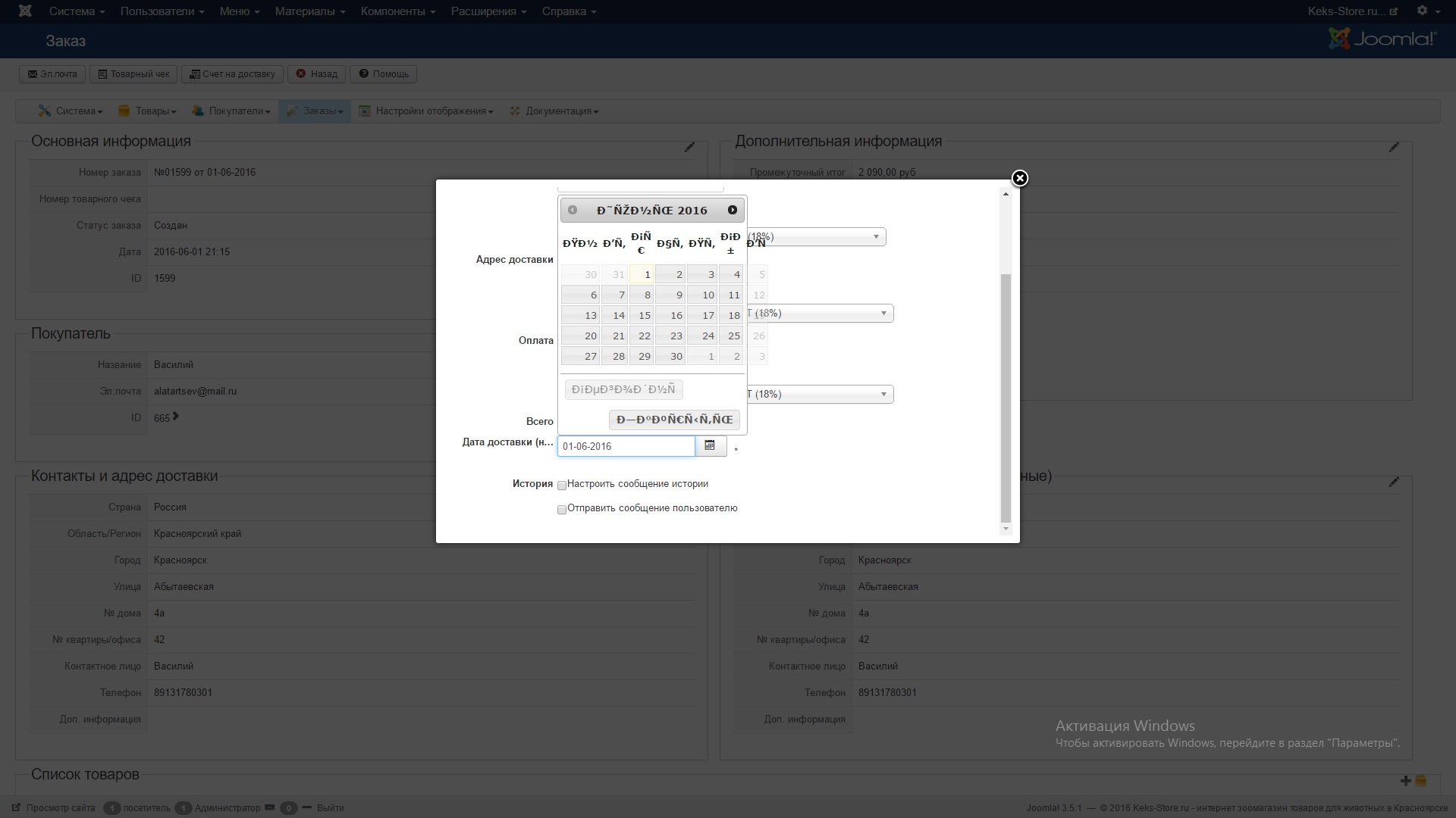

2. In the admin when editing a calendar of delivery dates shown on the labels are not Cyrillic.
See my settings maybe something I did wrong.
And another question. How can we realize the timing intervals for delivery? For example from 12-00 to 14-00 / 14-00 to 16-00, and the like. If at the moment this is not possible, how and where to me to make proposals and suggestions for the development of such a function?

Another point. In the setting of the custom field in the cell "default" is inserted past date, but allowed only future dates. That is in the "default" date not dynamically substituted for the current number. And when you order, respectively, are not substituted.

Nicolas submited an hot-patch in HikaShop 2.6.3 in order to fix some issues with the jquery-ui language file.
It should fix the display for the strange characters we could see in your screenshot.
