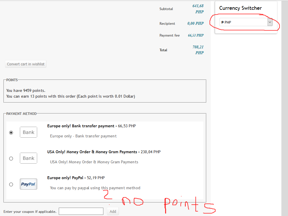

I would like the points payment method to appear in each geolocation and any currency shown.
It doesnt work, see attachment
Thanks for your help

Hi, no I tried it both ways, leaving the currency field blank and then putting all currencies I accept into the field. Both ways it doesn't work. It shows for Euro, Dollar, Pound and Ghana currency.
No success

Hi no, it shows in no currencies only in USD, euro, pound an Ghana cedi
I didn't manipulate any currency settings. I tried to add and remove restrictions, but always the same result. Only four currencies show the points as payment choice. All others not

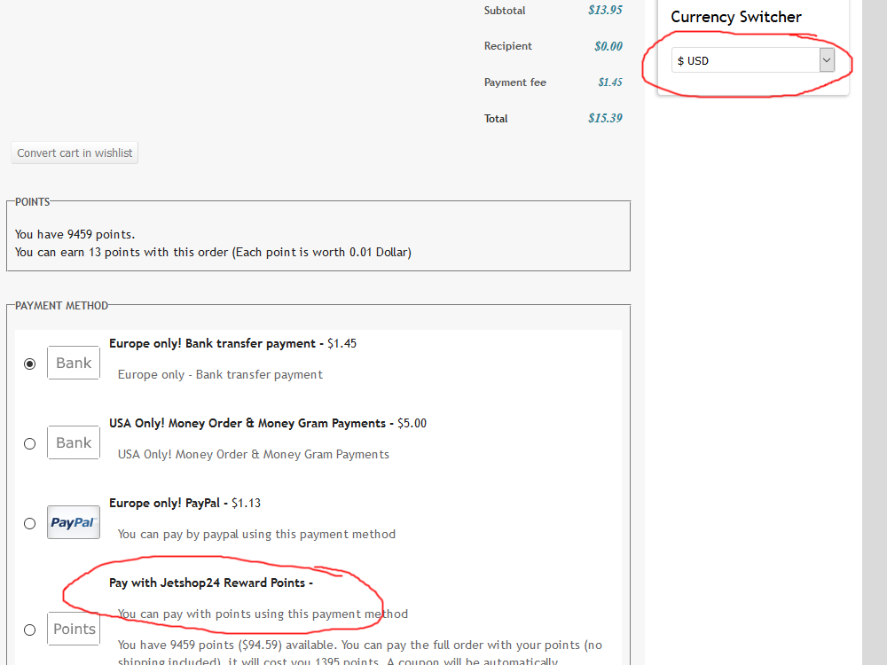

Hi, I found something weird. I gave the test user super much points and then they appeared. But that shouldnt be, as one dollar is one dollar even under another currency. After buying with points again, after giving many, the available point value fell under 400 USD with a point value of 0.01 USD, the point payment option disappeared in Peso for example but remained in Dollar, pounds and euros.
My base currency is USD, so it should not matter what other currency the user switches to, as long as the points have enough Dollar value to be able to buy something.
In short, if the user has 1 USD, equals 100 points in my system, it shouldnt matter to what currency he switches as 51 peso is still one dollar or 43 dalasi also.

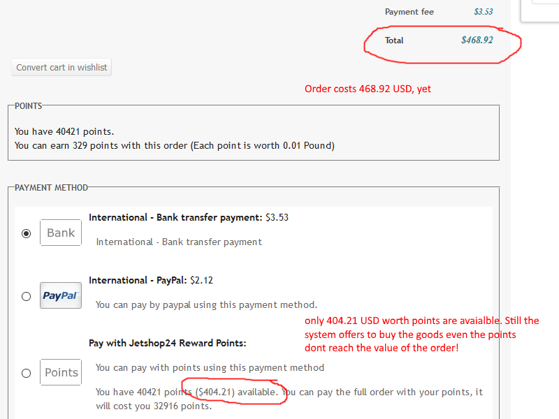

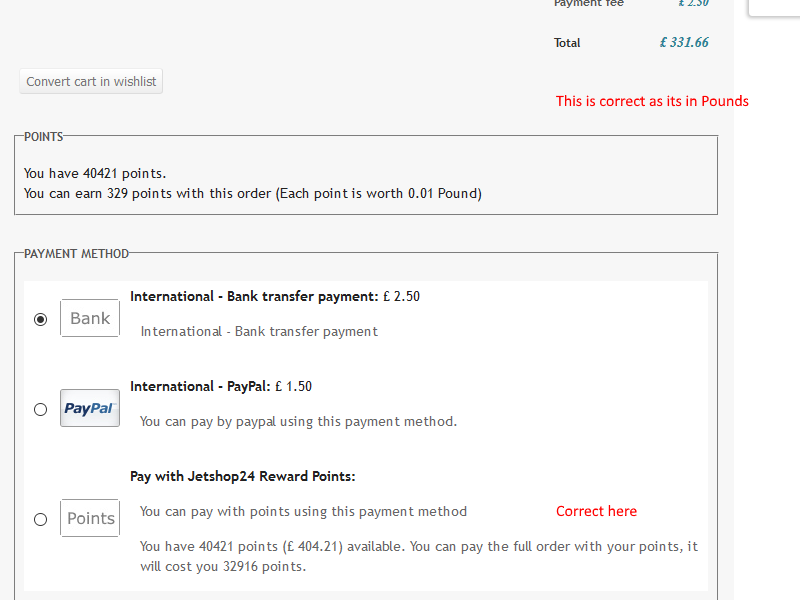

Hello, the system shows now always the points , but my base currency is Pounds, so 40400 points shouldnt show worth 404 USD. So now this is what happens. Why is it not showing the the corect dollar value? 1 pound doesnt equal 1 dollar of course, but the system shows it just like that.
If I switch to Pounds it shows the same amount but just changes the pound symbol. When I switch to USD it should show the correct exchange rate

HENCE, it seems to base everything on my base currency Pounds, but it treats all currencies equal by just taking the number but disregarding the exchange rate. It does exchange rate the other payment options, just not the points payment.

The points conversion is always with the main currency store. The value that you can find between parentheses is not really in USD but in Pounds.
In latest package, Nicolas added a patch which might fix some elements but it does not fix all the display.
The plugin has not be designed for that and it would require a specific development in order to add that support.
