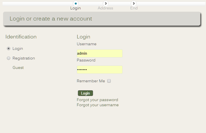

-- Joomla version -- : 2.5.28
-- PHP version -- : 5.4
in checkout / login.php file i have added a div called "guest" with a link to a custom page. There are the 2 radio buttons above that (login-register), can i make the "guest" button also a radio button?
Thank you in advance
  • Posts: 86216
  • Thank you received: 14222
10 years 2 months ago #244942
Yes. Make sure that the input radio of your choice has the name
data[register][registration_method]
so that it is in the same group as the other ones. And add an onchange attribute to it with your javascript code to hide/display your div.

10 years 2 months ago #245015
You have to use "onclick" with some parameters in order to redirect when your customer click on the Guest checkbox.
Try to use this code IN <fieldset class="input"> like this :
  $doc->addScriptDeclaration("\n<!--\n".$js."\n//-->\n");
  echo JHTML::_('hikaselect.radiolist',  $values, 'data[register][registration_method]', ' onchange="displayRegistration(this)"', 'value', 'text', $defaultSelection, false, false, true );
			<div class="crisregister">
				<input class="crisregister" type="radio" name="data[register][registration_method]" id="data[register][registration_method]0" value="0" onclick="window.location.href='index.php?option=com_fabrik&view=form&formid=1&Itemid=305'"/>Guest
			</div>
      </fieldset>
And of course, remove this line :
<div class="crisregister"><a href="index.php?option=com_fabrik&view=form&formid=1&Itemid=305">Guest</a></div>
Hope this will fit your needs.
