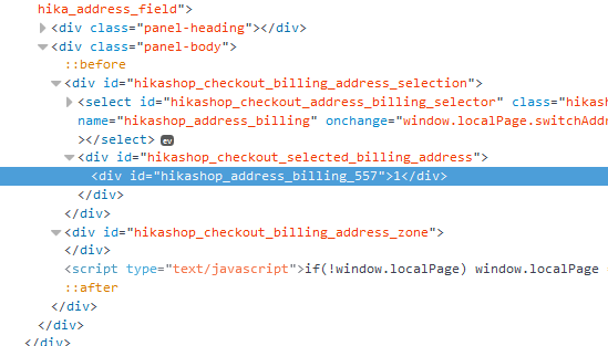

Everything is working fine when you come to address step at first time. List is displayed and if required fields are not entered pressing on next button will give notice message, so it works fine. However if address entered and then deleted system will not give any notice and just goes to next step. Going back there is no address... Can someone please check on they end?
After I delete address it will show radio button with number 1, I have attached screenshot to be more clear. Not sure from where it is coming from as i get same results with protostar template....If refresh page everything goes back to normal and it ask to enter billing address...

10 years 2 months ago #245705
This time I succeed to reach your checkout AND your backend, and I see now the issue.
And I'm sorry because I have a bad news, you had right the issue come from HikaShop but for now, it's impossible to get the root of the issue...
The other point is that HikaShop 3 are coming and with it, a new checkout process that will for quite sure solve this issue (because the process is totally different).
Can I advice you to switch to popup mode like before for waiting HikaShop 3 ?
Awaiting news from you about this suggestion.
