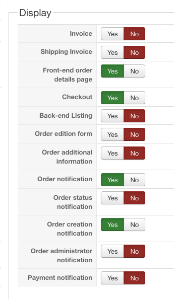

hello,
in the checkout process, the customer can enter a message/comment before paying. But this comment doesn't show in the email ( Order creation notification ) .
Do I have to add some code in the email template ?
thanks, Pierre
  • Posts: 85952
  • Thank you received: 14143
9 years 11 months ago #248237
No code should be necessary.
How did you configure your custom field ? Could you do a screenshot of its settings ?
  • Posts: 38
9 years 11 months ago #248375
Hello
after your answer, I found the problem, this custom field was not set for the order creation notification. Thank you anyway.
just as an info:
the custon fields documentation seems to be a little bit out of date, the many (12) display are not explained
best regards, Pierre
