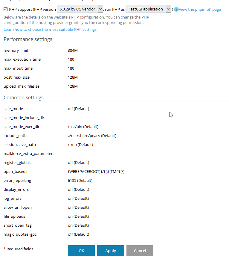

  • Posts: 68
9 years 11 months ago #248647
I rang the hosting support and they changed the post size to its maximum with no luck.
Look at the attached screenshot.
could I add the coupon field by editing code instead of going through the admin area?
thanks
memory_limit 384M
max_execution_time 180
max_input_time 180
post_max_size 128M
upload_max_filesize 128M
