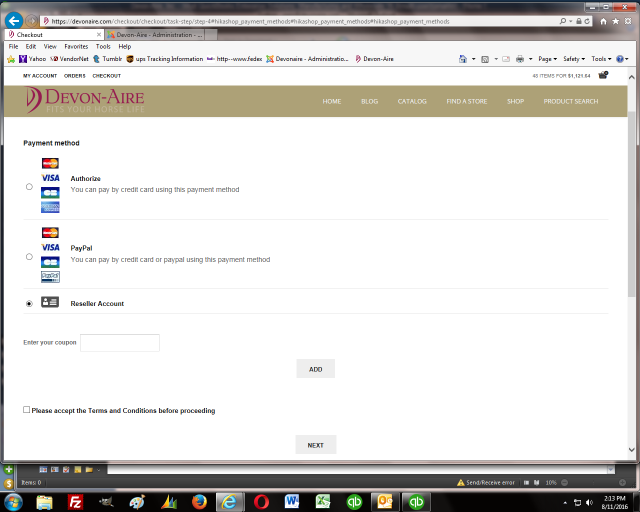

During the checkout process and the bottom there is a place to check Agree to Terms and Conditions.
How can I add my terms and conditions text under that?

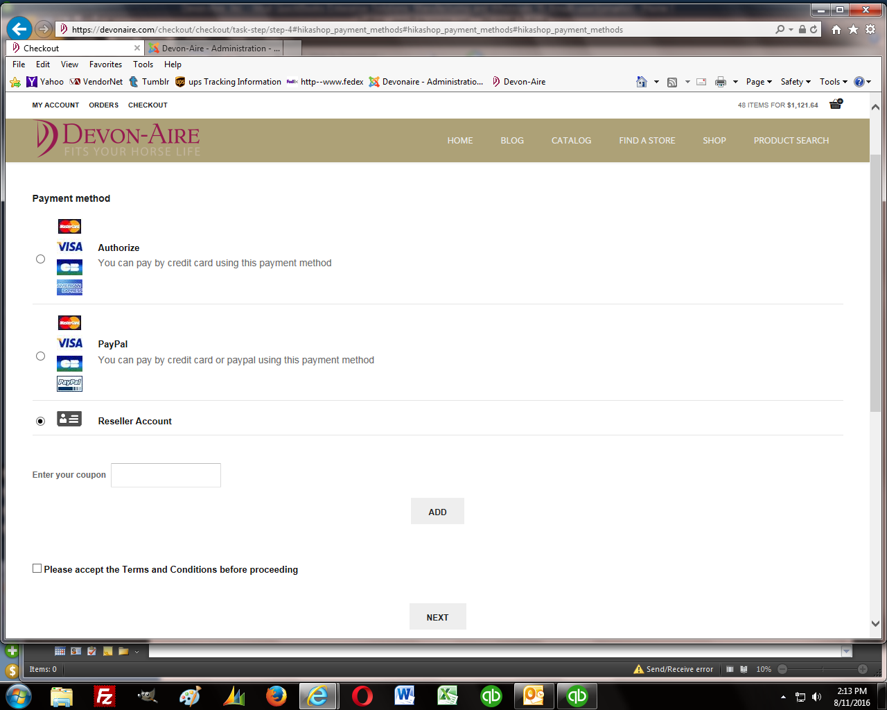

9 years 10 months ago #248941
Is there a way to just remove the Terms and Conditions checkbox option requirement?

9 years 10 months ago #249204
Thank you for your help. Can you please give me a step by step instruction on where to do this?
I looked at the link you showed me but i am still not clear how to remove the checkbox for terms and conditions.
