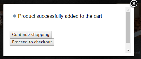

I've been going over the forums and trying different things but I cannot find a way to remove the scroll bar from the "Added to Cart" pop-up window.
Also, where would I edit the buttons so they are not stacked but instead side by side horizontally?
Thanks for your help!!!

The buttons are already left and right by default in the popup. So there must be a problem with the template.
Same with the scrollbar. There is no scrollbar by default.
We would need to look at the CSS of the popup directly on your website to be able to say more precisely what could be done.
Could you provide a link to a product page and configure the popup settings in the HikaShop configuration to stay open a long time so that we can look at that ?

I've also noted that after the pop-up appears, the styles for the mini cart module disappear and it's as if there's no styles for it.

The problem is that you've customized the frontend CSS of HikaShop and created errors in it. Because of that, some of the CSS of HikaShop can't be used by the browser.
For example, you've changed the line:
#hikashop_product_description_main{color:#666}
to:
#hikashop_product_description_main{color:#C9D3DE !important;)
Having a ) instead of a } is not valid anymore and the browsers can't parse properly the file because of that.

Correcting that error fixed the buttons and the mini-cart but the scrollbar is still visible.

That is probably because of the CSS of your template which makes the inner area of the popup bigger than with the template protostar template.
You can try increasing the size of the notice popup with the corresponding setting of the HikaShop configuration.
Otherwise, it might require some CSS code to be added/modified to the template to remove the scrollbar.
