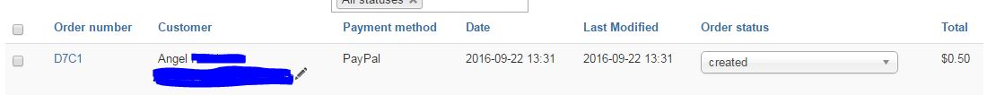

Hello Everyone
On my Hikashop Essential installation I setup a product for testing and enable the Paypal checkout option. Everything seems to be working fine. I was able to pay for the item and after payment I was redirect to my website that shows that payment has been completed. However on my backend server I don't see the order as completed. I confirm that Paypal charge me the correct amount.
Since the order is not confirmed I haven't receive my confirmation email of order completed.
Did I miss to enable any configuration?
