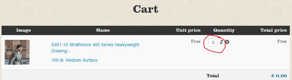

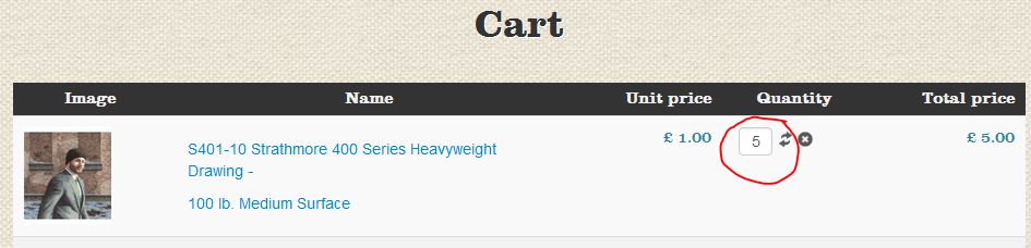

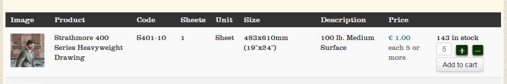

We have implemented a minimum quantity on some products but it appears this is not respected at checkout. If I set a minimum quantity of 5 on an item, and add 5 of that item to the cart, at checkout I can change the item quantity in the cart to a value less than 5. A worse problem is that the price changes from £1 each to FREE - the item isn't free!
EXAMPLE:
Add five of S401-10 a variant of https://www.artistpapers.co.uk/shop/drawing-and-illustration-paper/drawing-paper/strathmore-400-series-heavyweight-drawing
Go to cart to checkout and it's showing five items at the correct price
Change the quantity to 3 (which I shouldn't be able to do ) and price changes to FREE
An urgent solution to this would be appreciated.

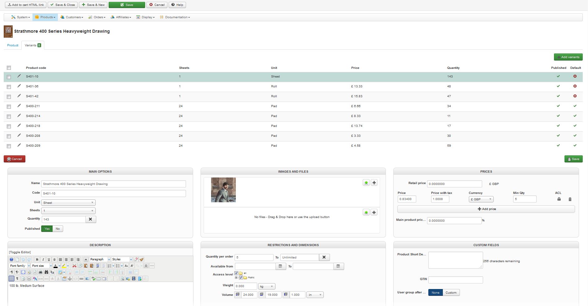

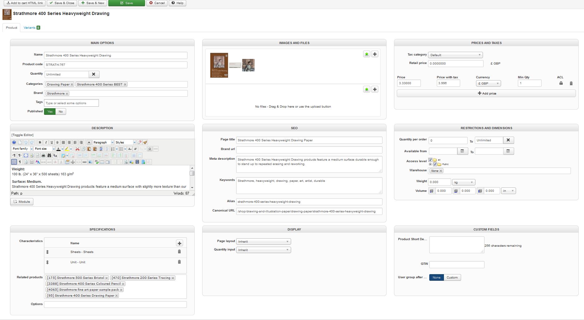

Thank you for the reply.
Attached are screen shots of the parent product and variant settings.
Ian

9 years 11 months ago #250868
I see that you have several variants for the same values in your variants listing.
That should normally not be possible. It must come from a wrongly written CSV import.
Maybe it is linked to that ?
Try with a clean product where you don't have that.
Otherwise, try after changing the code:
$row->product_quantity_layout = $cart->products[$row->cart_product_parent_id]->product_quantity_layout;
						$row->product_min_per_order = $cart->products[$row->cart_product_parent_id]->product_min_per_order;
						$row->product_max_per_order = $cart->products[$row->cart_product_parent_id]->product_max_per_order;
to:
if(empty($row->product_quantity_layout))
					if(empty($row->product_min_per_order))
					if(empty($row->product_max_per_order))
in the file administrator/components/com_hikashop/classes/cart.php

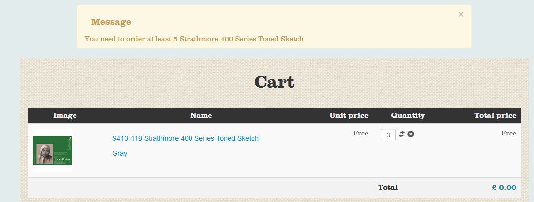

9 years 9 months ago #257597
I had forgotten to implement this but have had the same problem again so I have now made the code changes to cart.php.
It does at least detect the minimum order quantity now but still allows the user to change the quantity below the minimum in the cart. So in the screen shot the minimum order quantity is 5 but the customer is able to change it to 3, and because there isn't a price set for less than five the cart offers it for free.

9 years 9 months ago #257689
I'm certainly looking forward to trying the new version, but it may be a while before that's released ready to put on a live site. Is there any possibility of a fix for this in the current version? The cart does now detect if the quantity is changed below the minimum as it gives the user a warning message, but it still allows the user to proceed with the order, the problem being that they then get the item free as there is no price for quantities below the minimum.
The warning message is fine but I could do with it setting the quantity back to the minimum value again. Can that be done?

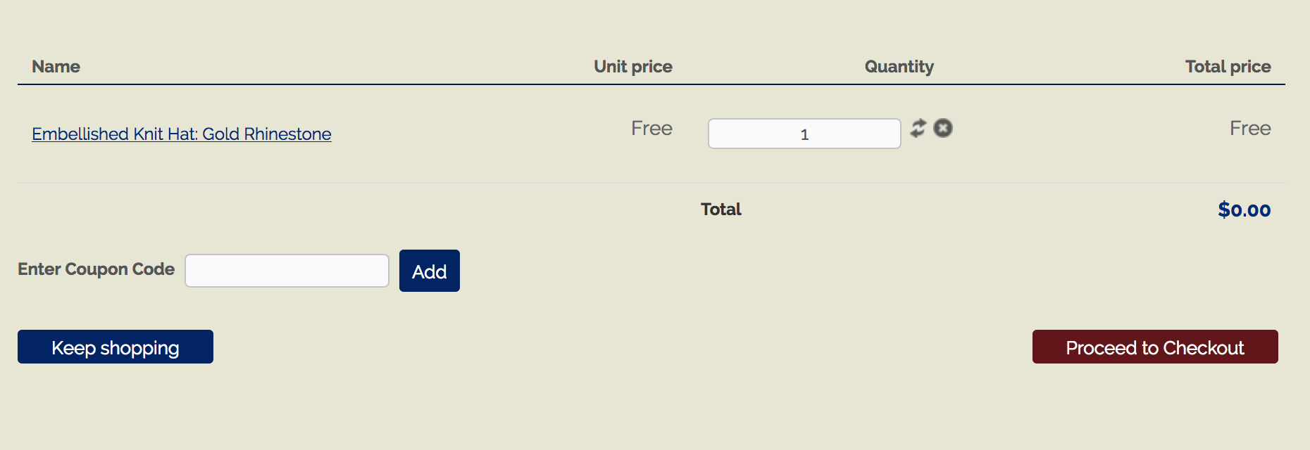

  • Posts: 31
9 years 7 months ago #261020

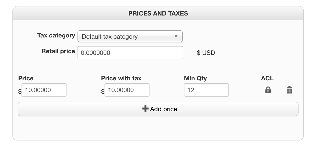

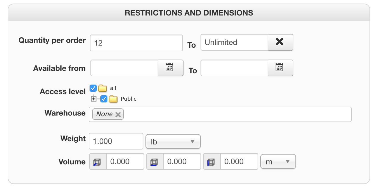

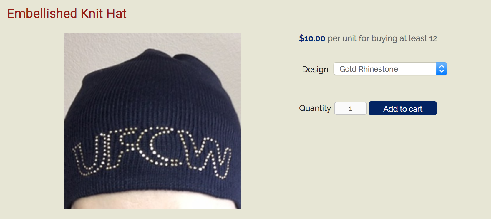

I am experiencing the same issue. I have certain products with minimum quantity requirements. In the example shown in my screenshots, a minimum of 12 items must be purchased. If the user adds 12 to the cart, everything is fine. However, if a quantity less than 12 is added, the price shows "Free."
Product: avofks.com/ufcw-store/international/oute...lished-knit-hat.html
I attempted the code change found in this post, but I do not have that exact code to replace.
www.hikashop.com/support/forum/checkout/...checkout.html#250868
I did make the code change found in this post.
www.hikashop.com/support/forum/checkout/...checkout.html#257724
However, I still have the same problem. This is a live site so I need to resolve the issue quickly.
Please advise.

  • Posts: 26386
  • Thank you received: 4078
9 years 7 months ago #261056
Your problem configuration is not good.
Where did you configure the unit price for quantity between 1 and 11 ?
Where did you configure the product to refuse a quantity below 12 ?
www.hikashop.com/support/documentation/2...orm.html#restriction
If you want to force the user to have 12 unit min ; you must configure the product min per order in that way ; not the price.
  • Posts: 31
9 years 7 months ago #261128
Jerome,
Thank you for the additional information. I have set the product to refuse a quantity below 12. There is no unit price for quantity between 1 and 11 as quantities below 12 are not allowed. Should that be indicated somewhere or does the cart infer that information?
Now, product forces a quantity of 12 before adding to cart - That's great.
However, once the quantity of 12 (or greater) is added to the cart, the amount can be changed. If the user changes the amount to be less than twelve, the following error is displayed:
"Limit reached. You can't add the product: Embellished Knit Hat: Gold Rhinestone"
This message is incorrect as there is no maximum number; it is set to "unlimited." I feel the error should indicate a minimum amount must be purchased. I have already replaced the code as indicated in this post:
Please advise.
  • Posts: 26386
9 years 7 months ago #261175
Yes, if the customer is trying to modify the quantity outside the limits, the product can be removed.
I have an open task for HikaShop 3 in order to improve the system and provide a more logical approach.
So right now if you update to HikaShop 3 (in a test/pre-production website ; it is a major release you should not perform an update in a live site like that) you will still have the issue but I hope to fix it soon.
