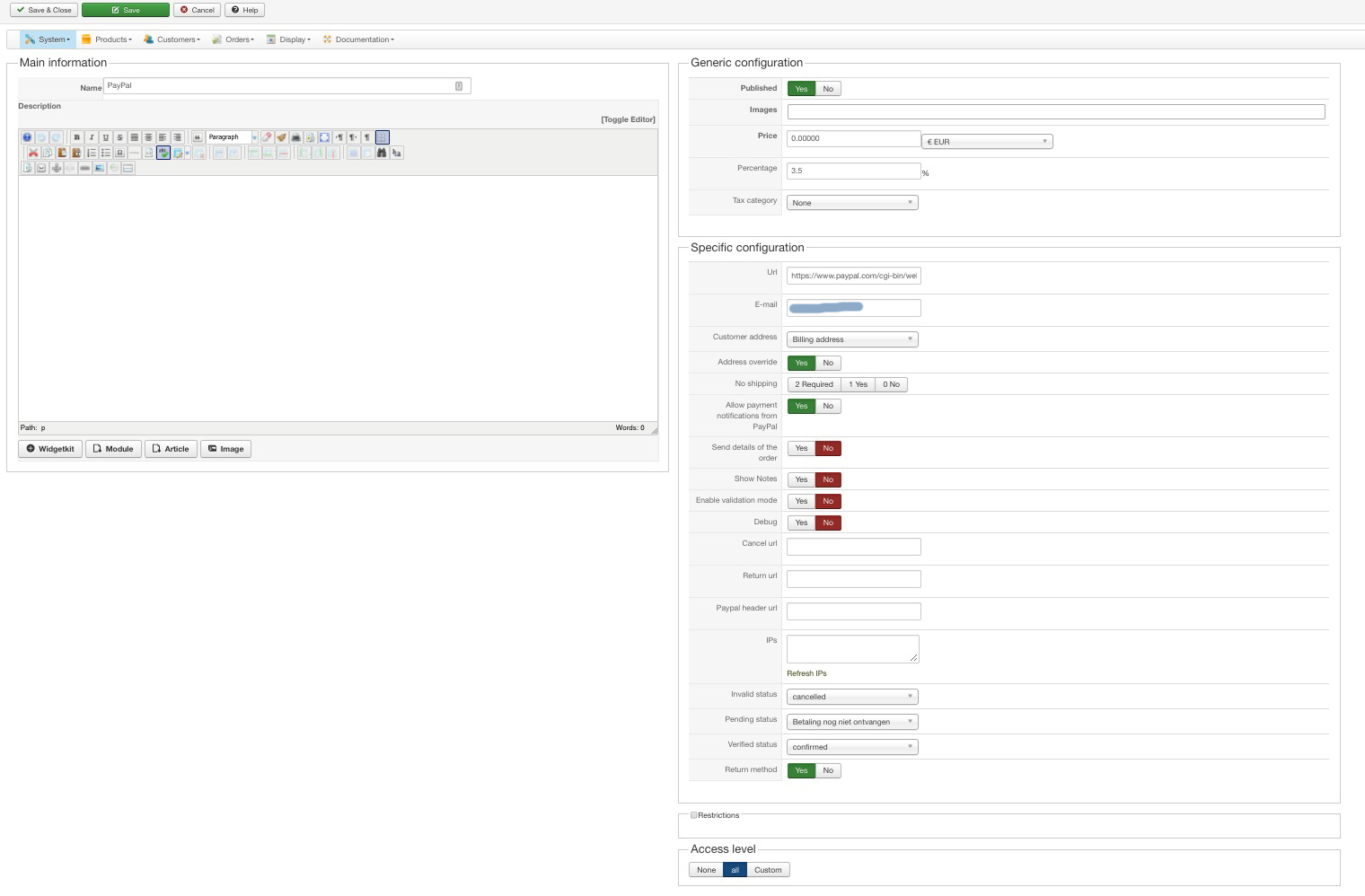

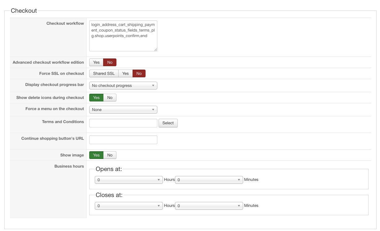

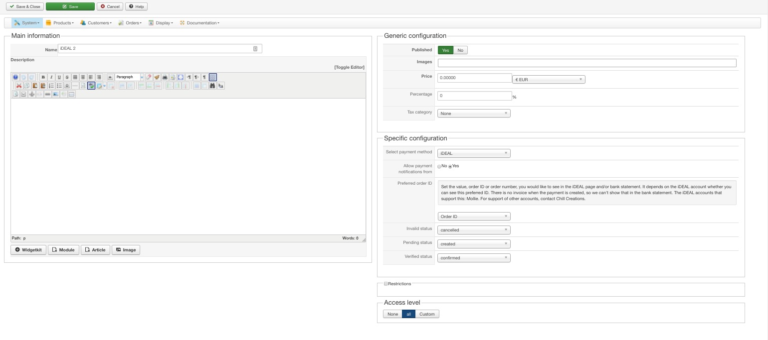

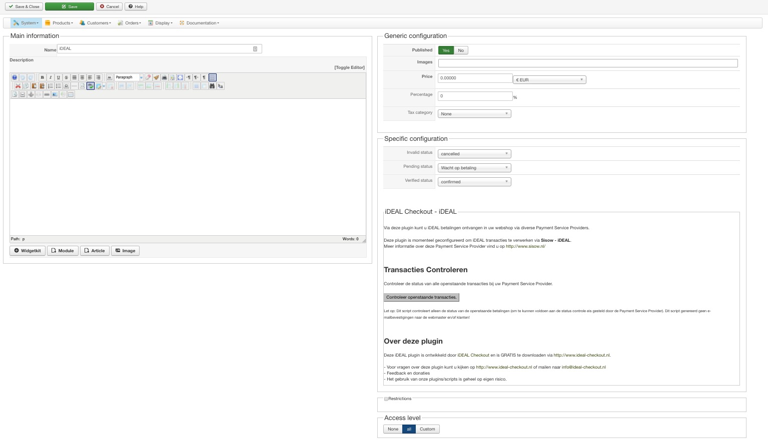

9 years 11 months ago #252033

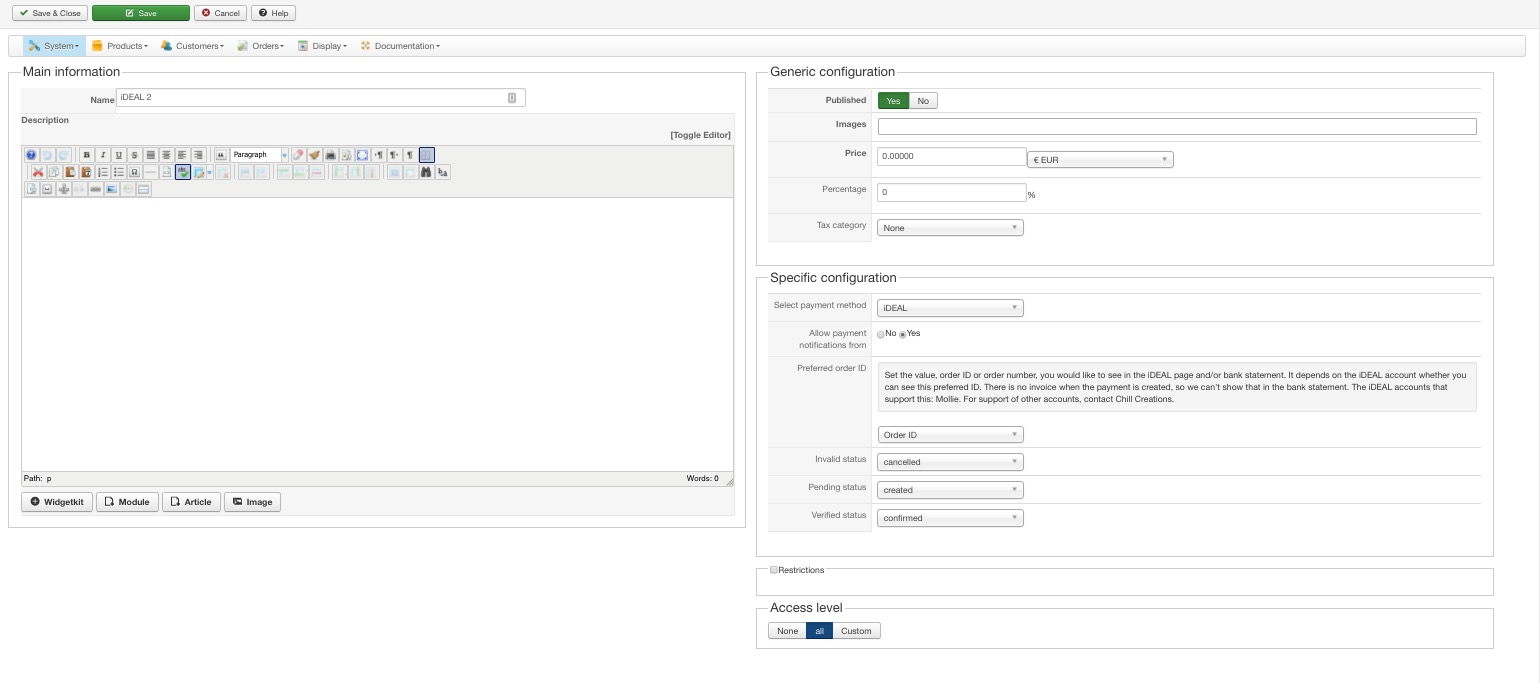

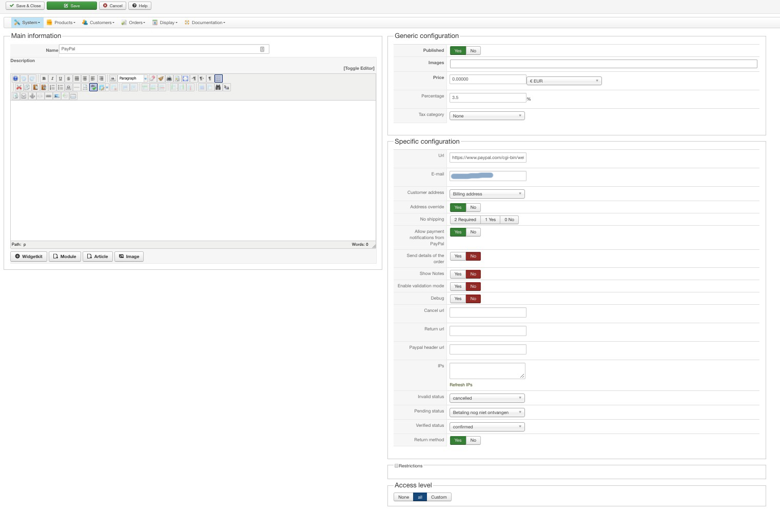

Firstly, can you show me some screenshots of how you configured :
-Your checkout workflow via "Hikashop->System->Configuration->Checkout" by setting the "Advanced checkout workflow edition" option to NO
- Both of your payment methods
Thank you.
  • Posts: 25
9 years 11 months ago #252102
Hello Mohamed,
Hereby the screenshots.
Hope you have the solution.
Thank you!
