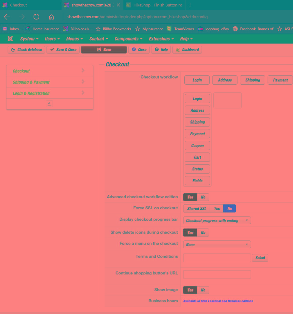

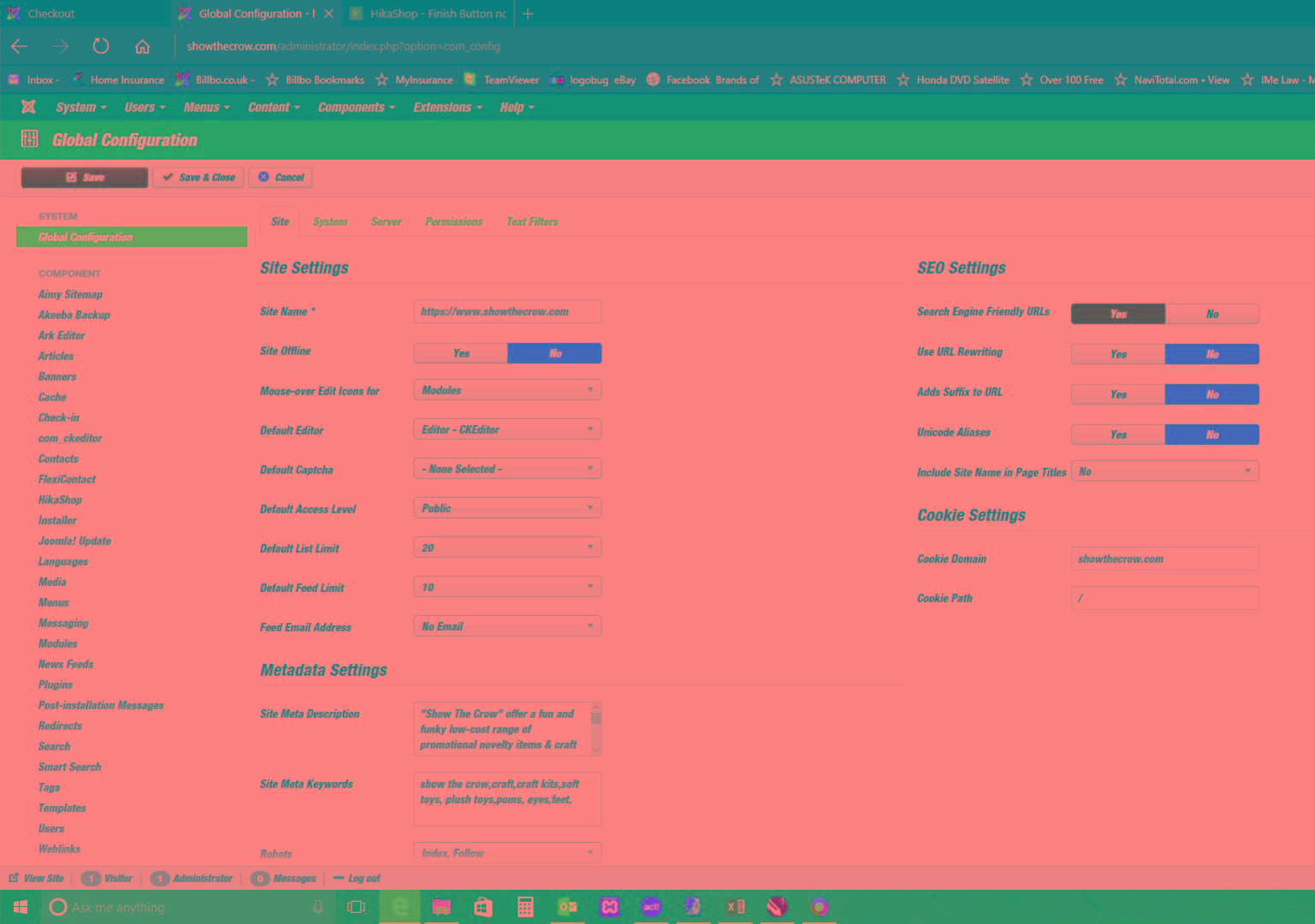

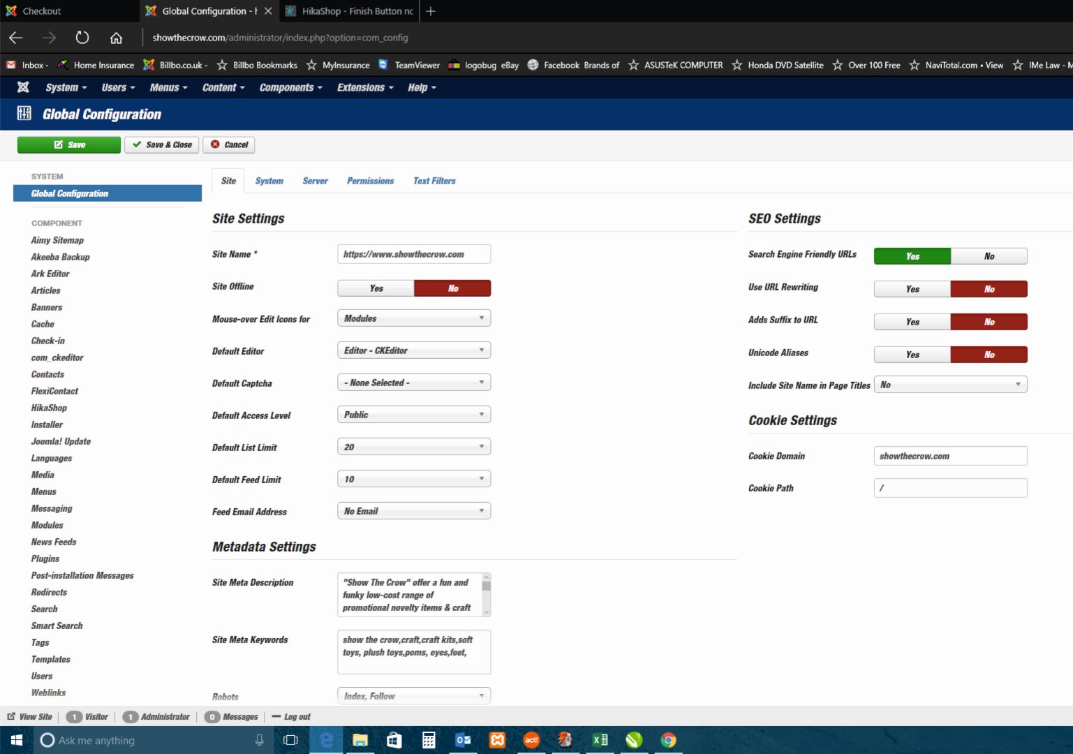

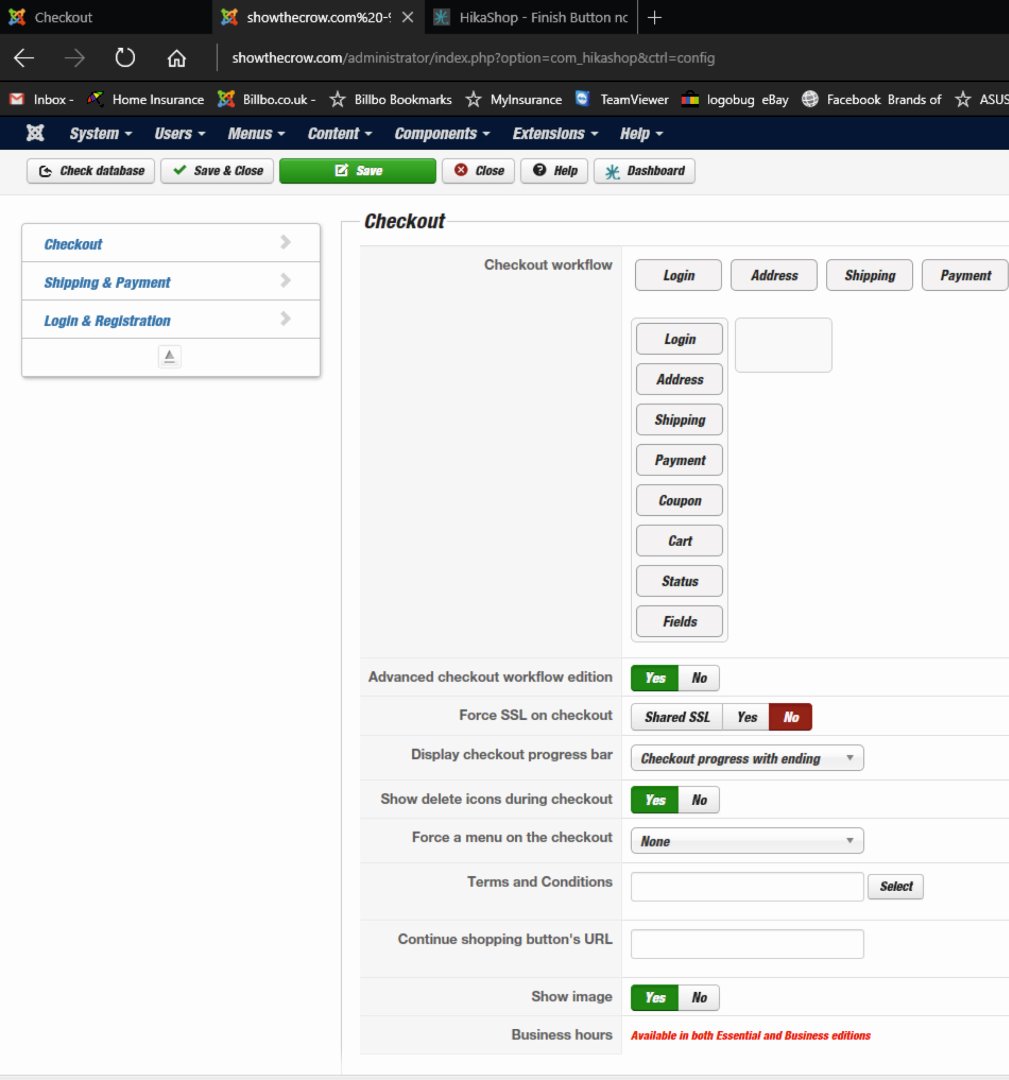

  • Posts: 50
9 years 10 months ago #254653
I have attached 2 screen shots, 1 of the checkout and 1 of the site config.
I have turned off ssl for the checkout and added https in the live site address in the Global Config page.
I have also checked that the ssl certificate itself is ok and that's fine.
After doing all the above I still have problems.
Paul
